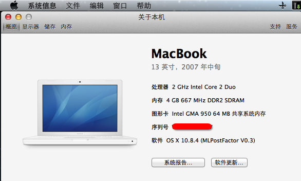

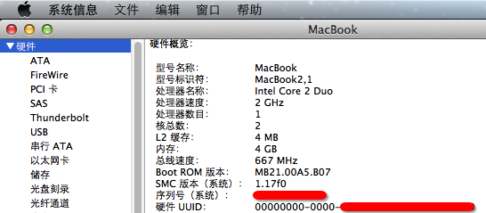

Succeed Thanks Wayne
Dear Wayne:
V0.3 -> 10.8.4 Combo update succeed!
iSight lagging issue is fixed
MacBook2,1 & MacBook4,1
10.7.5 use V0.22 , Install to ML partition (10.8.3)
then 10.8.3 use 10.8.4 Combo Update to 10.8.4
Use USB to Reboot (USB HD is use V0.3 to create Install)
In Install mode , use V0.3 to fix ML partition
All Succeed , Thanks Again

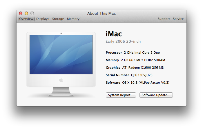

Successfully managed to install ML 10.8.4 on my MacPro1,1 with upgraded Radeon HD 3870. Only problem was the -- already mentioned -- unexpected "success" and hang after install. Ran MLPF after that and managed to boot ML. Cool. 🙂
What I experienced was that the UI is very slow. Safari lags (not flickering) as hell, opening a finder window reminds me at my old PowerBook G4 -- performance-wise. Seems that ML is somehow using some kind of "generic SVGA/XVGA driver", not HW acceleration. A single web page in Safari made the whole Mac completely unresponsive.

Also, I successfully got Mountain Lion running on a first generation Intel iMac! I had to replace the Core Duo processor with an Intel T7200 Core 2 Duo, though.
