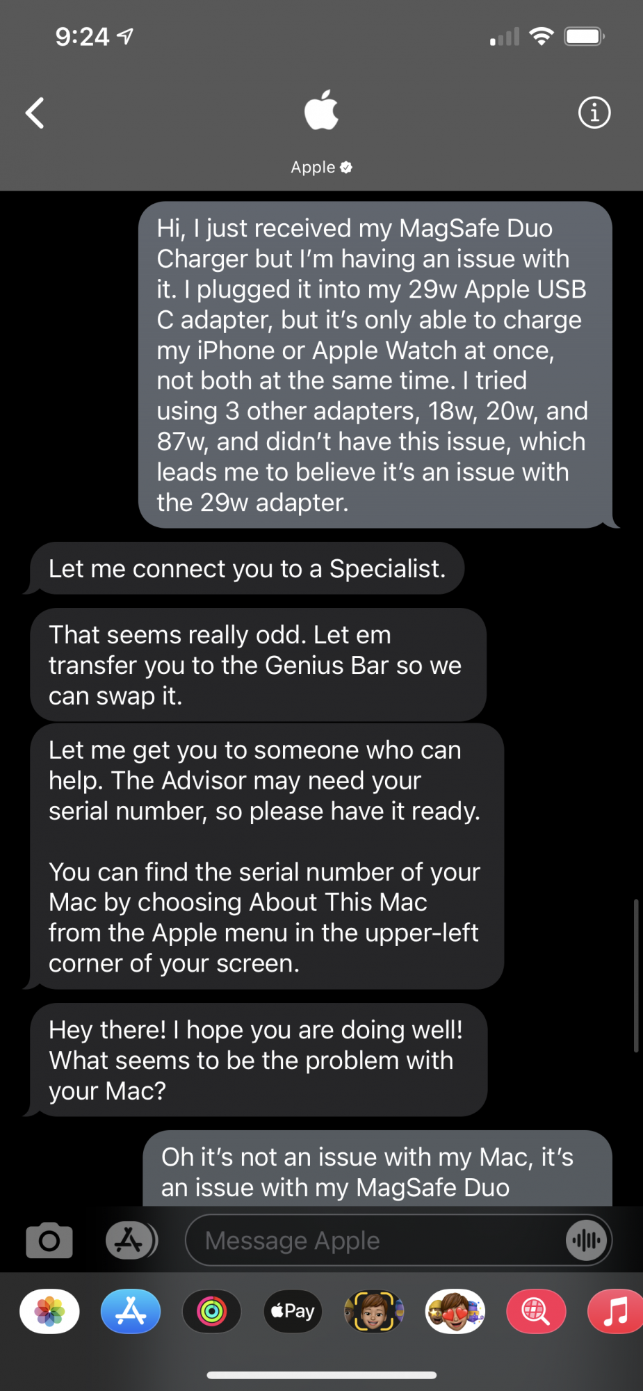

I'm texting apple support right now about it. I don't know if it's an issue with the adapter or charger itself, but I'll see what they say.

I am chatting with them now also....lol.
Not off to a good start. I said I'm having an issue with my MagSafe Duo and they sent me to a Mac specialist...

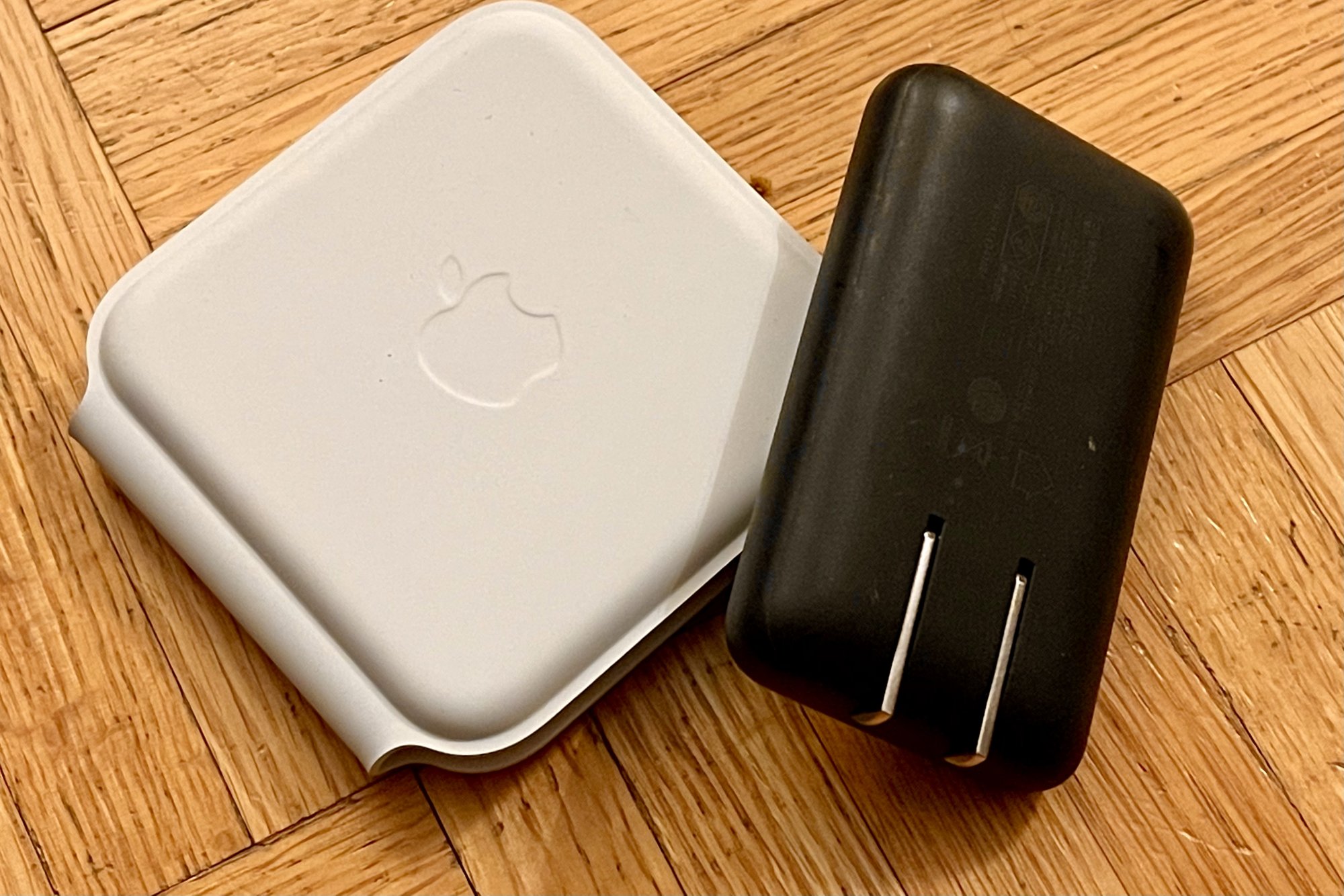

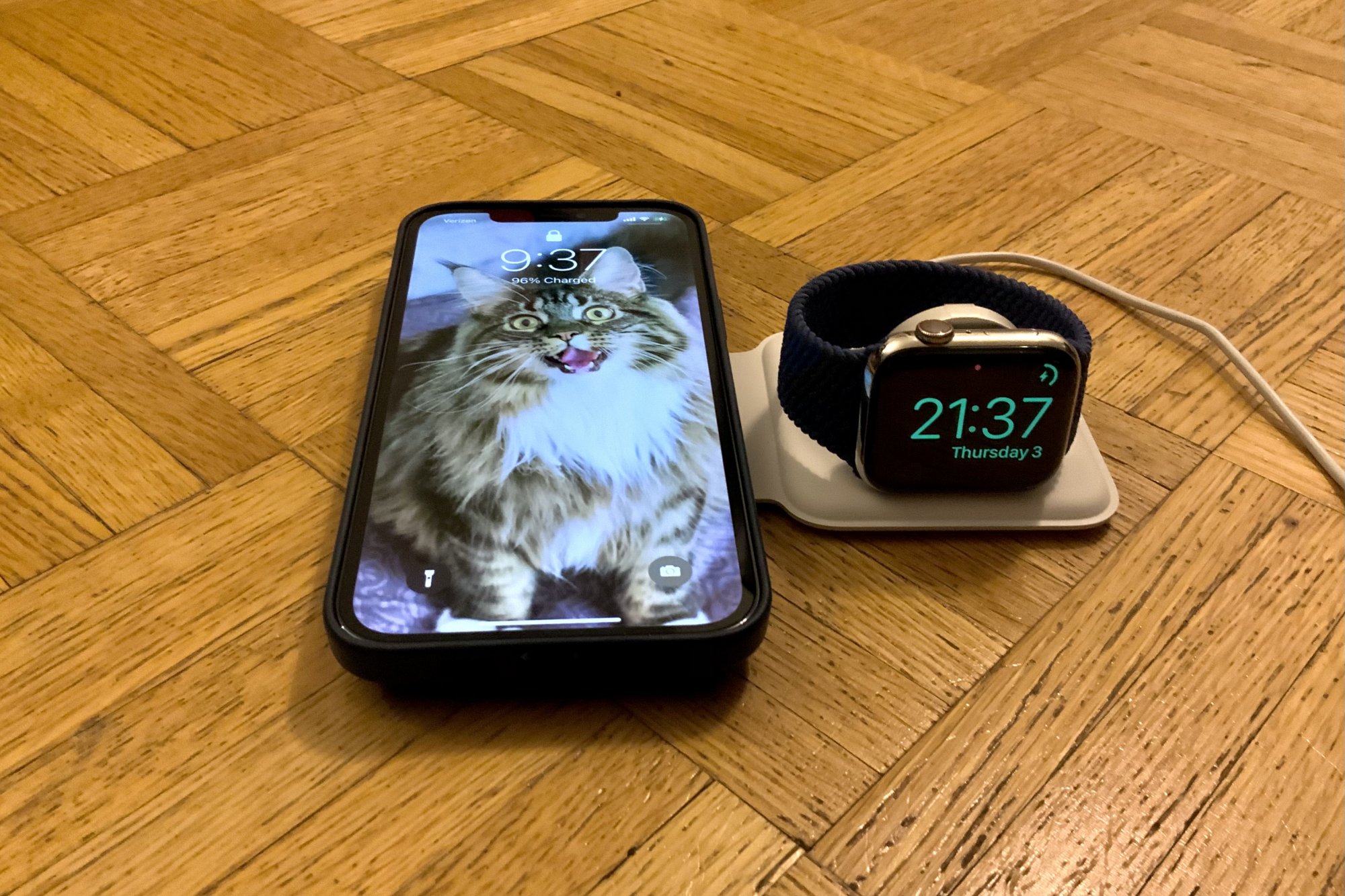

The MagSafe Duo is made from a white material with a book-style design. One half has a MagSafe charger that attaches magnetically to iPhone 12 models, while the other half has an Apple Watch charging puck. The Apple Watch charging puck can be used flat or it can pop up so you can charge the Apple Watch in Nightstand mode, but the MagSafe charger remains flat. The design is simple and clean, and it folds over neatly, something that will be great for future travel.
On the surface, the MagSafe Duo looks like a decent charging option, but at its price point, there are compromises to be aware of. It does not ship with a power adapter so you need to purchase one or use one that you already own, and there are charging limitations.
The MagSafe Charger on its own can charge an iPhone 12 at up to 15W with Apple's 20W USB-C charger, but if you use that same 20W USB-C charger with the MagSafe Duo, an iPhone 12 will be limited to a maximum of 11W. You can use a 27W+ charger instead and it will charge at up to 14W, but it is not able to hit that 15W maximum. Apple's 20W USB-C Power Adapter costs $19, and the 30W version is $49, so adding on a charger raises the cost of the MagSafe Duo quite a bit.
