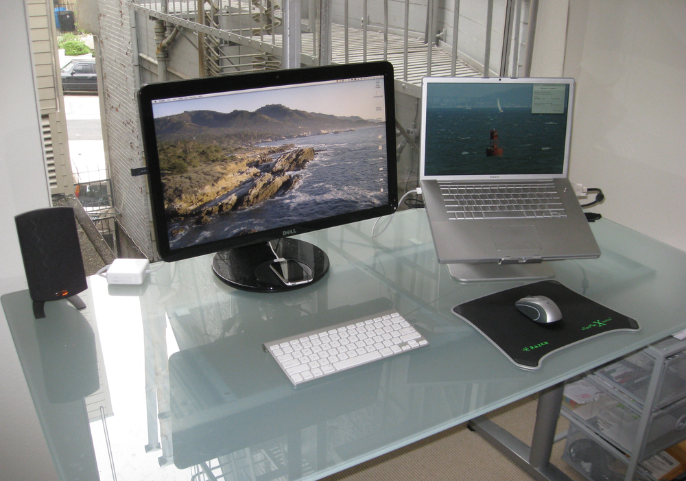

I said i would post pics, and I just attached this pic to a different thread, but for those still looking, here is the monitor / my setup.
