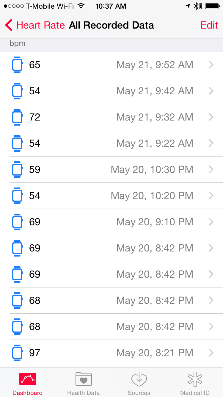

As you can all hopefully see, getting a little bit of everything in here. Seems to have a mind of its own now.
