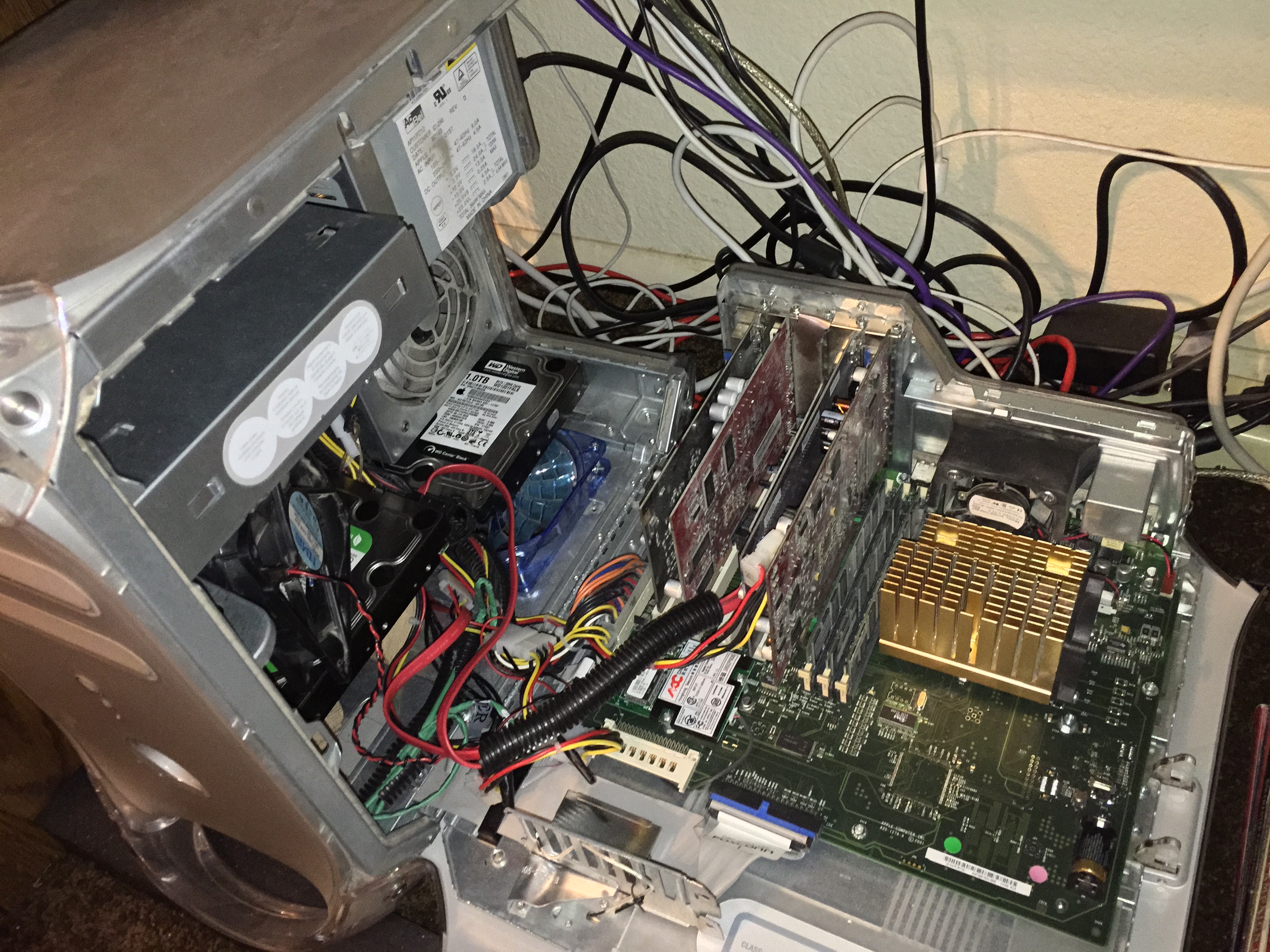

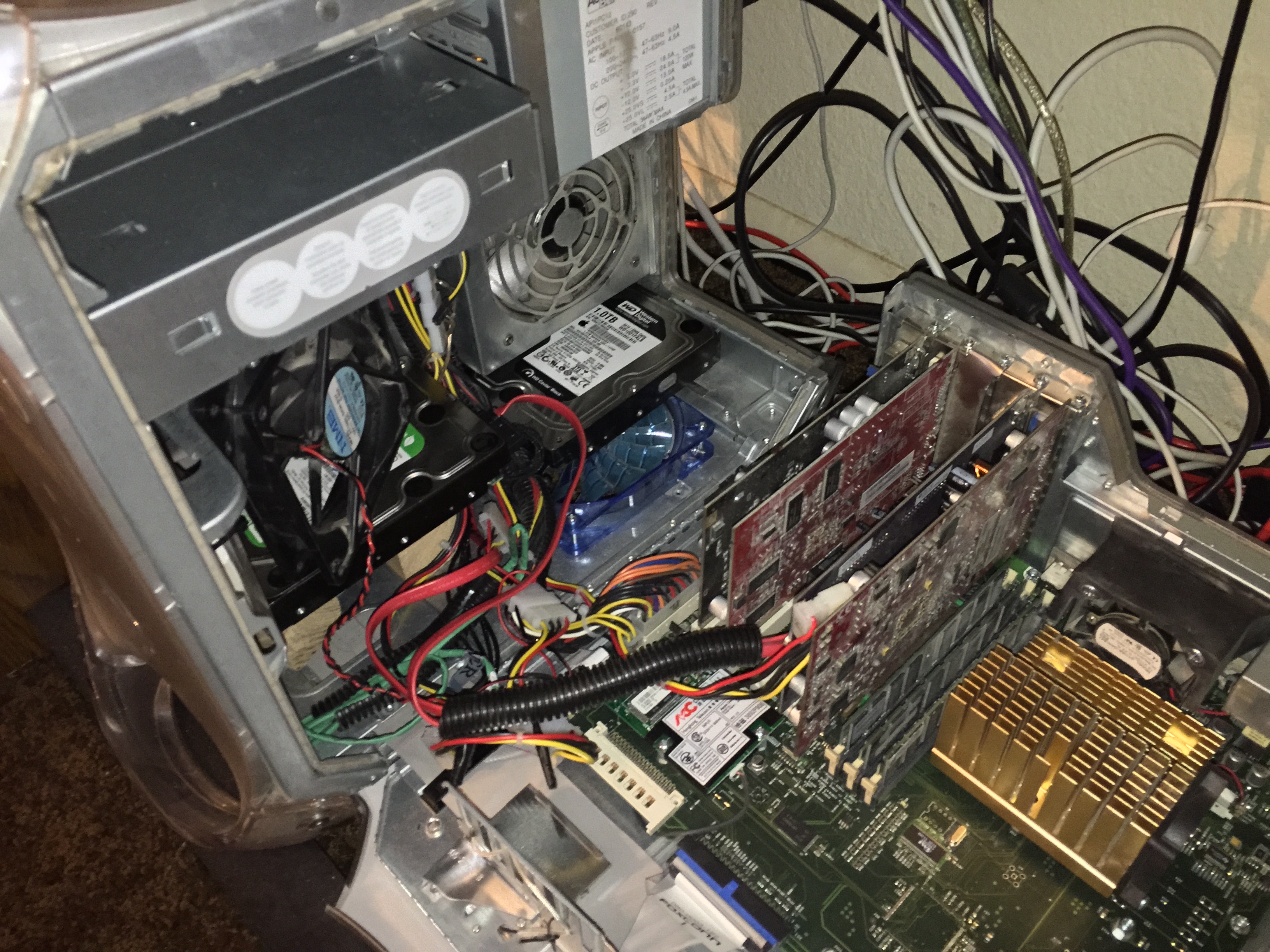

OK. I had to open my case today to resolve some other issue so I took the opportunity to take two pictures of the final configuration.
So here it is…
