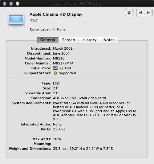

Once I get the converters I can run 5 displays. What I WANT, is 5 20" Hi-Def Cinema Displays (the acrylic ones).
I don't believe the 20 inch had a HD version. The ones I've seen are 1680x1050. The acrylic HD monitor I have is 1920x1200.
I also have a 23 inch acrylic rated at 1600x1024. I really really really wish I could trade this for a 1920x1200 version.
Yeah, you're right. I meant the 23" version. And given the setup I have now, when I finally achieve my dream it will be six. :D

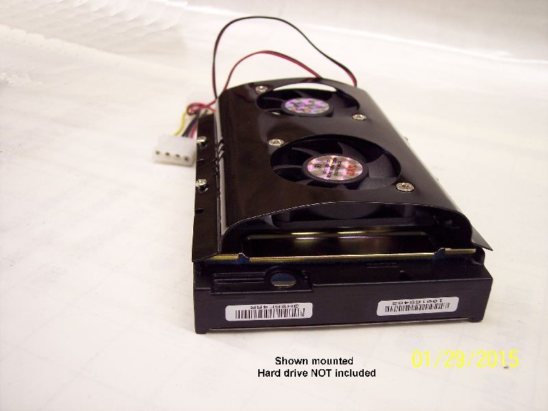

So, heat is still an issue, even with the 120mm fan I put in the bottom. That fan has reduced heat by about 10º but my drives are still hitting temps around 109-111º.
So, I went and got some HD coolers. Now I'm topping out at 106º for the boot drive and 100º for the secondary drive.
Here's what I bought: http://www.ebay.com/itm/271758534343?_trksid=p2057872.m2749.l2649&ssPageName=STRK:MEBIDX:IT
$5. They work good enough, but I will probably replace them with better one's at some point.

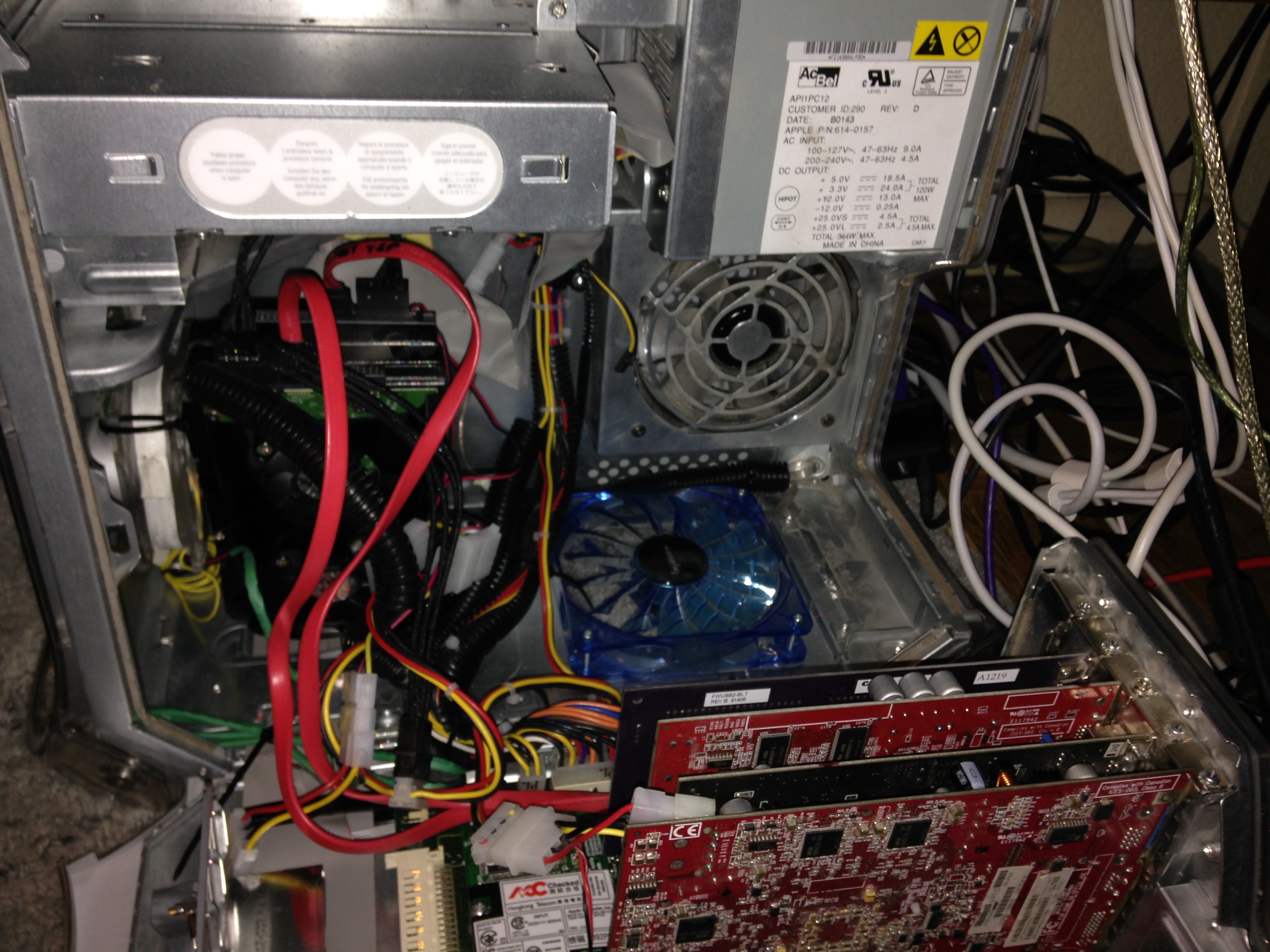

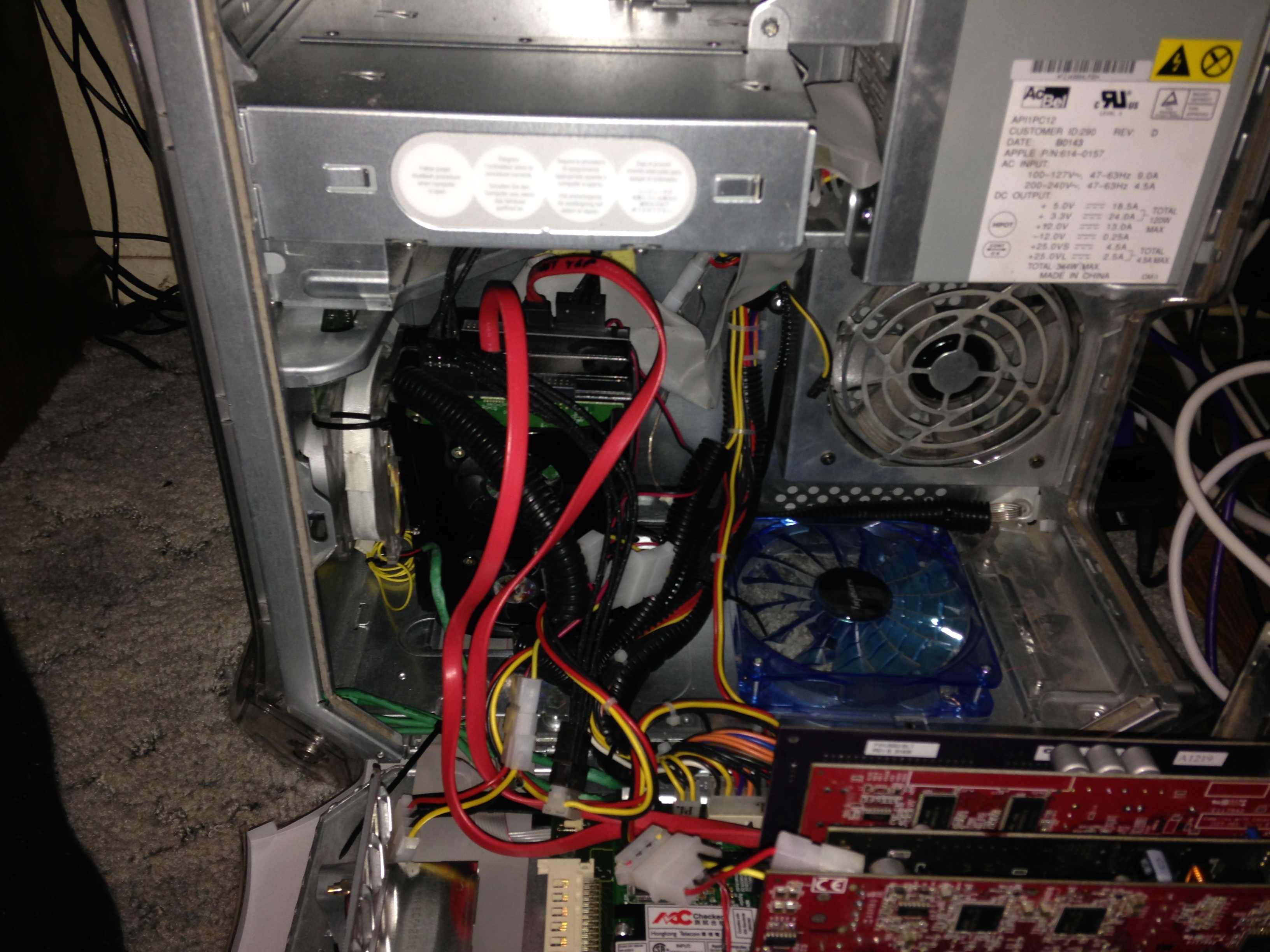

So, got another wild hair today and decided to do some more modifications.
Removed the front speaker (I have Apple Pro speakers, thanks RedCroissant) and hooked up a 80mm fan to draw air into the case across the hard drives (effectively blowing the heat from the HD coolers back towards the main case fans). It's got a blue led so chose that one specifically because of that.
Had to modify the cage that's designed to hold really long PCI cards and the airport card – with a hacksaw. It was running right into the fan.
So far I like it.
Edit: Woo HOO!! That brought me down about 8 degrees!!!

Think I may have finally cracked this.
For whatever reason I have been under the impression that sticking my main drive right on top of that big fan I stuck in the bottom would prevent the door from closing because the last PCI card would not clear the space.
I think also I just didn't want to block airflow with a hard drive.
Well, I futzed with things again and the final time I just decided "the hell with it" and dropped my main drive right on top of the fan with the secondary behind it.
Very interesting I think. The main drive is solid at 106º and the secondary (a WD Green drive is 100º). Neither have moved even under load!
This is more than acceptable to me considering the wild fluctuations of temps I've had since I started this thread. I think 106º is damn good and about the best I can expect from a WD Black drive.
The kicker is that now the main case fan seems to be pumping out far more heat than it was before.
So, my guess here is that essentially I've created a built-in drive cooler for the main drive and by virtual of blocking airflow above the fan (because the drive is sitting on top of it) I've managed to restore proper exhaust flow through the regular case fan.
If this is the case and temps hold and are consistent then my grand experiment (this Quicksilver was always intended to be my test pancake) is complete and I have achieved the absolute best cooling I possibly can without resorting to liquid cooling.
Well, the second hard drive climbed to 102º so I made one small adjustment. And now I have at the top range 108º on the main drive and 100º on the secondary.
With the screens off that drops to 102º and 95º respectively.
So…I'm calling this solved - finally!
