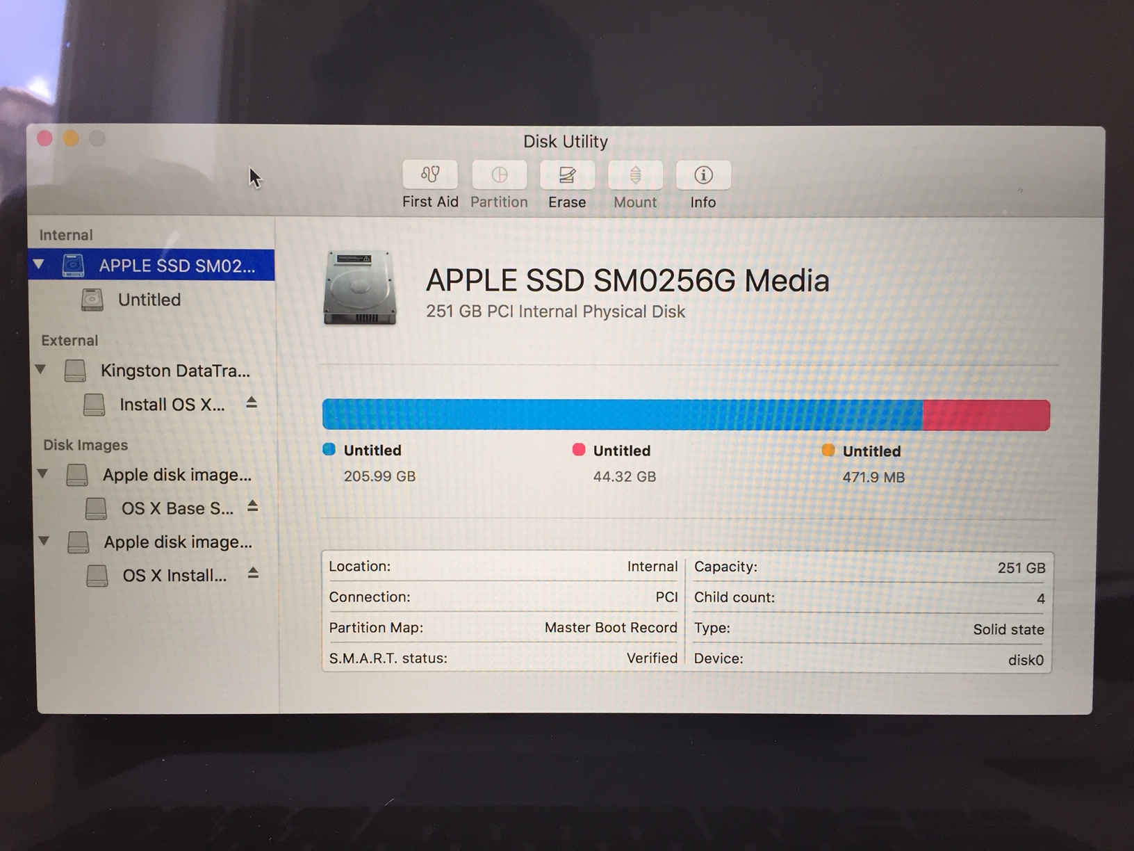

When i boot and press "Alt" only shows OS X, but when i select it, the screen goes black and nothing happens, not even Apple logo (tried to boot on Safe Mode, reset PRAM, and nothing fixed that).
I booted with a OS X install USB and opened Disk Utility, and now instead of two partitions with Macintosh HD and BOOTCAMP it only shows "Untitled".
Here are a few screenshots:
You may have a failed drive that caused this. At any rate, what you have now is your internal drive formatted completely in NTFS for Windows. In that top screenshot go to the erase tab and format the internal to Mac OS Extended (Journaled) then reinstall OS X. This will of course erase everything on the drive, so hopefully you have backups.
That "Untitled" partition that shows on the first screenshot has only 500mb, it belongs to windows.

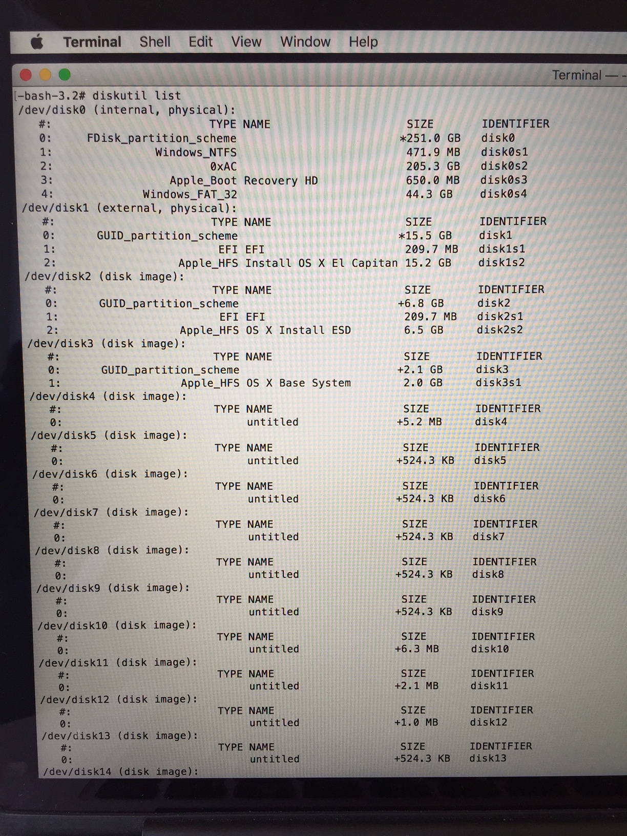

If you check the terminal log on the second image, on the 6th row it lists 0xAC --- 205.3 GB disk0s2, that was suppose to be the Macintosh HD.
I just don't get how could the "Statup Repair" from Windows 10 installation disk format the partition to NTFS. Don't believe that's what happened.

Anyhow, it seems to me Windows rewrote/overwrote your GPT (GUID Partion Table).😵 The GPT is like a map of your HD that the computer uses to find stuff on your HD. Back in Classic MacOS days, I would have ran Norton Disk Doctor. Dunno of there are any commercial programs to fix a GPT these days. If not, your only real option is spending mucho dineros (a few K's) for data recovery service.
Believe it, because that's exactly what happened. Weaselboy is correct. Never use a Windows install disk to repair Windows when you're dual booting with OS X. Next time make a backup of your Windows partition using WinClone and your OS X installation using CCC or SuperDuper. Follow the advice given by Weaselboy and start over... 🙁
