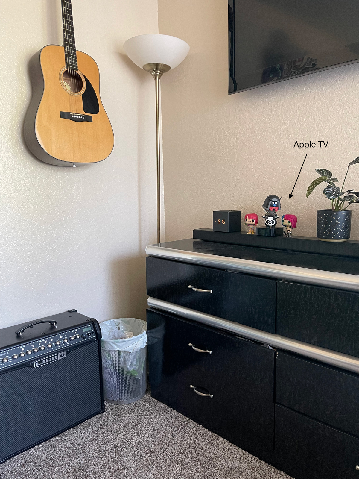

Has anyone ever encountered connectivity issues with their Apple TV and Wi-Fi when the router is placed in an adjacent room?
I live in a 1BR apartment and my Apple TV HD (4th Generation) losses connection constantly in my bedroom — Netflix will get extremely pixellated, while other streaming such as Disney+ or HBOMAX will just pause to buffer. My router is in the living room, which is the next room over, and a separate Apple TV 4K in the living room functions perfectly.
I'm assuming the router and internet is functioning correctly — I have no problems with any other devices. The Apple TV itself says it's connected to the Wi-Fi with 5/5 dots (bars). I also ran a speedtest with my MacBook Pro after placing it right next to the problematic Apple TV and it scored a Download: 228.85 Mbps and an Upload: 10.59 Mbps.
Is there anything I should look for or do before I try resetting all the data in that Apple TV?
Here is a photo and quick video of my setup to see if it helps:
And here is a video so you can see the distance between router and Apple TV:
Thank you!

@ohernan6
You might try re-locating the WiFi AP/Router. You currently have it on the floor next to a sliding glass door. The glass bookcase and table don't help either. Nor do the plastic figurines on top of the ATV. You also placed the ATV on top of what appears to be a sound bar. Pulsing magnetic fields from speakers might interfere with the ATV
1. Hard reflective surfaces create WiFi multi-path interference patterns and time of arrival issues.
2. Elevate the WiFi AP/Router off the floor. Height is your friend in this case.
3. Try to locate centrally in your apartment away from hard reflective surfaces, but keep away from other 2.4GHZ appliances (microwave, cordless handsets, other bluetooth devices, etc.)
4. Download a WiFi scanning tool to see how much congestion exists. If your WiFi AP/Router is constantly channel switching, clients may have trouble staying connected. You could try to fix the WiFi AP/Router channel vs letting it auto select.
If that doesn't solve the problem, then a pair of Ethernet over Power adapters will allow the ATV to connect via wired Ethernet
