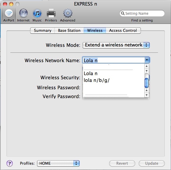

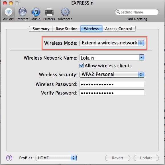

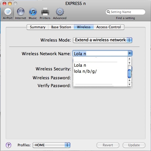

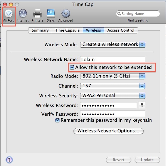

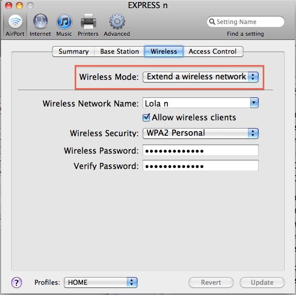

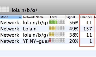

If I understand you correctly, you have a DUAL-BAND wireless network - one set at 5GHZ and the other at 2.4 GHZ? I have that set up at home. The 2 different bands, as you say, need to each have their own distinctive names. This way, when you configure the Airport Express to extend the range of ONLY the 5GHZ network, you would select only that faster one. Here is my setup choices with my 2 networks:
You can see that I have the choice of extending either my "N" network, called "Lola n" (5GHZ) or my "n/b/g" (2.4 GHZ), called "Lola n/b/g". You would than place your Express, hard-wired, into whichever part of the house to which you need to extend the range.
For the initial setup, you might first need to connect it via ethernet directly to the Airport Extreme. However, because you have the base stations hard-wired together, you will instead, set up a "Roaming Network". (The option to "extend" the network is only available via a wireless configuration.)
Your Airport Extreme should be set to "share a public IP address", while the Express should be set to "Bridge" mode. Each device will have the identical NETWORK name (the 5GHZ band) and PASSWORD, but give each unit it's own unique name -see in my pics above - "Time Cap" and "Express n".

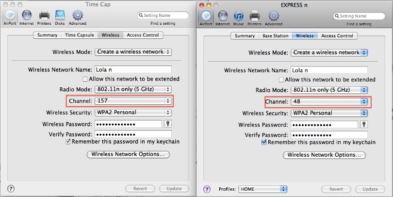

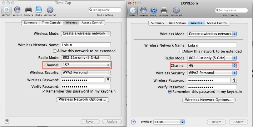

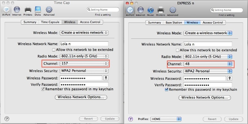

Okay, I figured it out. Obviously since extending the network and WDS are the same thing basically, I started to do some other digging and finally came across the KB on Apple's website that explains it (very short and sweet) and I guess I didn't realize that creating a roaming network on apple devices is basically the same as any other type of network. The link to the KB is below and also, holding the Option key while clicking on the wireless mode while configuring these devices opens up a whole other world of options and actually allowed me to do exactly what I wanted with it. I now have my Express serving as another AP, and as a 5Ghz N-Only AP. All is well now and it works exactly how I need it to. Thank you again.
http://support.apple.com/kb/HT4260

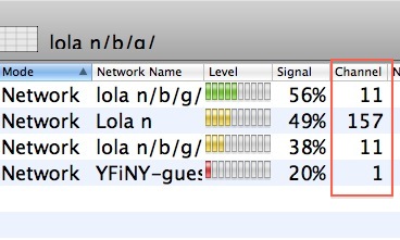

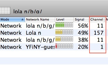

Unfortunately, if your network is set to the 2.4GHz radio mode, there will be interference from phones, microwaves, etc. Also, the same could be said for a neighbor's network, if their channel is close to the one your device is selecting.
You do not specify whether your network is 802.11n or (n)b/g. If it is the first, I would suggest setting it to 5.0GHz. Another option is to download a utility called "iStumbler" that will show what channels surrounding networks are using, then you would set yours to a different one, as far apart as possible. For example, here is a screenshot of iStumbler illustrating this. (Unfortunately this will not display interference you are experiencing from household devices/appliances):

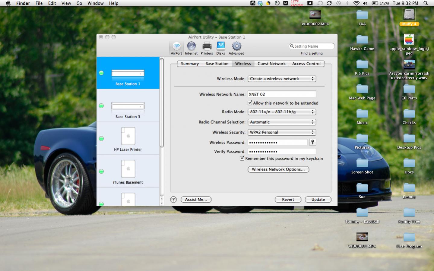

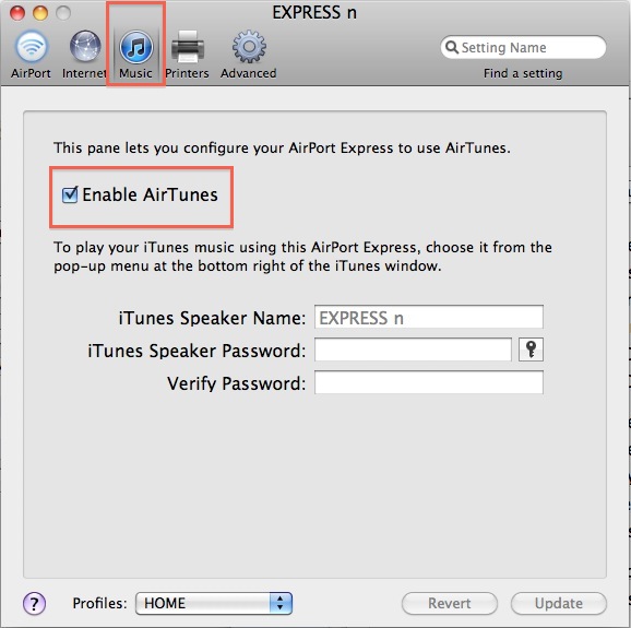

Thanks for the fast response. I have an Airport express for two stereo units to play iTunes, one for Playstation, one for a USB printer, one for the Plasma TV. All except one of my express units are N. The older G one is hooked to the USB printer. I did not see a 5.0 GHz only selection available and here is a screen shot of my setup.

Hold the Option Key while you click the drop down arrow, you will see all kinds of options.
Thanks for the reminder. I read that in one of your posts but got caught up with other issues. It appears my setup is a little wackco and that would explain some of the problems I've had with consistency. Right now I've got five airport express units on wireless and as laurenr mentioned my network is very slow. Just reading this thread has helped me understand that I should be hardwiring some of those express units. Thanks to you, laurenr and others for all the great info. I'm still wondering about if I should choose a channel on the base station and select automatic for the express units or make everything automatic. Thanks agian for the help.
No problem. As far as hard wiring some of the express units... you should hard wire all of them. Of course, you can only do so if possible... but the goal would most definitely be to have multiple AP's broadcasting your wireless and then communicating back to the Extreme or whatever the DHCP server is, and going about it that way. If not, you are killing your bandwidth and exponentially cutting it down by adding even one AP that extends it on the wireless backbone. Do whatever you can to get as many of those as possible wired up and that will help a great deal. I'm surprised that you haven't noticed a huge wireless speed loss due to having that many AP's as wireless extenders already.
