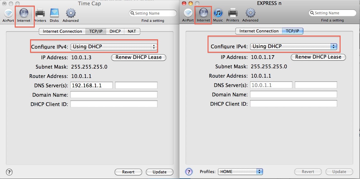

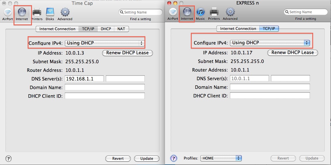

Hi, I did check that (honest!) but it did not give any workable solution? It suggested to allow the device to distribute DHCP which on a roaming network is not correct?
Have I missed something?😕
My setup:
Sorry, I had posted wrong pic.🙄
That's ok 😛 but I already changed it to DHCP as your pic.
In the house it sets ok & gets the correct IP but in the garage goes back to the 194 range.

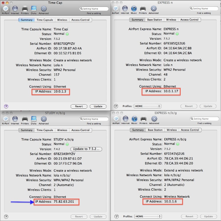

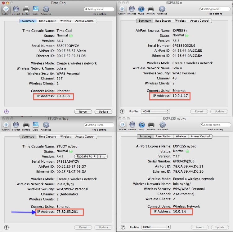

Funny thing, I have two Airport Extremes, two Airport Express units. Airport Utility sees all of them and my devices can connect to each one. BUT, one unit has an entirely different range in its IP Address. See where I point with the blue arrow; it is the only one displaying 75.XXX.... instead of the 10.1.XX like the other three:
(Please note, that in my Dual Band Network setup, one of the AE units is extended wirelessly (Exp n/b/g), the other via a Roaming setup(Exp n), but this should not apply to your setup. I just point this out in case you noticed the discrepancy between mine and yours.)

Wow! That is really weird...will require some sleuthing I think. I'm thinking now that you could have a PPPoE problem lurking in the background, that is if your internet is via DSL.
I know about the update, but I had actually just downgraded the firmware on my base station. I had recently changed over from DSL to Cable, and for some reason that base station would not play nicely when on version 7.5.2🙄
the self assigned IP is because it cannot get an address, which is really weird as we know the cable gives an IP address when its plugged into the laptop?
So its just the AE not getting the address, so this is really strange...

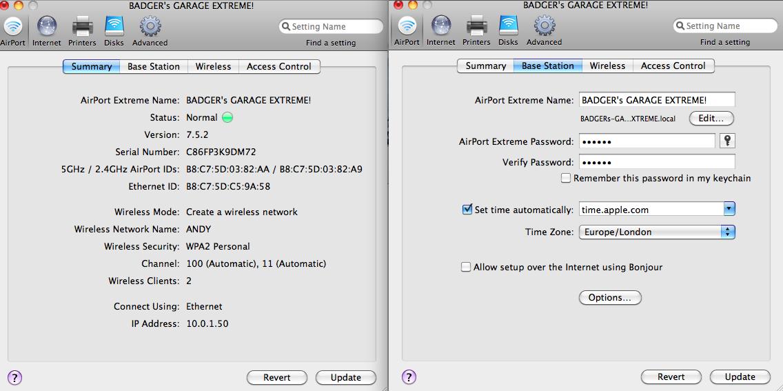

Ok, I'm actually in the garage typing this, connected via an ethernet cable into the AEBS which is connected via the Solwise Powerline.
This proves that the powerline is giving the signal at least.
I set up a different wireless network to see if that would give us any answers, my iPhone could see the new network (as could my laptop) but after joining neither could get an internet connection.😕

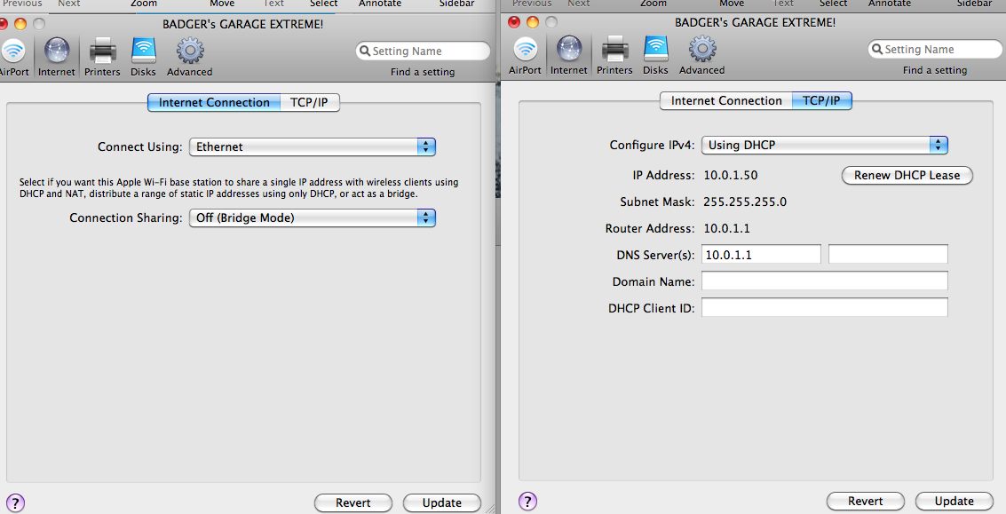

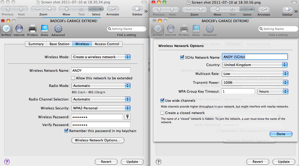

I will attach the AEBS settings to see if I have missed anything but I think the problem has to be in the powerline, no?😕
note; the channels are on automatic at the moment (I have had these on manual also) as it took the 5ghz up to 100 (which I do not get the choice of even with the option key held down).

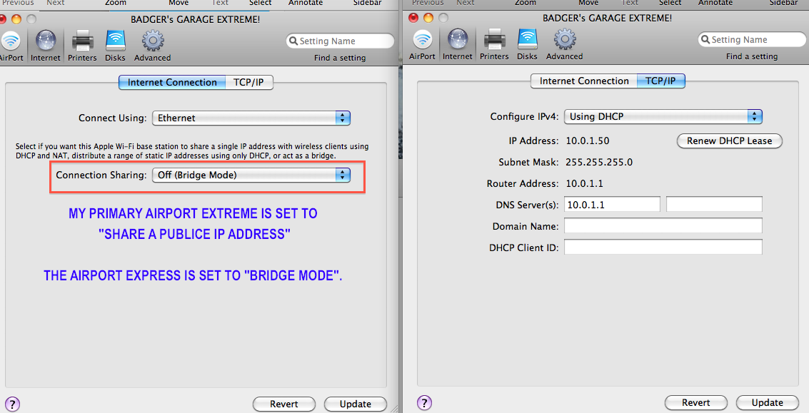

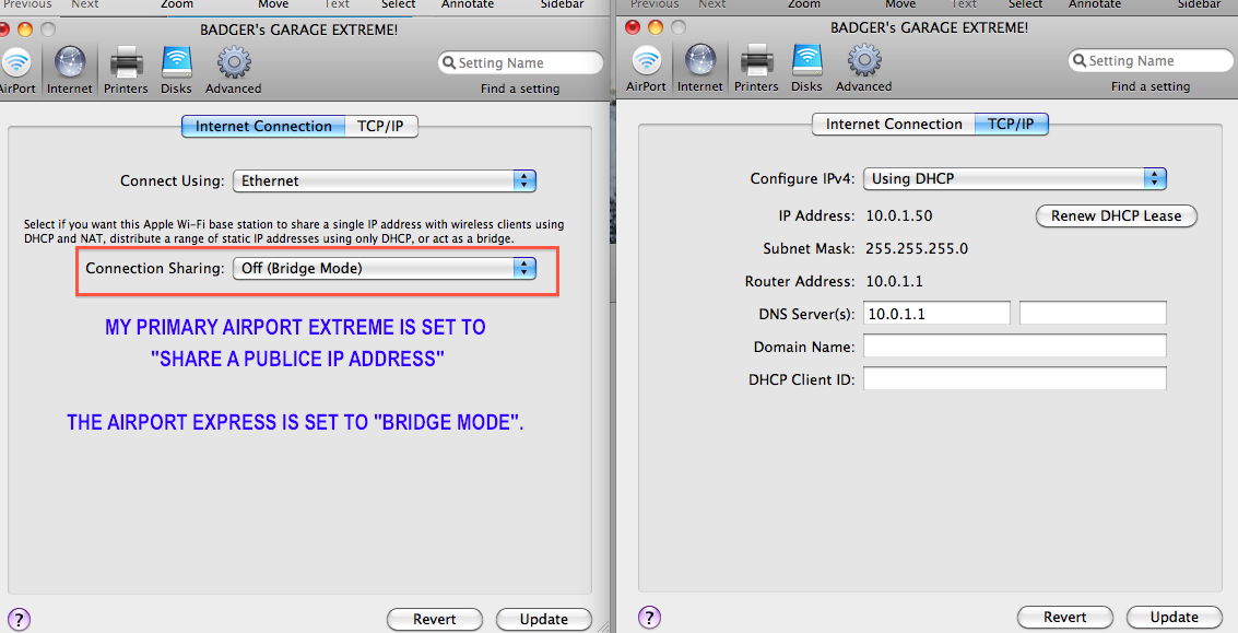

Just checking in for a minute (busy packing). I looked at your setup. The only anomaly I see is that your Airport Extreme (the one connected to Modem), is set to BRIDGE mode.
My primary airport extreme is set to
"share a publice IP address". (This is the device connected directly to the modem).
The airport express is set to "bridge mode".
Look at the pics in post # 55 of this thread to verify my settings against yours.
Edit I made to your pic:
Edit: There is one little thing that concerns me, not sure if it is still relevant. You have "Use wide channels" checked. See discussions I found here that specifically refers to the UK setup:
https://discussions.apple.com/message/5779543#5779543
https://discussions.apple.com/message/8767438#8767438
Hi Laurenr, its not the primary AEBS but located in the garage & is bridging via the powerline.
That is correct then, the way you have it set to bridge mode.
Gotta run, last minute packing to do. I leave this afternoon. Don't forget, to look up the Apple discussion I linked above about UK config.
