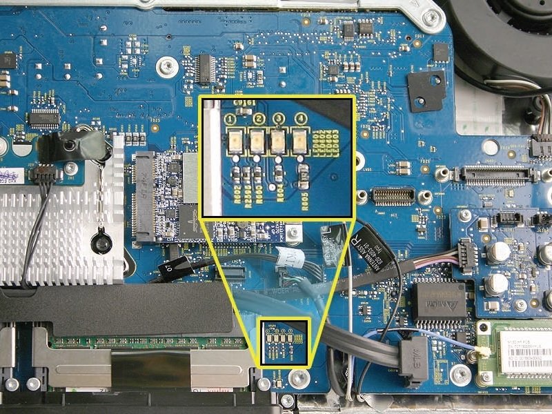

This would be a good time to have Apple's service manual! That will show you where the diagnostics LEDs are. You can see them immediately to the right of the memory slots. Just tip the iMac back so you can see up through the ventilation holes. You may need to remove the front bezel, but you don't usually need that off to see the LEDs.
There are 4 LEDs there. The first may be coming on, any time the power cord is plugged in. #2, 3 and 4 should light up after pressing and releasing the power button.
I suspect you will find that the power supply is not working properly, but you said that you get a boot chime, so, you probably won't get LEDs 3 or 4, which is likely that your video card has failed -- maybe the logic board.

I looked to the Led's and I think it's onli 1,2 and 3, the 4th one doesn't do any thing. What can mean that error?.

Screen problem, or cable to screen?
From iFixit:
LED 4 - Indicates that the computer and the LCD display panel are communicating. This LED will be ON when the computer is turned on and video signal is being generated. If the LED is ON and there is no image on the LCD display panel, the LCD display panel or inverter might be installed incorrectly or need replacement.
I think the likely problem is the inverter board, but that is not a separately replaceable part.
That board is part of the power supply (I think), so replacing the power supply should fix.
But, the inverter cable connects directly from the power supply to the back of the LCD panel.
So, there's another possibility for failure on the display panel itself.
Try the power supply first, as that is a more common failure point. If that does not fix, then it's the LCD panel.
(It's 17 years old. Parts fail from age.)
From iFixit:
But if is an inverter failure. Why the gong sounds and the fans doen't work?.
Also I'd change some time ago the power supply.
