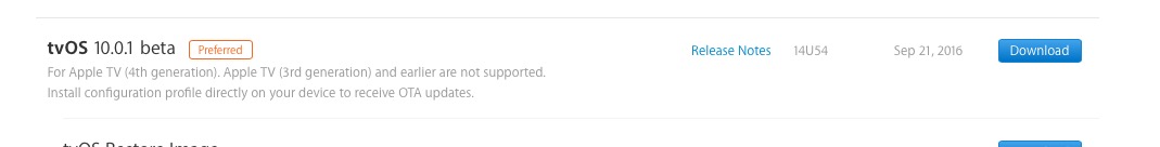

The 3rd Gen (ATV3) is supported but does not provide the automation functions.
That should no longer be working or will no longer fully work. None of the 3rd generation Apple TV's support HomeKit at all due to security reasons as smart lock HomeKit support was added to Siri which isn't supported on the previous gen. If you are experiencing issues I would log out of your Apple TV and either get a 4th gen (they're on sale almost everywhere, I saw the base model listed for less than $100 at BestBuy and other retailers) or use your iPad if you have one.
That is not correct. According to Apple:

As I work in marketing for a specific company whose name is synonymous with a fruit, that *side-note is misleading and will also change with future releases of iOS 10 as SmartHome security devices will be supported with the Apple TV. The 3rd generation does not support those measures.
tvOS 10.0.1 Beta
For Apple TV (4th generation). Apple TV (3rd generation) and earlier are not supported.
Install configuration profile directly on your device to receive OTA updates.
For future reference, try not to make declarative statements such as "That is not correct"; it reads very smugly and condescendingly especially when you aren't fully informed. 🙂
