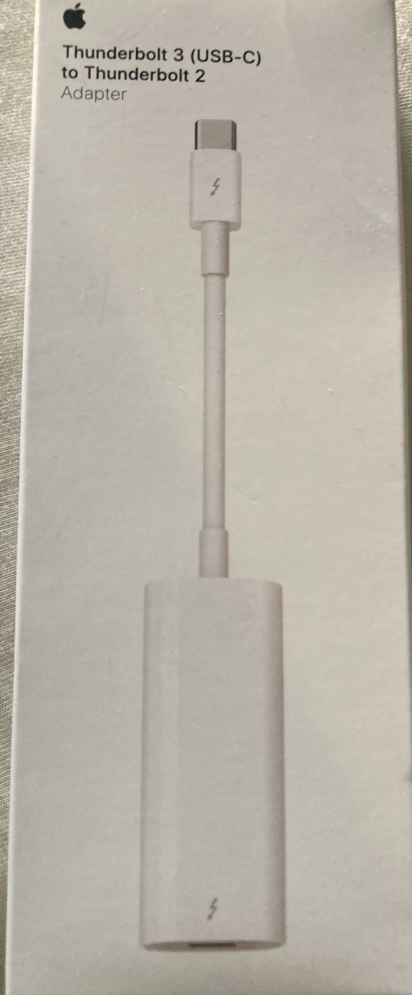

I have this one, but didn't use it to connect a display. Don't know if that might work. I think you need a least a TB1 or 2 cable instead of miniDP. Is DP included in TB? Or only same connector? I don't know.
Edit: Only supports Thuderbolt-Displays.
"Note: This adapter does not support DisplayPort displays like the Apple LED Cinema Display or third-party DisplayPort and Mini DisplayPort displays. For more information, visit the Apple Support page for the Thunderbolt 3 (USB-C) to Thunderbolt 2 Adapter."
USB isn't even mentioned there. Only as port type, but not display protocol.
As you added, that won’t work unless the display requires Thunderbolt input.
The USB-C bit should be dropped from the adapter’s description altogether because it neither allows USB-C devices to be connected to TB1/TB2 hosts, nor vice versa. That bit just creates confusion.
Yes. Doesn’t matter in this case because USB-C DP Alt Mode is what’s needed.
Update: We‘ve since discovered we‘re actually dealing with a Thunderbolt 3 dock here which does require Thunderbolt video input.
