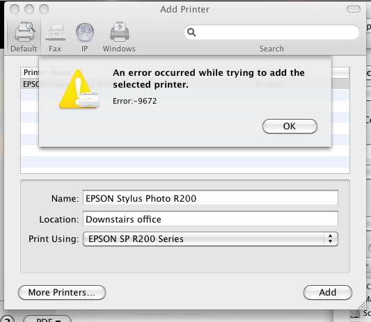

I'm having the same problem with my Epson R200. I feel like I've done everything but I'm still having the challenge. I've done what is posted above and I've been searching online for a workaround with no success. What now?
Should I completely uninstall the printer driver and try again?
Yes, go into the Macintosh HD-Library-Printers and send the driver folder with the name of your printer to the Trash. Do the same in your Home folder. Home-Library-Printers. Restart the computer or log out and log back in and then go to System Preferences and let SL find the proper driver again.

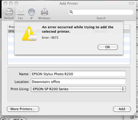

That's a pretty old printer. Is there a newer model that you can tell SL it is? In other words, see if a newer Epson driver will work with your R200.
Yeah, I know it's old but according to Epson, it's supported in SL.

Tried that too. All I get is this error message:
According to this thread at Apple Support Discussions the error code you are getting indicates that the printer does not support the protocol you are trying to use when you add it;

You could try posting to that thread for more assistance or start up your own. It sounds like something with the driver is stuck even though you've reloaded it, or the protocol/mechanism you are using to add it won't work under Snow Leopard and you will need to add it with a different protocol.
Cool, I have the printer connected to my Airport Extreme Base Station. That could be my challenge. Not sure about the protocol thing but I'll see what else I can find out. Thanks so much for your research and time.

Ah, okay so my printer works when directly connected to my MacPro just not when connected to my Airport Extreme. I'm wired to the Airport since I don't have an Airport card in my MacPro (others in the house use the wireless function). So now I guess my challenge is getting it to work over ethernet. Any suggestions?

It's working, not wirelessly, but cabled and, since the computer is right next to the printer, it's all I need. The steps to set up the network connection are a pain in the arse (and I think it requires the software which I can't use), so I'll settle for this. By the way, I found this on the Epson site:
Q: I upgraded to Mac OS X 10.6.x and reinstalled the Epson software for my networked printer. I can’t install the EPSON TCP/IP driver, but I can install the Bonjour driver. Will the Bonjour driver function the same as EPSON TCP/IP driver?
A: Yes. The Bonjour driver will allow you to add a print queue, print and scan with your network product. Epson is aware of a possible problem with EPSON TCP/IP and is working on a solution. Please return periodically to this Epson Macintosh Snow Leopard Support page to check for driver updates.
