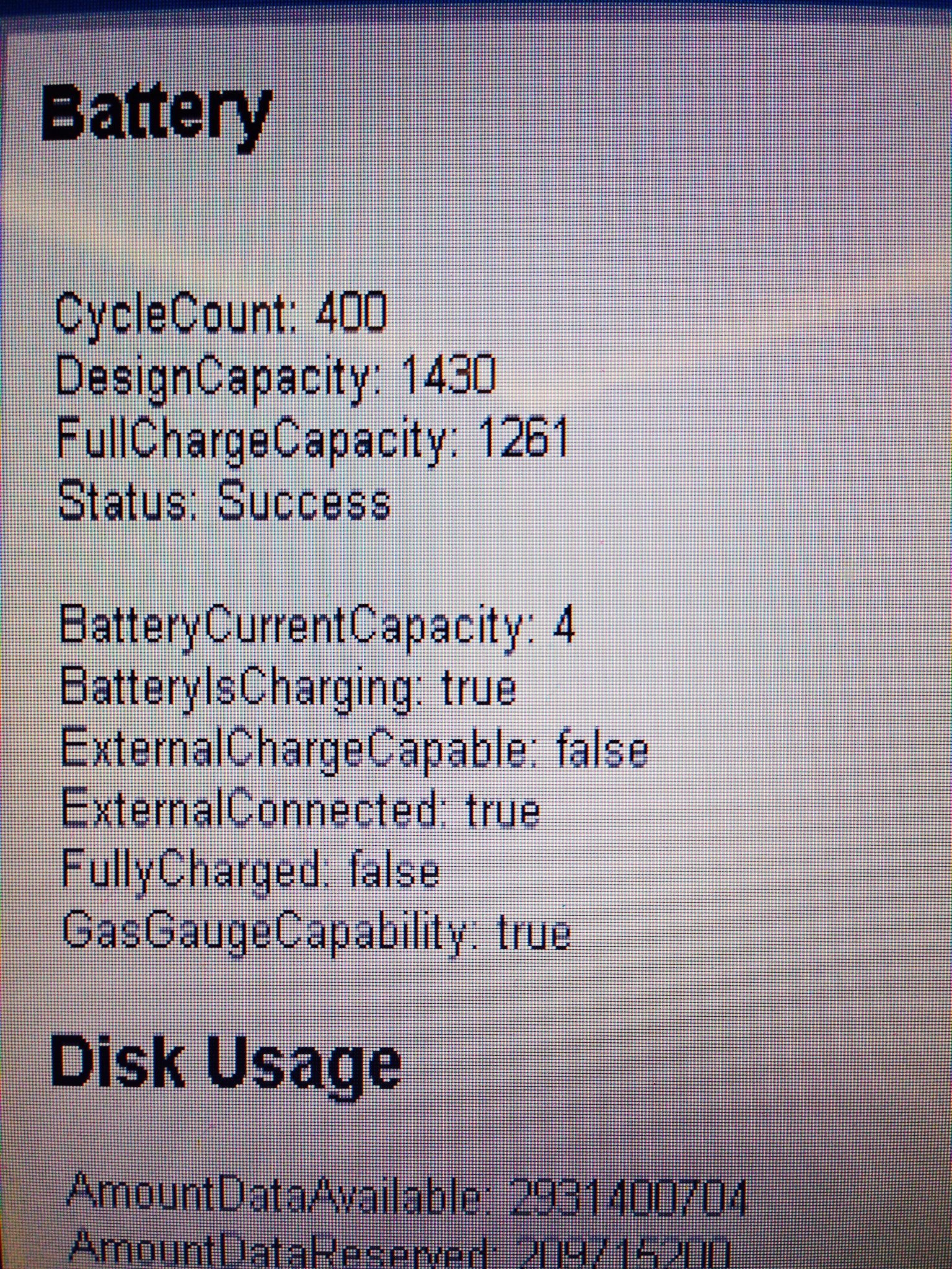

Here is my battery health, is it good?
My Iphone5 turns off about at %7-9 battery charge
