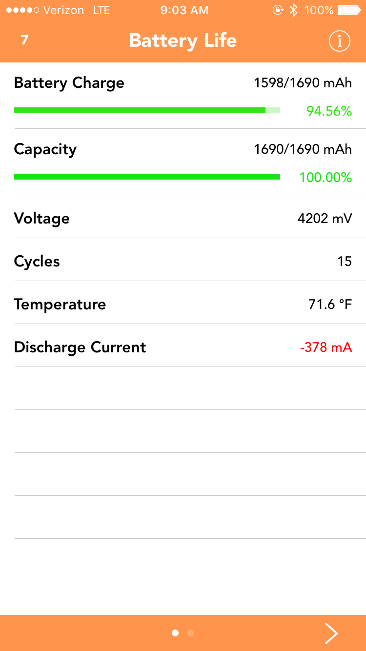

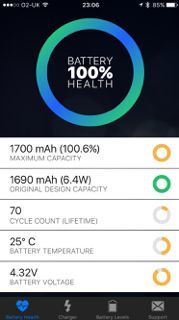

This is admittedly self promotional, but it directly addresses the OP's question: My app, Battery Health, shows all of this information (and more) without having to use something like iBackupBot. Here's a screenshot:
It's not free, but it's easier to use than some of these alternatives.

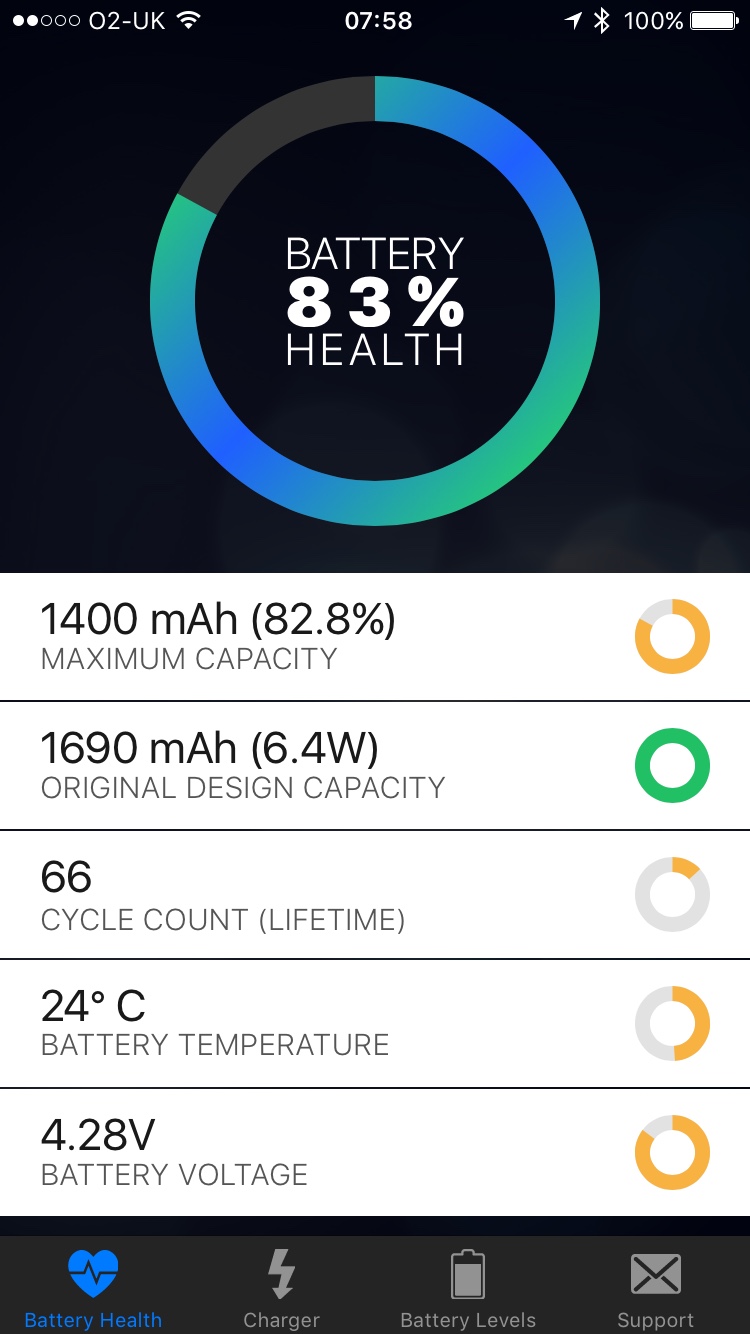

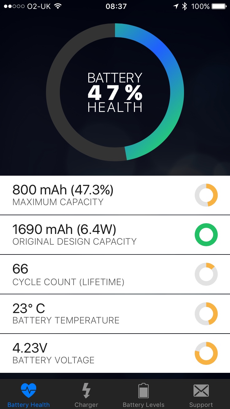

I have a bought on release date iPhone 6s whose battery recently has been appalling, it has gone from brilliant to having to charge it twice daily. Is ibackupbot reliable? Apple says there is nothing wrong but I have a 66 cycle count and a full capacity that swings between 800 and 1400 compared to design capacity of 1690.

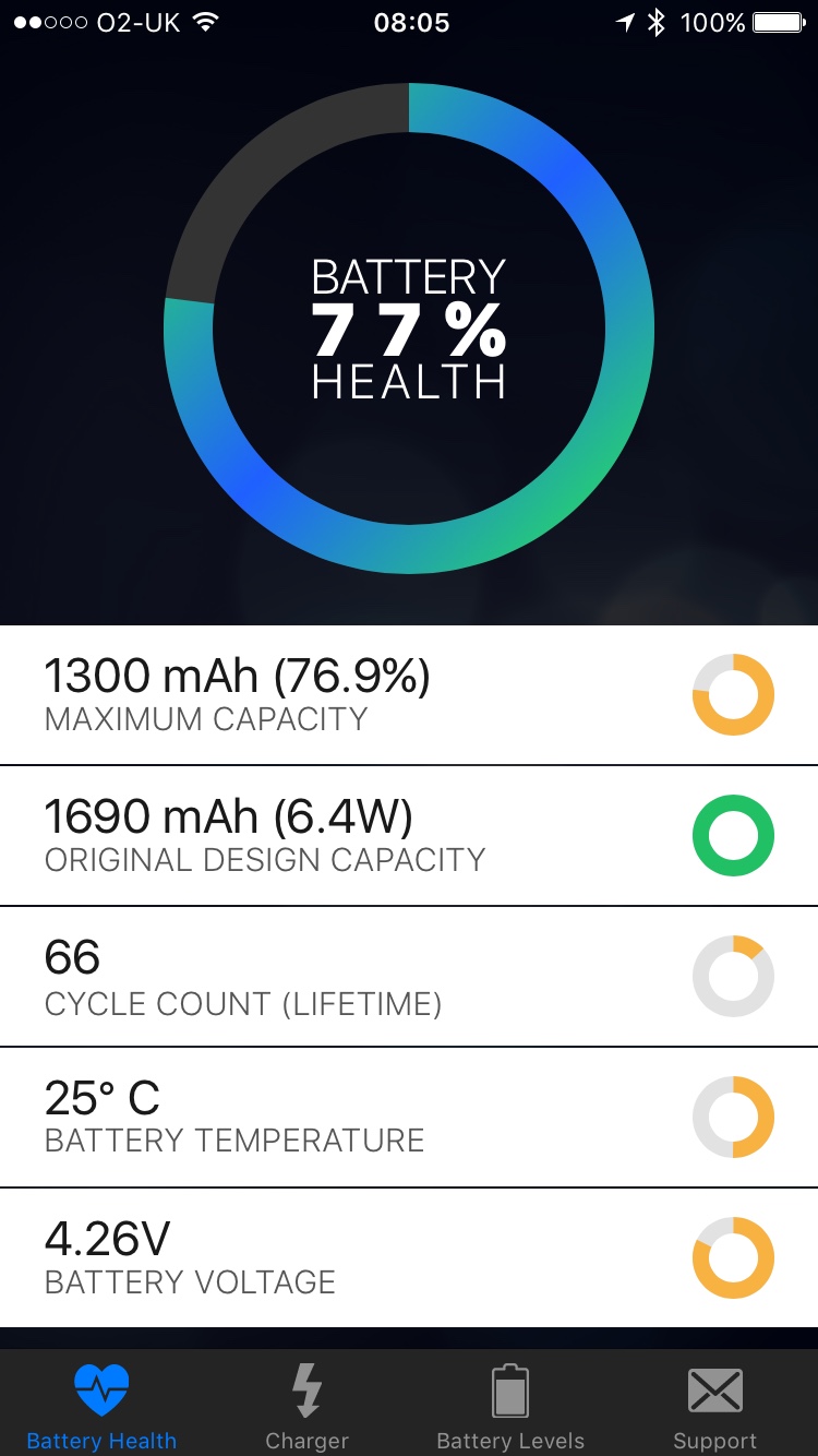

It reminds me of my failing iPhone 5, this is the best result this morning, it started at 1100 this morning after a full night charging. Do I have a case with Apple as they state my battery is fine?
. Just after this post this now the health:
Just restarted and have now got this which mirrors ibackupbot
what do you make of this? its still at nearly 90% but i feel like it utterly sucks now, especially compared to my iPhone 6 (which isnt the greatest either lol)

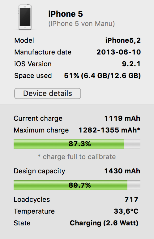

I think you definitely do, but maybe try a full charge-discharge-recharge to recalibrate, if you haven't yet.
66 cycles, the battery should definitely be above 90%.

Just to update, on the suggestion of the developer I did a full discharge and recharge and I can happily say this worked.
My battery health is 100%, but more importantly I have my perceived battery life back. I say perceived as running down my phone was an absolute challenge. In the end it took almost 3 hours of intense use to run it down from 16%. This included playing games, recording almost 30 minutes of video (4K most if it), Facebook etc etc. On this day I racked up 26 hours of standby and 9 hours of use. Obviously my battery hadn't degraded, the percentage meter was just seriously out of whack.
I probably hadn't fallen below 45% in about 2 months or so and given the highly conflicting information about batteries I thought running the phone down to nil wasn't a good idea. However, I will now do it once a month.

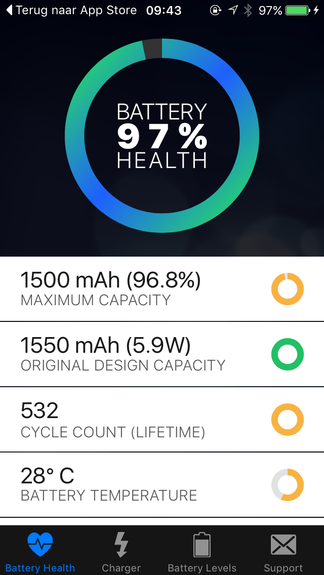

So Strange, that I have more than 532 cycles and nearly 97% health. Charging every day, and only doing calls, and emails.
Maybe a useful tip for people when their phone will fall of at 30/40%
When charging, press sleep and home button together to make it restart. After that, charge it all the way up to 100%. The phone "thinks" it will have 30% left but when your battery is bad, it will fall of. With this reset when plugged in, it wil calculate its battery life, so you have a more accurate measurement.

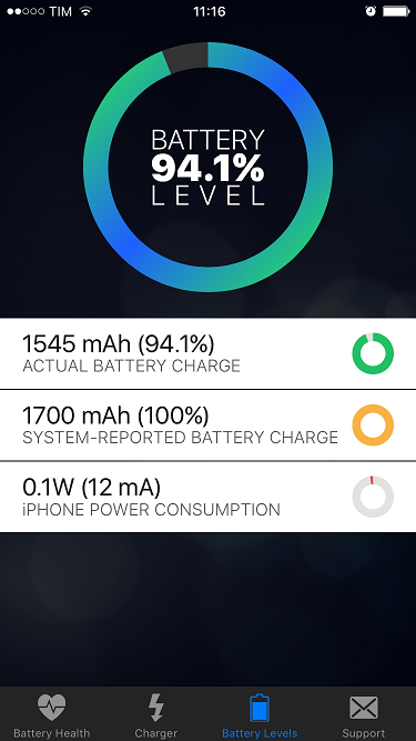

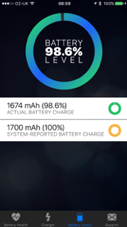

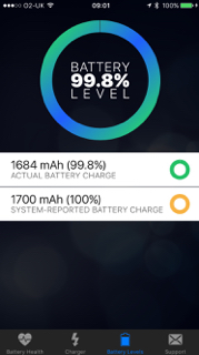

@Sjwhite26 (and I invite any other iP6s owner who will want to!) do you mind posting a screenshot of the "Battery Levels" tab in the Battery Health app when the phone is 100% charged according to the "Actual Battery Charge"?
Like this, only when you're fully charged as I just said:
Thanks in advance!
View attachment 611855. Just after this post this now the health:

So I've observed how those numbers behave. It turns out that if the system-reported battery capacity is for example 1700, when the phone is fully charged and still connected you will see the actual max charge in "Actual Battery Charge", which for my experience can be way lower than 1700- in my case 1630, or less. Which is also very close to the actual "maximum charge" value reported by coconutBattery. BUT, as soon as the phone starts discharging, that "Actual Battery Charge" will re-align with the value reported by the system,and it will then decrease independently from the system-reported one from there.
I don't know if I made myself clear.
However, if I can ask, could you post the same screenshot when full charge is reached but BEFORE unplugging the device?
Everyone else who wants to participate, feel free.
In alternative, a screenshot of coconutBattery with the fully charged device connected is also welcome!
Thanks to everyone who will contribute to my little survey 🙂

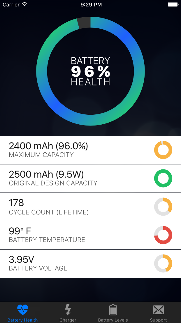

Love the app. Thanks for sharing. Have a quick Q how does max capacity work or how is is calculated? My wifes old 6 has 500 cycles and still at 102.8% max capacity. That cant be right no? Other cases like my old ipad its 250 cycles and 88% which I definitely beleive. Thanks again!
In terms of how maximum capacity is calculated, the answer is that there is just one source for that information: The gas gauge chip. The gas gauge chip is a tiny IC that’s attached to the battery (so that when you replace your battery you’re also replacing the chip). Its job is to measure state of charge (how full the battery is), and maximum capacity over time.
The problem is that those two metrics are never accurately known. The chip has to guess (based on a fairly complex algorithm) the state of the battery at any given time. The algorithm is based on measuring the flow of electricity into and out of the battery as it charges and discharges and trying to calculate how full it is and what its maximum capacity is at any given point in time. The chip reports that to the system (iOS) every few seconds, and a nicely rounded version of that is the battery level you see in the status bar at the top of the screen.
Because the maximum capacity is nothing but an educated guess, those values can vary quite a bit. As the battery is charged and discharged, you will see the gas gauge revising the estimated capacity. Because of that, Apple has a simple mechanism to try and reduce the fluctuations: they round up the maximum capacity to 100mAh, so if the gas gauge says maximum capacity equals 2420mAh, Apple’s algorithm will show 2500mAh. This rounded number is what they use to calculate the battery percentage shown by the system.
The current version of my app shows the Apple rounded figures for maximum capacity, while many JB apps (like the one pictured above), as well as tethered solutions such as iBackupBot tend to show the raw values from the chip.
One recommendation I keep reiterating to users: In order to improve SoC and maximum capacity accuracy one should perform a periodic deep-discharge of the battery, where you completely drain the battery until the device shuts off on its own. I wouldn’t do it too frequently, about once a month should be fine.
Deep-discharge cycles really help the gas gauge determine how much energy is actually stored in the battery, and they tend to reduce the variability of all of those metrics, and therefore improve the accuracy of the battery percentage shown by iOS. To be clear, it doesn’t actually improve your battery’s capacity, but it’ll make the battery percentage (and other health readings, if you use the app) more accurate.
