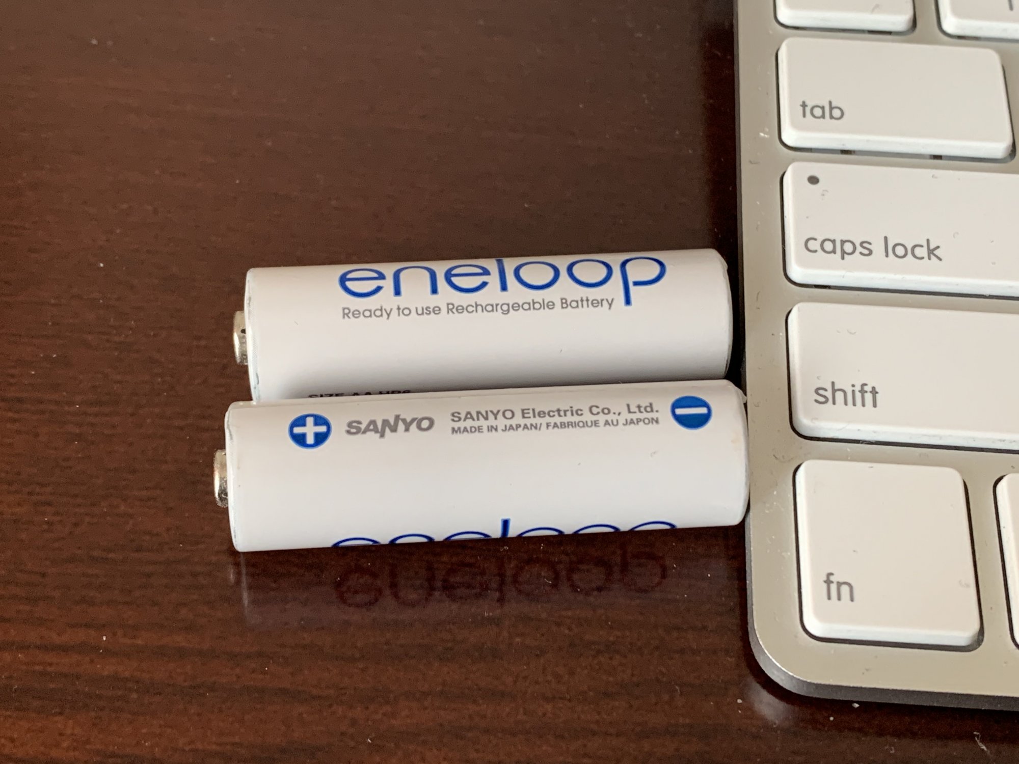

I use a set of 1900mAh Eneloop rechargeable batteries. With them, the Magic Trackpad lasted about a month and the wireless keyboard lasts about another two weeks more. This obviously depends on your usage. I do not type that much so keyboard is used much less. The battery seems to last a bit longer when the keyboard/trackpad is new, but definitely not 4-5 months. Also, the battery will last a while after the low battery warning. Overall, I would say that battery life you have is not unusual.
Getting a set of rechargeable batteries is worth it. I got a set of four Sanyo Eneloop batteries with a charger in 2012 (The brand was still Sanyo before Sanyo was bought by Panasonic later) and they are still running strong in 2021. The new set now is branded Panasonic. The charger that comes with it is better. It charges each of the four batter individually while the old Sanyo one charges in pairs and thus not as "precise" as the new one.
Eneloop batteries are excellent in terms of quality, energy density, leakage resistance, and number of recharge cycles. But be aware that they are NiMH (nickel metal-hydride) batteries and have a different chemistry than the alkaline cells that the Apple accessories were designed for. The main difference is that they have a nominal cell voltage of 1.2 volts rather than the 1.5 volts of an alkaline cell.
The Apple battery status circuitry is calibrated for alkaline cells. So you will get a "low battery" message when using Eneloops when they still have the vast majority of their energy remaining. If you recharge them every time you get the low battery warning, you will be recharging them much more often than required.
They will, however, work well. You just need to be aware that you don't need to recharge them when you get the warning message. They will probably last another couple of months before needing recharging - but unfortunately there is no way to know exactly when unless you remove them and measure their voltage. So the majority of people just use good quality alkaline cells and avoid the hassle.

Read the post above by @colodane. This sounds like normal for eneloop batteries. I've used them for several years, for various devices. I don't currently use them for my mouse or trackpad since I purchased Apple's own rechargeable ones.
hello guys, when you put a fresh set of eneloop in a magic trackpad, what's the battery level? I have been using them in my trackpad for about a year, first time I put them into the trackpad the battery level was at 98%, then 75%, then today it's at 45%. is the battery deteriorating? or trackpad isn't sensing the battery level correctly? thanks for your input.
I only recharge my Eneloop batteries when the mouse/keyboard/trackpad stop functionting.

FYI, the Apple branded rechargeable batteries you could buy some years ago were actually rebranded Eneloops. So they are actually just what Apple wireless peripherals need.
And so are the IKEA branded batteries you can buy today; rebranded Eneloops.
