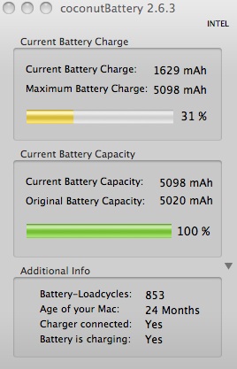

Coconut battery produces incorrect stats in Leopard.
Better to use Battery Health Monitor, or simply go to System Profiler -> Hardware -> Power.

A note to all of you using coconutBattery on your 13" MacBooks running Leopard: coconutBattery seems to report the MacBook's battery capacity at 5020 mAh, when really it's 5200 mAh. I noticed that it changed when I upgraded to Leopard. You can just enter 5200 in the custom capacity in the cB prefs and it'll work just fine.
