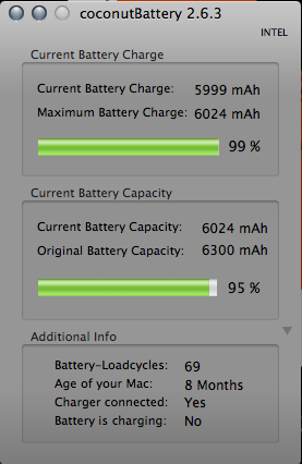

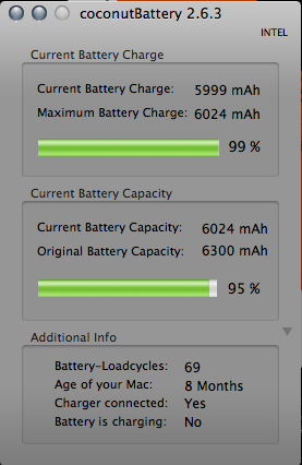

i guess mine is going normal so far...i guess
