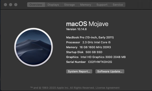

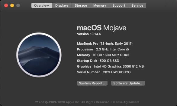

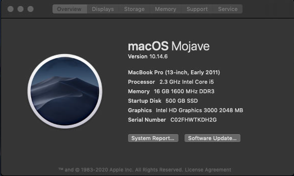

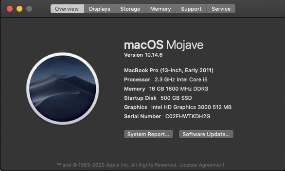

Firstly thank you for taking the trouble to be so helpful.
I have an early 2011 MacBook Pro 13'' i5 2.3MHz with 8GB 1333MHz RAM. My stock VRAM is 512 MB.
I'm running Mac OS High Sierra (10.13.6).
My SSD is an INTEL SSDSC2CW240A3.
I am an architect and use AutoCAD Mac 2015 and also use RIHNO 6, both CAD.
I'm waiting for Corsair Vengeance 16GB (2 x 8GB 1600MHz) High Performance Laptop Memory Upgrade Kit to arrive in the post shortly.
After reading all the posts on this thread I decided to bump up the VRAM to 1536 MB.
Does your patch incorporate what was discovered in posts #18 and #20?
I don't want to make a mistake and have little experience in using the Terminal, so it help me, immensely, if you just let me know what to do step by step.
Thanks in anticipation!
Thank you - I'm now travelling at Mach 1.5!

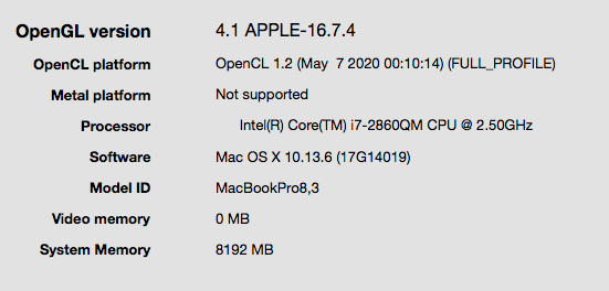

However, checking my Video Memory with OpenGL Extension Viewer it indicates 0 ...
This was before I tried to upgrade the VRAM.
Also after I tried to upgrade the VRAM, Video memory was still 0.
Which makes sense because I keep getting graphics glitches on my screen, no transparency, etc.
But why is there no VRAM allocated to the used GPU?
I have no idea why this is happening (it might have something to do with increasing temperatures or something, I don't know) but it keeps getting worse.
Was hoping to solve this whole issue with allocating more VRAM to the Intel HD3000 GPU but this does not seem to be the solution. I tried running an Apple Diagnostic which indicates an error with a temperature sensor. Not sure if this is related.
Is there a way to check if the Intel HD3000 GPU is properly working, or does anyone know how to fix this?

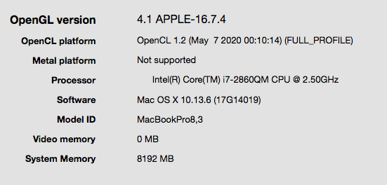

I could follow this to the letter.
What does it show under your About This Mac and System Information under Graphics?
Thanks for asking ...
On both it states Intel HD-video 3000 1024 MB VRAM. Which indicates to me the upgrade went oké.
Previously it was 512 MB video memory. Where OpenGL Extension Viewer also indicated: 0 ...
Even with the VRAM on 1024 MB, I keep getting glitches, no transparency, yellow distortion, etc.
Hi, even reading some sucess stories and trying the scripts step by step nothing changes. Ist there an update after apple updates?
Followed:
csrutil ...
backup of *files
patching kext *SNB
patching in kext *HD3000 (shows the correct 1536MB in file)
reboot in single user mode...
kext utility success
...but still no change after reboot (512MB showing)
