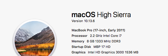

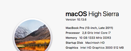

Hello to all:
After do the command (sudo perl -pi -e 's|\xC7\x45\xBC\x00\x00\x00\x40|\xc7\x45\xBC\x00\x00\x00\x80|g' AppleIntelSNBGraphicsFB ) with x80 instead x60, maintain my vRAM to 1.5 Mb.
I have 8 Gb RAM. Then I want ask. If upgrade to 16 Gb, will reach 2 Gb?
I know the HD 3000 have the limitation to 1.7 Gb shared RAM, but in other forum they said set to 2 Gb will use the total 1.7 Gb.
Regards

With 8 Gb RAM you can reach 2 Gb VRAM on that GPU, try these already patched FB I did for Mojave but essentially is based on HighSierra kexts for IntelHD3000, so they are exactly the same.
IntelHD3000 VRAM increase pre-patched HighSierra/Mojave

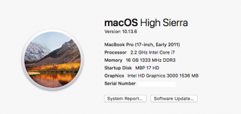

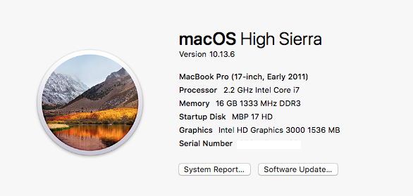

Hello: Mine is a MacBook Pro 17 2011
The dGPU fail and hack the firmware to override the chip. Now Install 16 Gb and using VectorWorks 2017 haven't problems yet.
Next week I will install an SSD replacing the HDD to increase its speed.
Do you have issues?
Regards

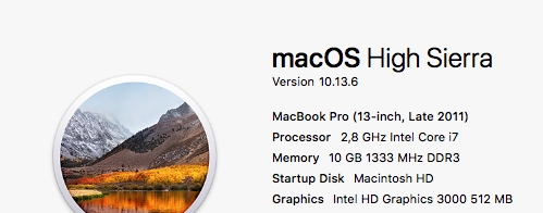

I may have issues, and severe ones. It may be connected to this „hack“. every time i do something that will fill up the vram (previewing huge image, scrolling a webpage that perpetually loads more and more images) i reach a point where the whole ui glitches out. More and more ui elements become scrambled until nothing works anymore. No overheating. Reboot cures it perfectly. Had set the vram to 1,5 gb, i guess the hd 3000 isn’t able to handle that much and literally gives up.
i have 16 gigs installed on my late 2011 13 mbp and the system on a ssd. i have never seen any performance gain from this hack, because I didn't notice any drop in performance each time the hack was disabled after a security update of hight Sierra

Sad to know your impressions.
In my case, glitches appears some time, for example editing photos with Photos.app. But I use Aperture 3.6 instead, and all works fine to me.
I will share with you the procedure I did.
https://apple.stackexchange.com/questions/362448/mac-book-pro-17-running-without-dgpu-and-16-gb-ram
I hope works for you as well
Do you have issues?
Regards
no issues at all, only one I have was when I put a second ssd on the dvd drive bay with an adapter sata 2, but if you use a sata 3 theres no problems, I now have two ssd's inside the machine.

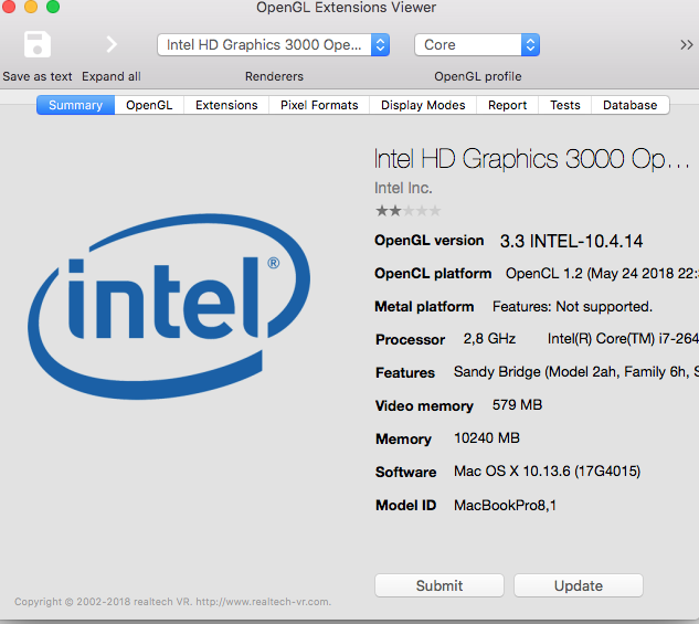

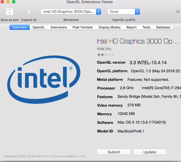

About this Mac has a false flag about video memory. Always confirm with the Open GL Extensions viewer app.
If you modify AppleIntelSNBGraphicsFB.kext with the perl command and do not modify Info.plist (AppleIntelHD3000Graphics.kext):
About this Mac -> Graphics: Intel HD Graphics 3000 1024 MB
Open GL Extensions Viewer -> Video Memory: 512 MB
