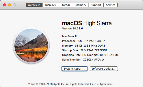

I did this on an early 2011 mbp with intel hd 3000 (macos highsierra).
it did not work.
I turned off SIP then ran the command to transform my 512mb to 1gb.
then edited the plist file , repaired and rebuild caches with kext utility.
idk what I did was wrong. but it stayed the same (512mb).
plz help

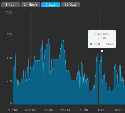

Posting an update on how this is going:

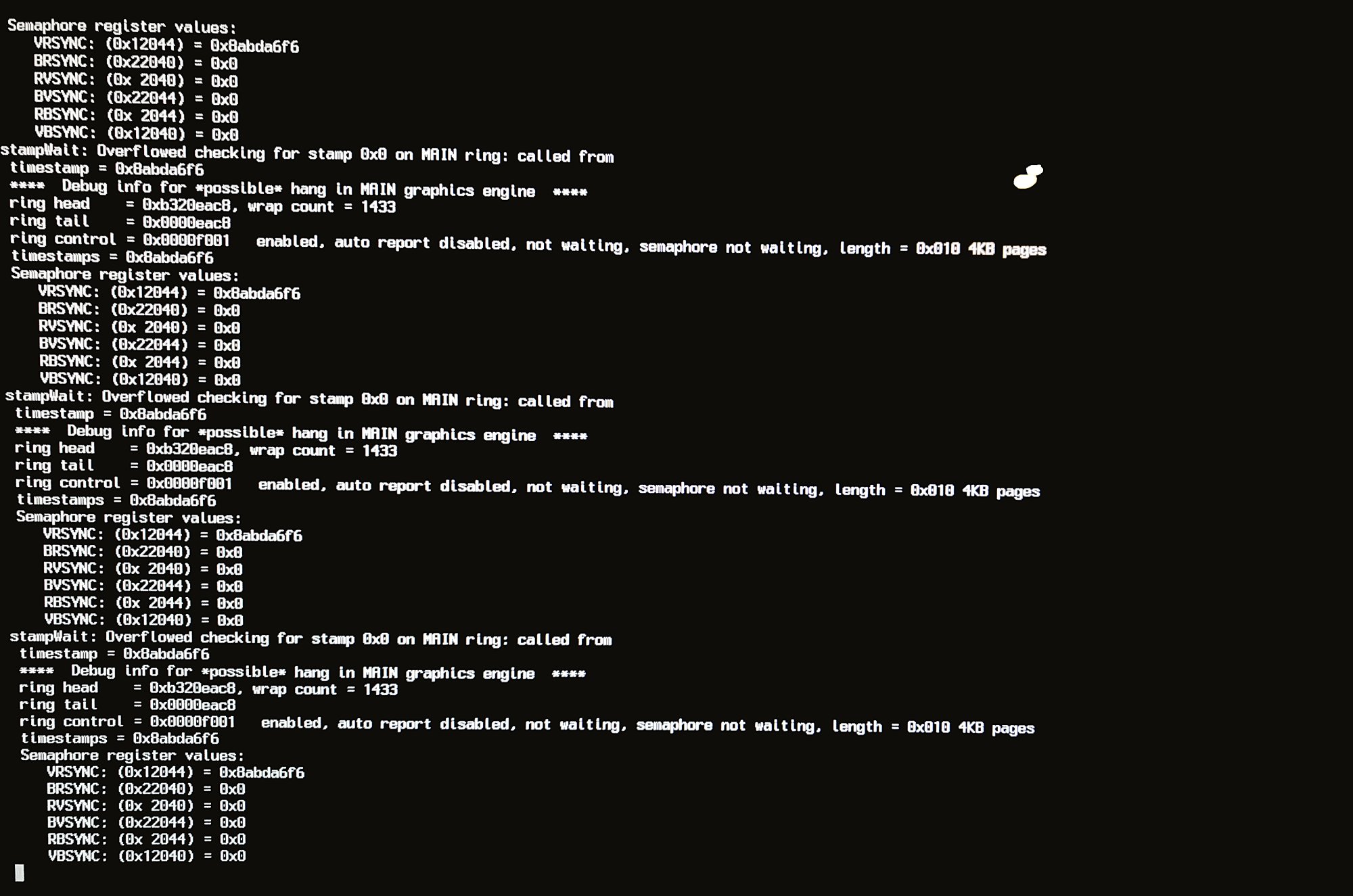

The issue with GPU frozenness, when the GPU is pushed, seems to occur specifically when multiple applications, like browsers, email clients, and other utilities have been running for many hours, if not days (as is often the case with the browser). But it isn’t tripped unless one is also running VLC to watch 1080p content in series, such as watching a marathon of episodes.
This checks out with the first time I remember experiencing this happening back in 2012, though at the time the content was probably 720p. It also seemed to take a longer stretch of leaving VLC running in foreground or background before the threshold for the hang-freeze-release-hang… cycle was reached. With 1080p content, that threshold can be reached much sooner.
In the most recent case, I left VLC open in the background whilst working on other tasks, at a time when VLC wasn’t playing any content. But during the evenings, I might watch three or four episodes, in series, before leaving the system running and idling until the next morning. After about five or six days of doing this (this system, after all, has a healthy 16GB of RAM to work with), the tripwire is reached when VLC is either playing a video (or has one paused) in full-screen mode, when Cmd-Tab’d to the background to access other running applications.
This has happened with Snow Leopard, with High Sierra and, as of a few weeks ago, with Mojave. It’s happened with an early 2011 i5 13-inch MBP as well as a late 2011 i7 13-inch MBP. It’s happened when the MBP used an HDD for /Users and SSD for boot volume, and it’s happened when the MBP was all-SSD with DRAM cache. It’s happened with 8GB RAM installed and with 16GB installed. It’s happened with VLC 2.2.8 on up through the VLC 3.0.x builds through the current version 3.0.20. A common denominator across all of them is the iGPU.
Once the tripwire is crossed, I’ve paid especial notice to the iStat figures for reserved DRAM for VRAM use. The tweak I made above, to 1024MB VRAM reserve, does provide more headroom for how much VRAM the Intel HD Graphics 3000 can access. This, however, does not seem to affect this GPU tripwire issue, which I had hypothesized was a function of the iGPU running into VRAM headroom issues. After the tripwire, the only remedy is a reboot (oftentimes, due to the above photo of the repeating message, this means a hard reboot).
So in the end, this appears to be where the HD Graphics 3000 “can’t take the strain” and begins to hang-freeze-release from that point. I don’t know what specifically it is about VLC which overwhelms the iGPU as, at least with the i7 2.8GHz MBP, video performance whilst in foreground doesn’t hiccup unless and until the tripwire threshold is crossed.

I’m curious: have you stress-tested the system in a manner similar to the method I find which works? Namely, this means having Firefox, with north of 100 tabs open; an email client, an active utility or two; maybe Word or TextEdit along with Photoshop and/or Preview; and also VLC playing HD video — all spanning, without powering down, for several days?
With VLC being a contributing linchpin, one way to speed up this issue is to make a 1080p rip of a Blu-Ray film in x265. Next, let it run, full screen mode, on single-track repeat for, say, 12–24 hours (to replicate the accumulated time, over the span of a week or two, of watching a season of a TV show, 2–3 hours’ worth each evening). Cmd-Tab, from time to time, between the VLC video running in the background and, say, the browser.
This has been the set of environmental testing conditions which seem to set the iGPU tripwire. With 4GB, you might not need to open as many of these example applications, but VLC running HD, with accumulated view hours in full-screen mode, is key here.
