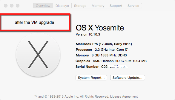

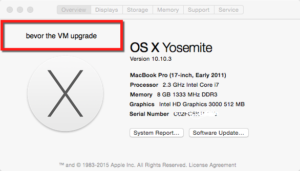

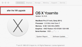

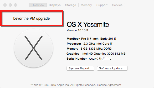

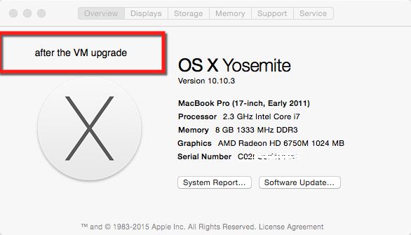

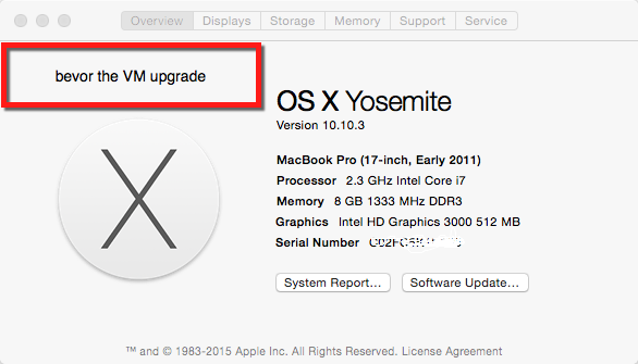

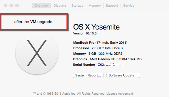

Hi, can somebody explain me that strange behavior, after upgrading from Intel 3000 HD Graphics 512MB to 1GB?
Check the printscreen. The MAC-Book tells me now, that i have a AMD Radeon, instead the Intel 3000 HD???? WTF 🙂 HAHA...
I'm a absolute beginner in MAC-stuff. thanks a lot.
vilocram
View attachment 561014 View attachment 561015
Because your Mac has two GPUs - the integrated Intel HD 3000 and the discrete AMD Radeon card. It just happened that the AMD card was active.
Hi, Thanks for the quick answer, but i'm still confused, so i have 2GPU's ok. So, if i have to GPU's in a PC, it shows me 2GPU's. Are this 2 GPU's in my MAC for different Tasks? for example one for 3Dstuff? if yes, does the system switch automaticaly to the correct GPU, are they both active, if yes, why is is only one GPU shown in the "about my MAC" menu! thanks again
You got most of it right, it'll automatically switch according to tasks. Only one GPU can be active at any one time, so only the active one will be shown.
ok thank u for the quick answers..!

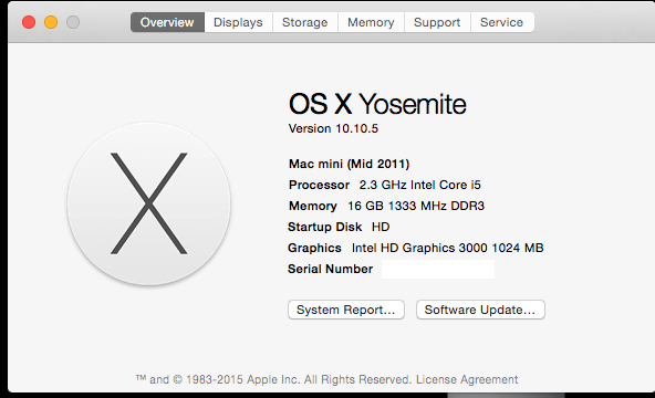

After some research I figure out how to make this tweak really works, you have to edit the Info.plist at AppleIntelHD3000Graphics.kext/C*
Have to add after VRAMOverrride the VRAMSize key, it will be like this:
<key>VRAMOverride</key>
<integer>0</integer>
<key>VRAMSize</key>
<integer>1024</integer>
Add these last two lines (VRAMSize integer value should match with the value you picked to edit the first kext, save it and patch and fix the extensions with Kext Utility and you are good to go!
Have fun! After several tests and benchmark I realize that 1024 vram size is the best. More then that your gpu don't use, believe me, I tried!
The proof screenshot:

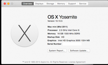

Thanks very much for this great thread. I was wondering about this, as I've just purchased my MacBook Pro 13" early 2011 and upgraded it to Yosemite.
This evening I've tested the above terminal command for 512MB > 1024MB on Yosemite 10.10.0. Graphics were already running at 512MB VRAM due to the MacBook having 16GB RAM.
The initial result following restart: Boot was very slow, and upon login VRAM showed as 3MB. Terrible graphical performance.
Next step was to recover my backup .kext and restart; 3MB issue persisted following restart.
Then, downloaded and ran the following utility to repair kexts:
http://cvad-mac.narod.ru/index/0-4
This restored my original 512MB VRAM configuration. Next and original step was to get to 1024MB 😉
My process on Yosemite to get 1024MB:
1) Run the original terminal command in this thread for 512MB > 1024MB (and assuming you can replace this with the upgrade of your choice)
2) Run the above-linked utility in this post directly afterwards
3) Restart
4) Enjoy
Graphics now test successfully at 1024MB VRAM. Whether it will survive a software update - I'm not sure, but easy enough to repeat 🙂

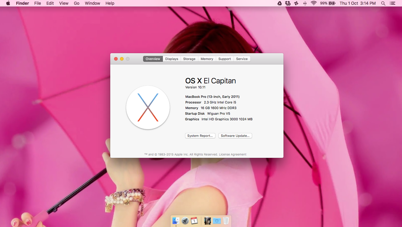

I have installed OS X El Capitan, and could not update my kext file:
kesha-mbp:MacOS kesha$ sudo perl -pi -e 's|\xC7\x45\xBC\x00\x00\x00\x20|\xc7\x45\xBC\x00\x00\x00\x40|g' AppleIntelSNBGraphicsFB
Can't remove AppleIntelSNBGraphicsFB: Operation not permitted, skipping file.
Could somebody help me please? I need to upgrade VRAM size to allow Final Cut use my graphics accelerator working - without it is works REEEEEALY slow with all of 3D effects.
Did you turn off the 'rootless' default in El Capitan? That would explain why it's being rejected.
First you have to disable the system integrety check "rootless".
Simply boot to your recovery manager (CMD + R)
and then open Terminal from Utilities menu.
Type;
csrutil disable
and restart.
