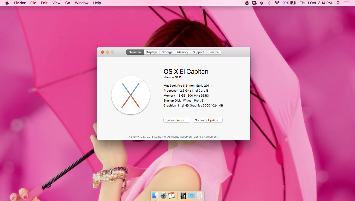

After some research I figure out how to make this tweak really works, you have to edit the Info.plist at AppleIntelHD3000Graphics.kext/C*
Have to add after VRAMOverrride the VRAMSize key, it will be like this:
<key>VRAMOverride</key>
<integer>0</integer>
<key>VRAMSize</key>
<integer>1024</integer>
Add these last two lines (VRAMSize integer value should match with the value you picked to edit the first kext, save it and patch and fix the extensions with Kext Utility and you are good to go!
Have fun! After several tests and benchmark I realize that 1024 vram size is the best. More then that your gpu don't use, believe me, I tried!
The proof screenshot:

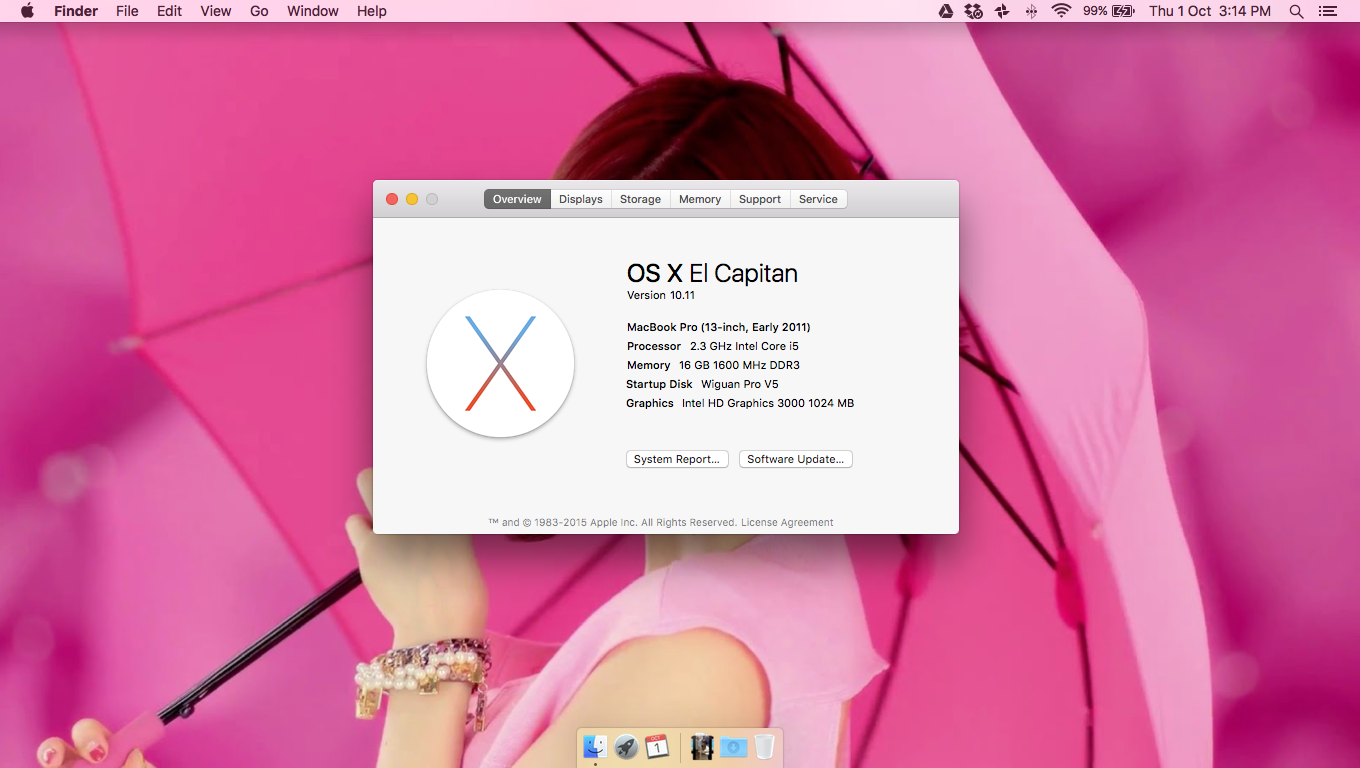

<key>VRAMSize</key>
