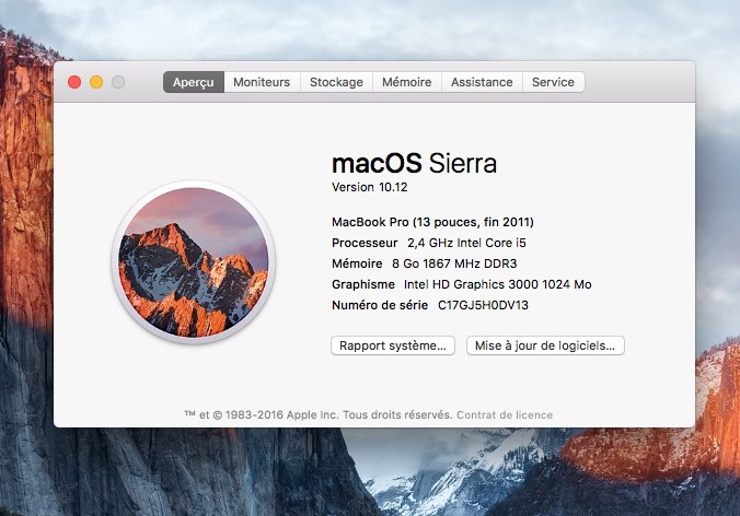

Here I modified the kext for MBP early 2011, just copy the files inside the zip file to your desktop and run kextbeast and restart, you'll have 1024 mb VRAM. Doesnt matter what it was before, make backups of your originals. You're Welcome.
Thank's dude !
Works very well on MacOS Sierra with your files !
Thanks again, I'm very happy ! 🙂

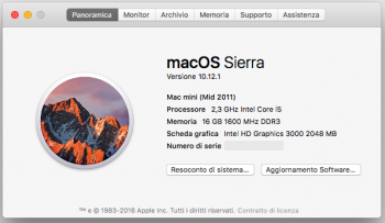

  1. Disable SIP on recovery mode;
  2. Download https://forums.macrumors.com/attachments/osx-integrated-graphics-update-to-1gb-vram-zip.624377/
  3. Copy its files on the desktop and run KextBeast
  4. Restart the computer
  5. Now you will have 1024MB 😉
After doing the above steps, you can increase from 1024 MB to 2048 MB with these terminal script:
  1. Code:
    cd /S*/L*/Ext*/AppleIntelSNBGraphicsFB.kext/C*/M*
  2. Code:
    sudo cp AppleIntelSNBGraphicsFB AppleIntelSNBGraphicsFB.backup
  3. Code:
    sudo perl -pi -e 's|\xC7\x45\xBC\x00\x00\x00\x40|\xc7\x45\xBC\x00\x00\x00\x80|g' AppleIntelSNBGraphicsFB
  4. Code:
    sudo touch /S*/L*/Extensions
Now restart the computer, and you will have 2048MB 😉
