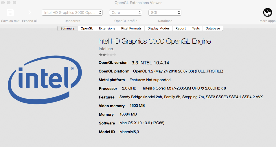

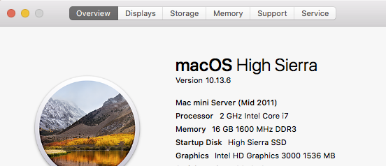

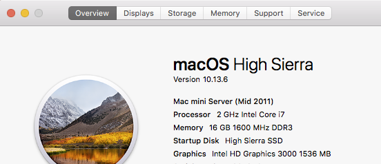

Does this work on 2011 Quad core i7 Mac mini server too? I have 16 GB RAM (stated to be 512MB VRAM on HD3000). Since upgrading to High Sierra I keep getting window rendering glitches and was wondering if increasing the VRAM allocation might help. I run a Dell 27 inch and Dell 24 inch as dual displays off the mini.
I guess the glitches depend from your GPU, however you could try these steps to increase from 512 MB to 1536 MB VRAM from HighSierra Terminal:
cd /S*/L*/Ext*/AppleIntelSNBGraphicsFB.kext/C*/M*
sudo cp AppleIntelSNBGraphicsFB AppleIntelSNBGraphicsFB.1gb
sudo perl -pi -e 's|\xC7\x45\xD0\x00\x00\x00\x20|\xC7\x45\xD0\x00\x00\x00\x60|g' AppleIntelSNBGraphicsFB
sudo touch /S*/L*/Extensions
Then from your AppleIntelHD3000Graphics.kext/Contents/Info.plist you should edit/replace your actually:
<key>VRAMMethod</key>
<integer>0</integer>
<key>VRAMOverride</key>
<key>VRAMSize</key>
<integer>512</integer>
into (add VRAMSize if missing in your original info.plist):
<key>VRAMSize</key>
<integer>1536</integer>
After done type from Terminal:
sudo chown -R 0:0 /System/Library/Extensions && sudo chmod -R 755 /System/Library/Extensions
sudo kextcache -i /
sudo reboot
Thanks Jackluke. The steps worked on a 16GB i7 quad 2011 mini with HighSierra 10.13.6. Whether they actually make any difference...we shall see.
Reactions: jackluke

Where does it display VRAM?
EDIT: here
Screens are 2560x1440 (horizontal) and 1920x1200 (vertical orientation).
Where doe sit display VRAM?
EDIT:
It's into the macOS registry, however it's shared from the real RAM quantity, anyway reading well, I guess you don't have the proper RAM kind for your mac should be this: 1333 MHz DDR3 SDRAM (PC3-10600), you have 1600 Mhz (PC3-12800) so a bit overclocked.
edit:
Ok, from your pictures VRAM increasing is correct.
Video Memory field is the effective VRAM shared from the real (16 gb) RAM, so you will have 14,5 Gb available physical memory.
You have a screen 4k and another 2k, for supporting these two resolutions concurrently you need a more powerful GPU, for example IntelHD4000 would be better (it's Metal too), but you need a Mac mini 2012 for that, as you know GPUs on almost all mac are soldered on-board.
edit:
So you have a screen 4k and another 2k, for supporting these two resolutions concurrently you need a powerful GPUs, for example IntelHD4000 would be much better, but you need a Mac mini 2012 for that.
No. I think this RAM is fine (or at least Crucial indicated it was compatible...). I did once try 16GB of 1866 Mhz and it was unstable. Kept getting kernel panics.
Neither display is 4K - the 2011 mini with HD3000 cannot drive even one 4K display. The max is 2560x1600. I have 2560x1440. 4K is 3840x 2160. TB2 or above is needed. 2011 mini only has original TB1/mDP connection + HDMI (max 1920x1200).
Regarding gaming, hoarding more VRAM is not gonna bring you any significant boost in performance.
I don't care about games. I care about smooth UI (if possible), and lack of visual artifacts. Since upgrading to High Sierra, I was getting huge corruptions in window rendering - like massive jaggies across entire windows for a frame.
[doublepost=1538387218][/doublepost]UPDATE: After a second reboot, the UI is now smooth when dragging windows from one screen to another. Not sure what was wrong before.
