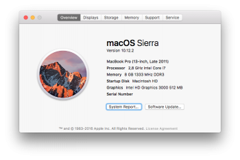

Hi everyone. I've incresed vRam to 2gb memory having 8gb Ram with pre-hacked files, however I for now I have really decreased performance. How to change it back (or 1gb) safely?
Wow, just tried this on my early 2011 MBP with Sierra 10.12.4 (beta), it actually worked! Intel Graphics 3000 @ 2048 MB now 😀
BIG THANK YOU to the guys who came up with this workaround!

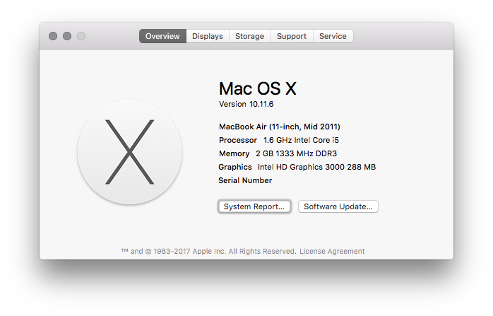

Bit of an odd question; I'm actually looking to decrease the amount of VRAM on my 2011 MacBook Air; it's currently at its default 288MB, and I'd like to knock it down to 128MB. I don't do anything graphically intensive on it at all, and it only has 2GB of RAM. I'd just like to free up a little more RAM for other tasks; any ideas?

I am a bit confused by "its default 288MB", did OS X revise the 256MB RAM allocation share up to 288MB? Either way, I don't know if that HD3000 can function with half of the original designated RAM allotment.

Apparently so, as that's what it reports. I appreciate you looking up some stuff for me!

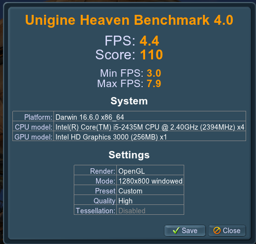

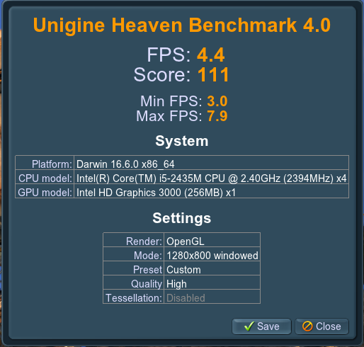

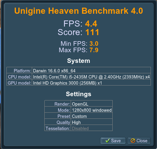

Okay, so I've spent the past 12 hours researching and experimenting with everything in this thread and some things in some other threads. I'm almost an expert except I'm not.
I run Sierra OS X. I upgraded my late-2011 Mac Book Pro from 4gb RAM to 16gb RAM. Noticing that a game (Civ VI) required 1gb of VRAM I plunged into this rabbit hole. I've done hex edits, text edits, kext edits and used Kext Utility, Kextbeast, and Terminal Commands.
I ran benchmarks on my edits and you know what? Nothing I did mattered. It seems that Sierra OS allocated the most efficient amount of VRAM. I only have ONE question before I throw in the towel. In my Benchmarks it says 256mb VRAM, is this an error in the Heaven's benchmark program or has something happened limiting my VRAM to 256mb?
In my About my Mac settings it originally showed 512mb VRAM (up from the 388mb when I had 4gb RAM). After I did all the manual edits it showed 1024 mb VRAM. After I ran kextbeast it showed 1024mb VRAM. Yet, in the three benchmark tests it says 256mb VRAM is there anything to fix or am I done here?
1st photo (Base Sierra OS allocation) 2nd Photo (After manually altering all kext files) 3rd Photo (After running Kextbeast)
