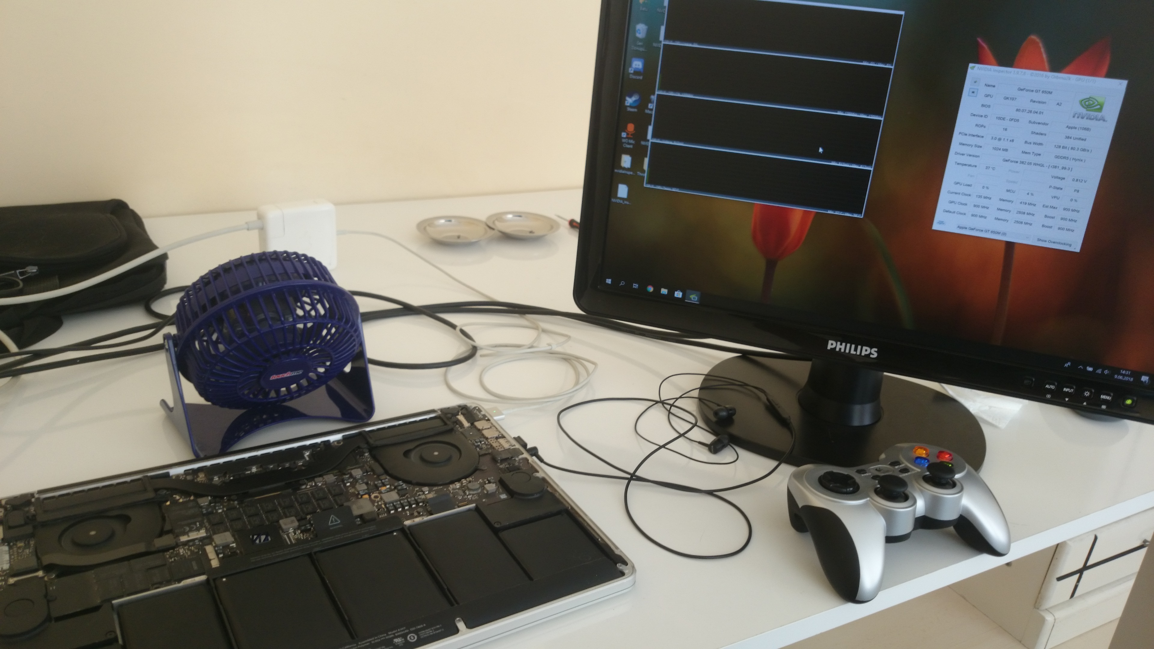

This is not a lack of power issue because if you cool down your gpu aggressively you can get stable 900mhz without throttling. This is a way to achieve advertised clock frequency:
(In case of the image link break: This picture shows my macbook: lid closed, bottom up, bottom cover removed, an external 14w fan blowing to GPU directly, connected to an external monitor via hdmi.)
