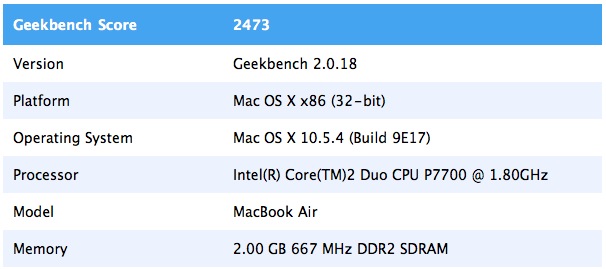

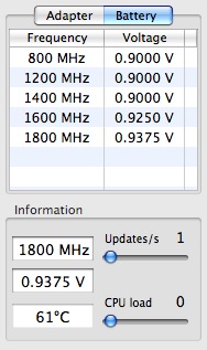

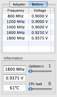

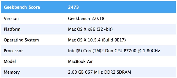

I am on Cloud9 right now! First of all, I went 0.9000 on 800-1400MHz then 0.9250 on 1600Mhz and 0.9375 on 1800MHz which in and of itself is a success. My temps are under 66C. But the real win is my Geekbench score 🙂
