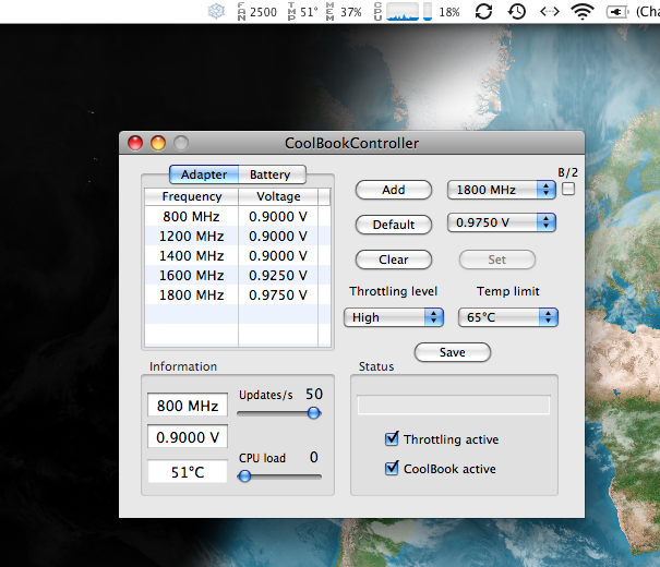

Just thought I would share my settings
I have had KP's on 1600 when I went one setting lower, and KP's on 1800 at the same
I have been running definitely cooler than before and I had the settings from the OP
Bottom line I would really test what your chip can do. Earlier on people have said to just try and see and I couldnt agree more - it really does seem like all chips are not created equal 😉

You have to put 'temp limit' in coolbook at 'off', then you can fully use your macbook cpu power.
Because if you set a limit it will clock down to 800mhz to lower the temperature to the value you selected.
I put only 1 setting in coolbook, that is 1600mhz, and put the voltage at 0.9125V.
Now I run 2 terminal windows with yes > /dev/null and the temperature reaches 90 degrees celcius, i let it run for 15minutes.
When i put the default voltage for 1600mhz it quickly reaches 100 degrees and the cpu starts to run at 1200mhz (built in protection from intel) in order to lower the temperature.
This is proof that the macbook air cannot run at full power when you run it without coolbook.
Or can someone can prove me wrong?
