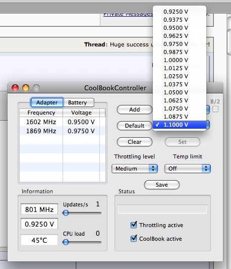

trying to add in new frequency and voltage but I only can select 1862 mhz and 1596 mhz under frequency. how to i obtain other frequencies ex. 800, 1200 etc.

there's a checkbox in the top right of the coolbook window that says 'B/2'...check that box and you can get 798 and 931 MHz options for frequency
those are the only 4 settings i can find for frequency on coolbook 2.12 (which came out today 😀 ) on my MBAir Rev B...
eariler in this thread, i've read that other people have the option for 1200 and 1400 MHz frequencies, but i can't figure these out...i even e-mailed magnus about this,and he's unsure why i don't have these options..

can someone using the mba rev.b post the the complete values of coolbook (voltage and mhz).
THX
marcip3
got only 1602mhz and 1869mhz.
1602mhz's voltage use is being limited to only at 1.000v
SMC fan temperatures reads over 100c when I did a cpu test... which i don't think is the case.... otherwise one of the core would have been shut done by my current setting.
