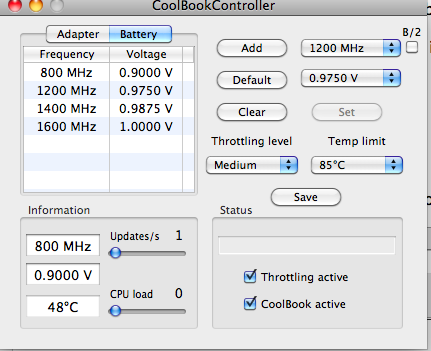

Staus:
Previously I could not have skype video call for one hour with atleast two shutdowns due to overheating. After Coolbook, it works much better just with one shutdown.
Here are my settings that works without panic on my MBA Rev A 1.6GHZ Hard Disk
I am yet to change on Adapter, planning to just copy battery settings.
Suggestions welcome.
Much Thanks to everyone on this thread who reported this especially OP who started this thread and others who contributed also. Cheers.

Here is what I did, I looked at other people's settings for 1.6GHZ MBA and set that voltage. I only modified the higher frequencies onles liek 1200,1400,1600Hz and lowered the voltage. I just clicked on the test button on t hat page and saved it. Did not bother to do any cpu test. Soon I started getting kernel panic and increased the voltage for 1.6GHZ and 1.4GHZ by couple of notches and the kernel panics stopped, and later I reduced it by a notch till I could watch youtube with no panics. I posted my final settings above.
Note: Mine is a 1.6GHZ MBA
