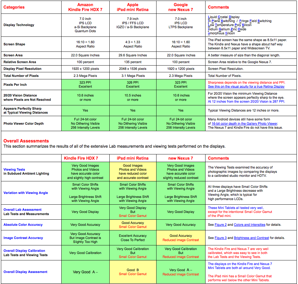

The mini is around 60% sRGB, the Air is around 110% sRGB.
100% sRGB is considered ideal, with truest to life colours.
Actually, 100% sRGB is far from ideal - we can see a much wider range of color than that.
The issue is that with these being low power devices, they are not color managed.
Most content for the web is designed with sRGB as the target, so 100% sRGB is "accurate" for the web.
However, there are many more colors outside of the sRGB gamut which our eyes can see.
If you had today's iPad with a display which showed "200% sRGB" then color would look extremely over-saturated.
But if your software supported color management (Firefox is the only fully color managed browser) then any content designed for the web in sRGB would look exactly the same as a display limited to 100% sRGB.
So what would the point be? Well the display would have the ability to go far beyond sRGB where appropriate. E.g. When displaying Adobe RGB or ProPhoto RGB images.

Actually, this is a very common problem, going back to when LCDs were just approaching sRGB gamuts themselves.
The short version is: the Air is actually displaying the correct color.
While the Mini has a smaller gamut and less accurate color than the Air, blue is shifted way off towards cyan, so it actually looks bluer than it is meant to, but not as rich.
The solution for this is time. It just looks wrong because it's not what you are used to.
Spend a while with a 100% sRGB display and then go back to something with a smaller gamut. It no longer looks like the older display is correct.
