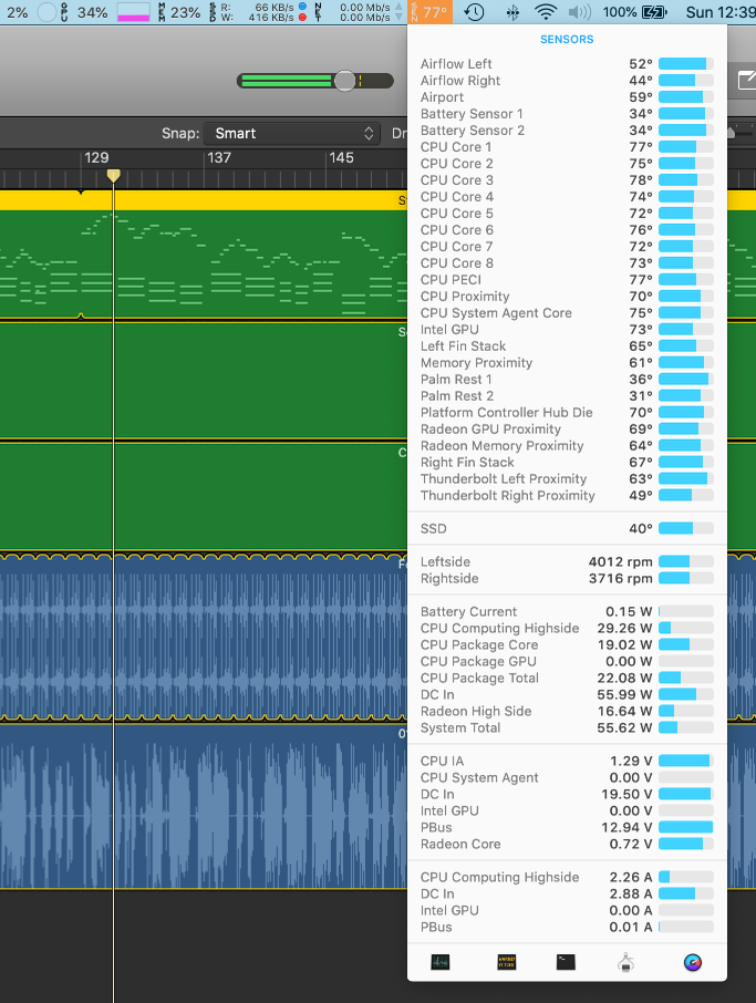

I’m sure you’ve already been asked this... but have you monitored Radeon power draw with an app like istat menus while plugged into your external?
Not because you should try to look for a problem that isn’t there, but because I’d really like to know if you’re having zero fan noise issues because your Radeon isn’t drawing 22 watts like the rest of us, and if it’s not, what is it about your configuration that doesn’t cause the massive power draw the rest of us are seeing? And if it IS drawing 22 watts and you have zero fan noise issues, what is it about my configuration that causes all of the extra heat and noise?

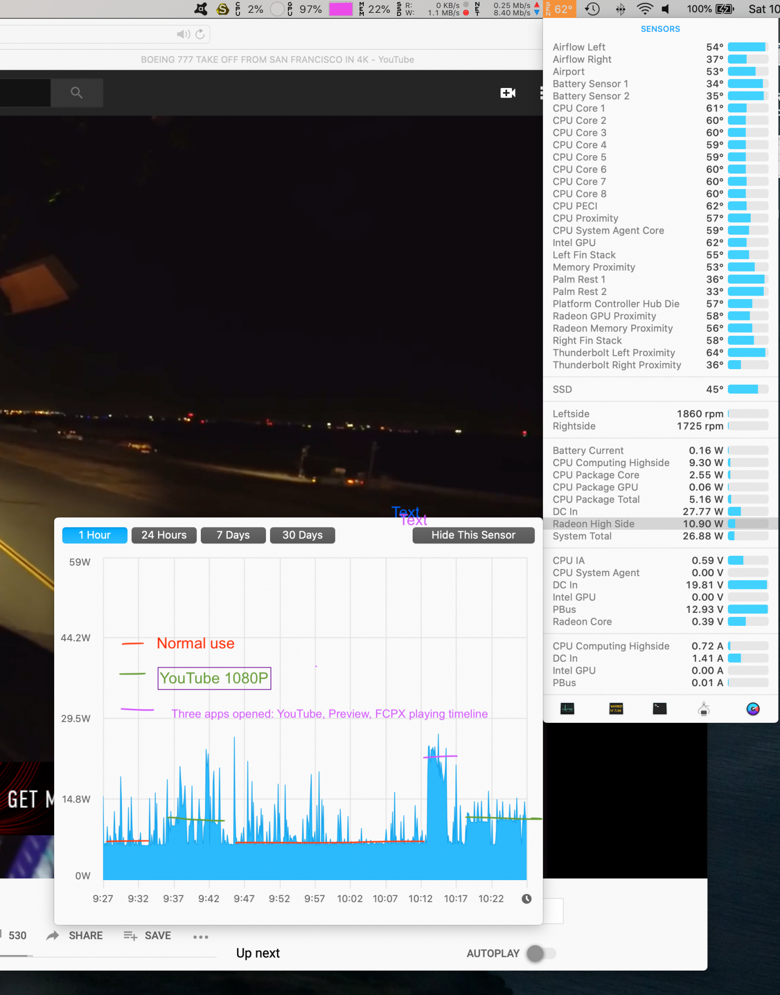

Check the attached screenshot. At 10:00, 30%-50% GPU utilization (idle), the 5500M GPU draws on average under 7 watts.
At 9:35 and 10:20, playing a 1080P YouTube video (seen in the screenshot background), utilization at 97%, the GPU draws about 10 watts.
The GPU hits 20-25 watts at 10:15 only when three apps were opened: Safari with 3 tabs, Preview, and FCPX. The fan noise starts blowing when the FCPX timeline starts playing 4K video.
Under normal use connected to a LG 34" 5K, my MBP GPU consistently draws about 10 watts and the fan can't be heard at all.

Very nice thanks for the info.
You don’t happen to have Logic Pro do you? I’d be very interested to see what Radeon power draw you get with logic running on your monitor.

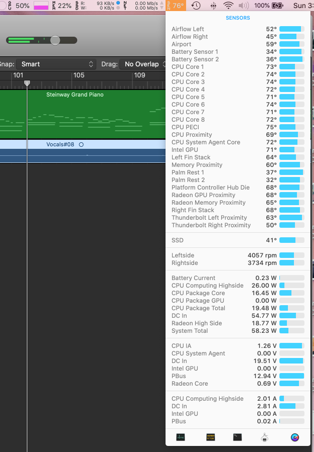

I have Logic Pro but rarely use it. Here are numbers and graphs for you...
Two tracks playback -- the fan noise can be heard after a minute of playback. It's not at full blast but can hear it from 4 feet away. You can see the temp at 76°C, fan speed at 4057 rpm, and Radeon power draw at 18.77 watts.

4 Tracks -- not much different here:

Wow thanks again for your data!
So it looks like you have the same issue I do with Logic
I did a little testing this morning and tried running logic in clamshell on a 1080 monitor with an hdmi-usbc adapter. What is interesting is that I can actually get Radeon to pull only around 7 watts on this particular monitor when in clamshell. The fans got up to around 3k rpm after about 10 minutes of playback. Still not satisfactory for me when I can playback for hours on the built in monitor with integrated graphics and they never break 2k rpm.
if I try to run both monitors, it’s 18-25 watts. If I try to run the built in monitor with the Radeon active, same - 18-25 watts.
So for me the solution must be either disabled Radeon with no external, or 1080 external in clamshell.
It’s annoying but it’s workable.
