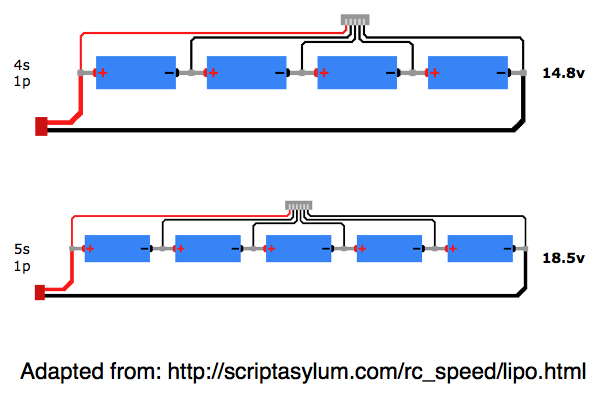

Now I have a question for all you battery gurus. The far right cell has expanded and is defective. Can I just take that cell out and use the battery as a 4s battery??

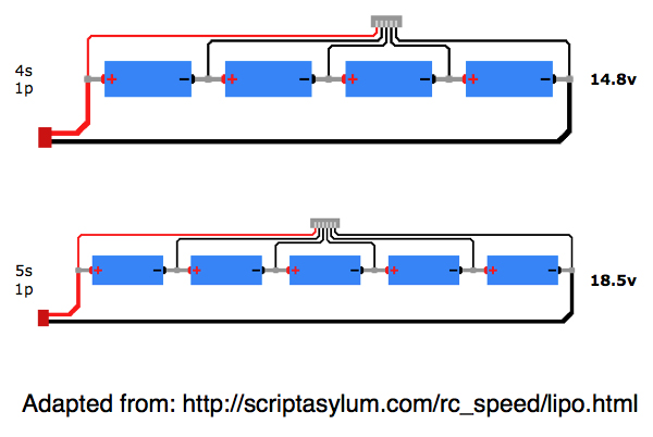

The answer to your question is YES! You will have a 14.8 volt battery instead of an 18.5 volt battery; it will power an MBA but not an MBP. There are some things to be mindful of:
Usually, the cells are arranged physically, 1 thru 5, in the same order as they are electrically, but there is no reason to assume that that is always true; make sure that your wiring is electrically correct, both for the power and the balancing harness.
Balancing harnesses do not have a standard connector or pinout; make sure that yours is wired for your charger or balancer. Check everything before you connect your charger or laptop.
I have included the most common wiring arrangement in the diagram, adapted from: http://scriptasylum.com/rc_speed/lipo.html
