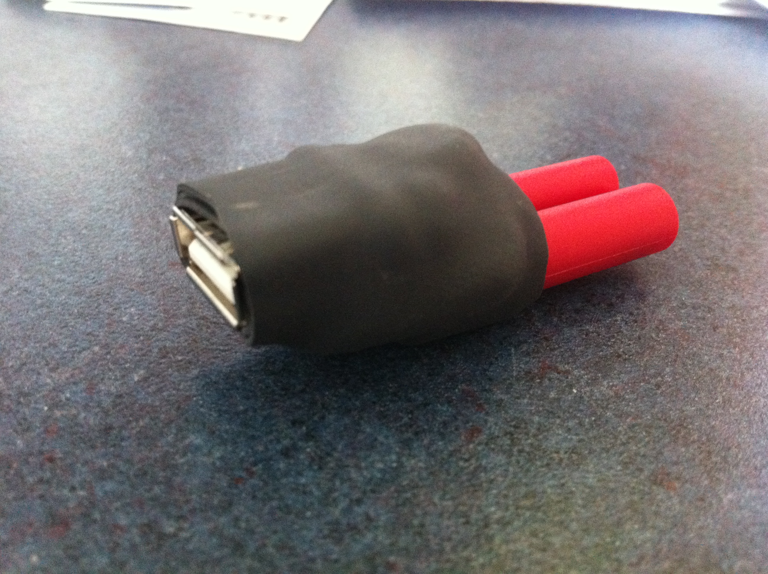

Here is the usb charger that I made on my lunch at work today. I used this mini car charger, gutted it, hooked it up to some bullet connectors and put a few layers of shrink wrap around it. I have yet to test it since I left my battery at home but will as soon as I'm off. I sure hope it works!

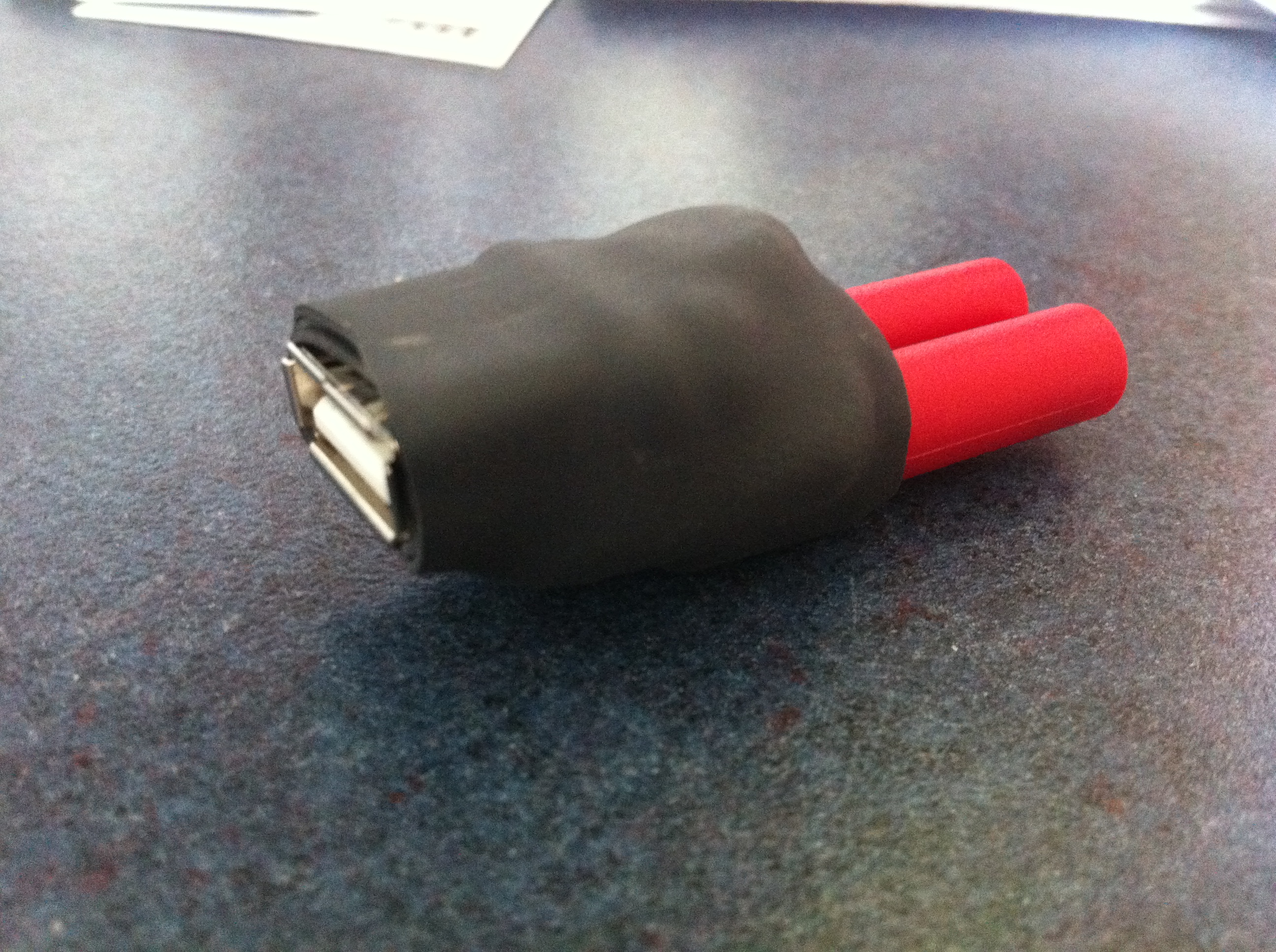

Well I just tested it and for some reason it won't charge my iPad... It will charge it for a little then say not charging on the iPad. It charges my iPhone nicely though.
Edit: I put a voltmeter up to the USB and its only putting out 2.7 volts so I must of done a ****** solder job considering it use to be an iPad charger and put out 5 volts haha. Also it gets a little warm while charging my phone. Oh well it was worth a shot.
Edit x2: Actually I don't even know what I did. I was just reading one of the pins at 2.7 volts. The first pin is still running at 5 volts like a normal iPad charger. All the voltages match up with my normal iPad charger plugged into the wall so I'm not really sure what's wrong. I got my iPad to charge off the battery for about 3 minutes max but it always stops and says not charging eventually.
Edit x3: Turns out it's the cord that wouldn't charge my iPad. When I plugged my iPad into the wall charger it did the same thing!! I tried a different cord and it charges perfectly off the battery!
