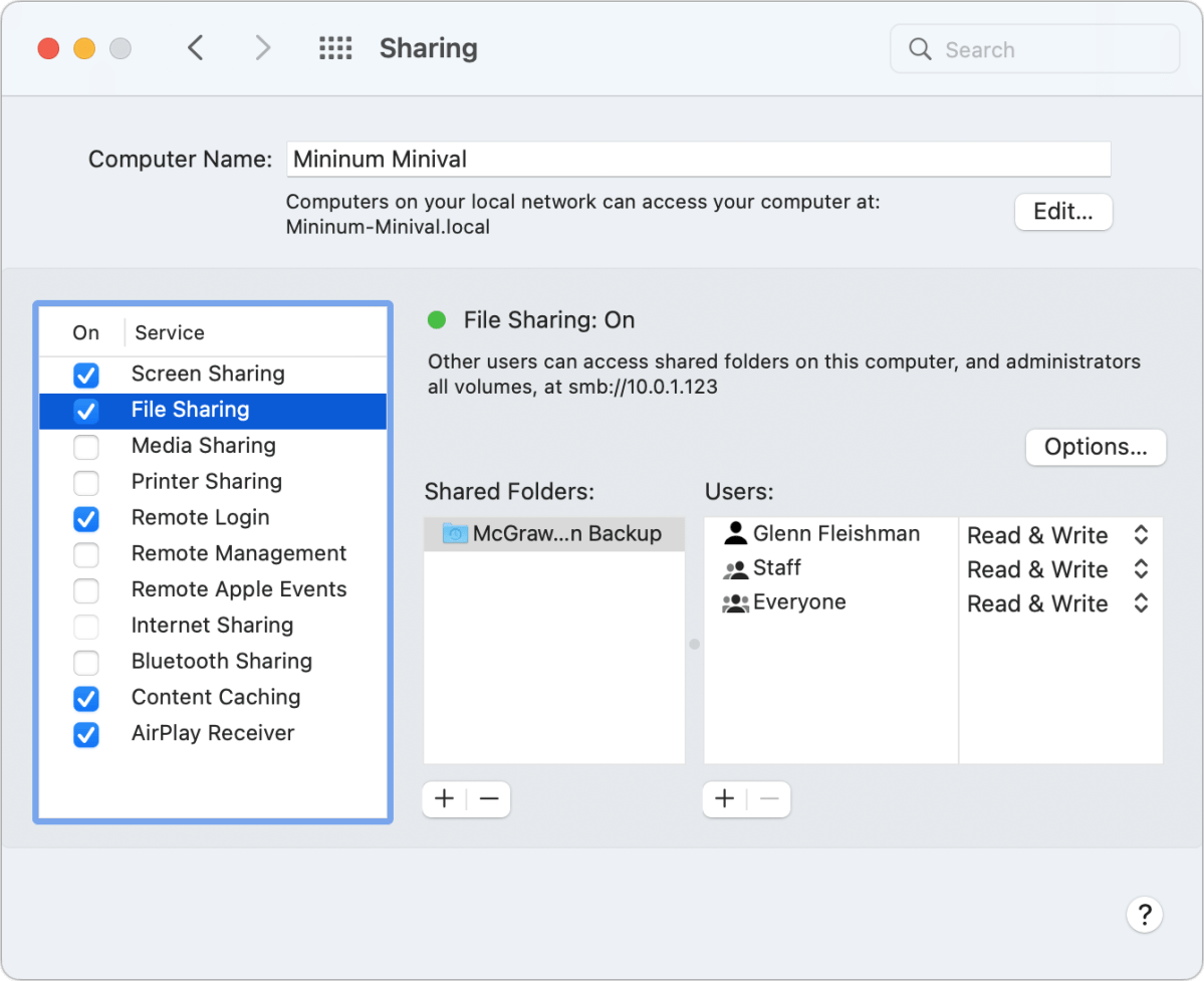

And I found a good example for what I meant earlier in this thread. When the user did not used the space then the message would be
"Other users can access shared folders on this computer, and administrators
all volumes, at smb://minimumminival
Because it's only 15 characters long with fits the specifications.

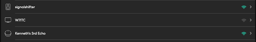

Talk about feeling like an idiot. Finally called EERO Support, and they fixed me up. The Mac Studio has paired WiFi and hard-wired Ethernet. Once the tech had me check the status of the Mac on the EERO, in the Mac's profile, you would see the WiFi connection. I turned off the WiFi connection on the Mac, and that fixed it. Apparently, with the update to macOS 26, something changed that caused the problem.
The Mac is named W7ITC. Now, everything WiFi is going through the EERO router.
