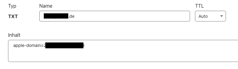

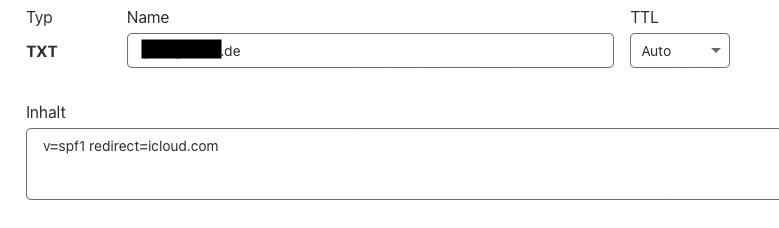

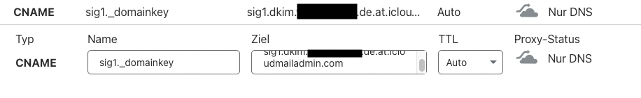

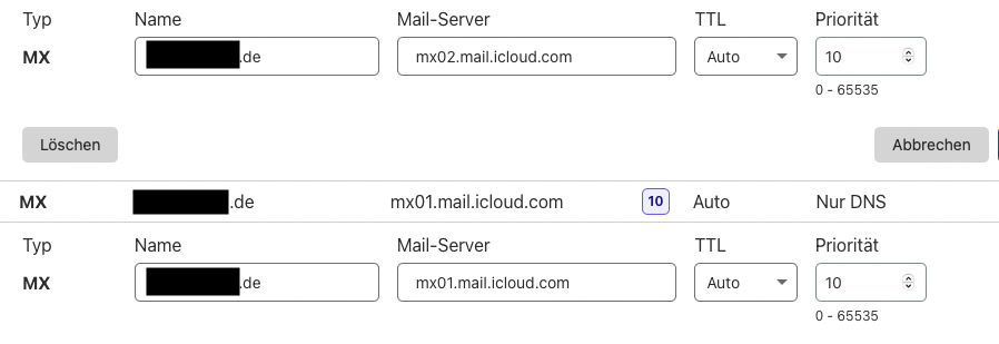

Cloudflare has to look like this.
1.) MX records
2.) SPF (which is a TXT record)
3.) DKIM (which is a CNAME record)
4.) And finally the validation TXT record
You don't need dots at the end.
And very important: Always choose "Only DNS". If you have orange clouds somewhere in these records then you're doing something wrong. (Only enable Cloudflare for your other stuff where you know you want it, like your website server.)
Also make sure you don't have any other MX records other than the two for your domain, and also no other TXT records for SPF. It's fine to have other records for DKIM, you don't need to delete them right away.

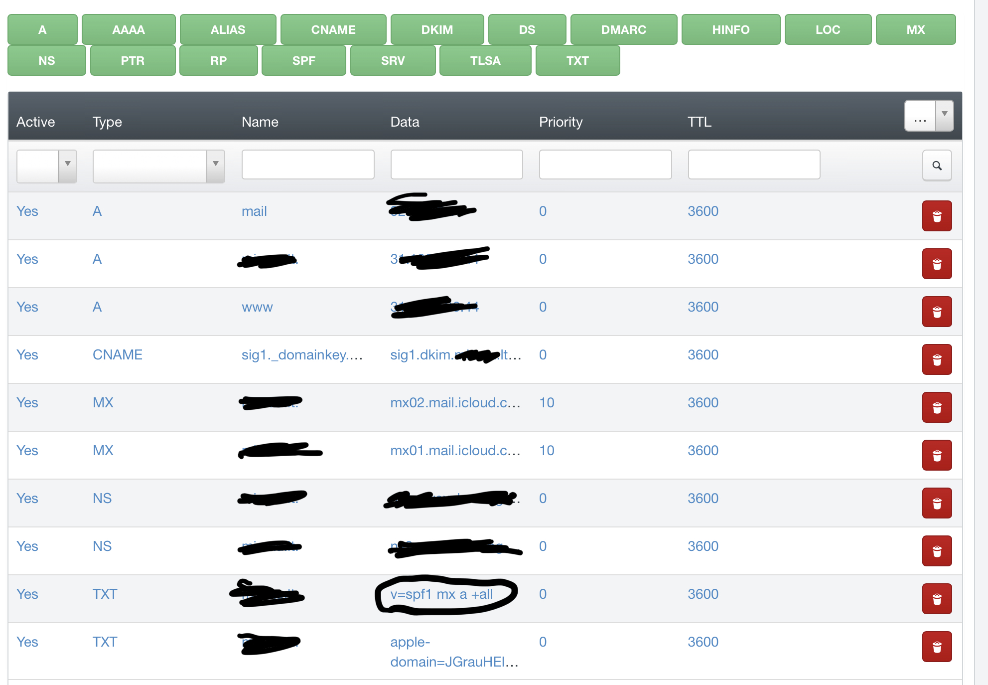

Would someone who uses Google Domains be kind enough to post a screenshot of their DNS settings?
My outgoing mail works, but incoming mail fails. And I can't for the life of me figure out what I entered wrong. 😩

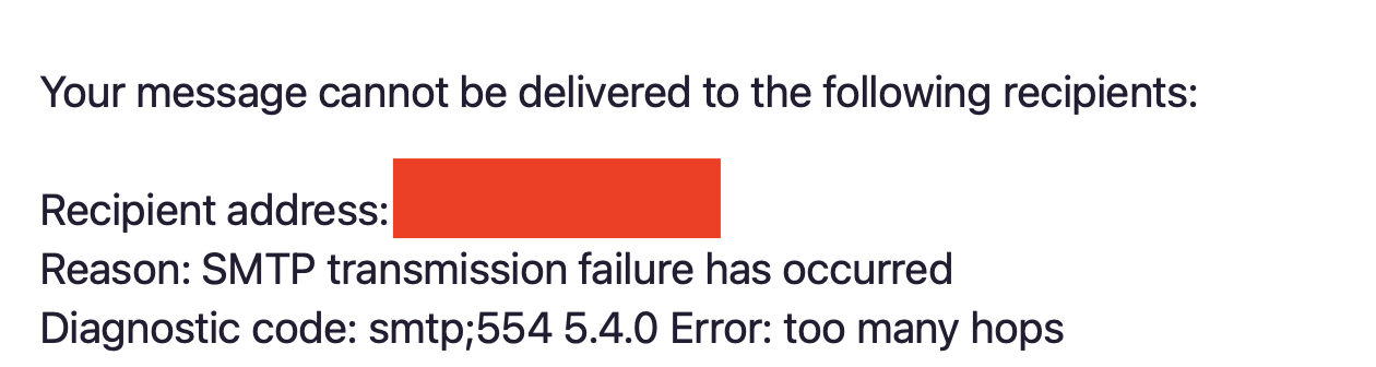

I've completed the custom domains setup, can send email from my custom domain, but getting the too many hops error when trying to send email to the custom domain. Did anyone get to the bottom of this issue?
Your message cannot be delivered to the following recipients:
Recipient address: email@mydomain.com
Reason: SMTP transmission failure has occurred
Diagnostic code: smtp;554 5.4.0 Error: too many hops
Remote system: dns;smtpout.mac.com (TCP|172|54985|) (iCloud SMTP - pv50p00im-ztbu10011701.me.com 3.5.0 [2a])

Thanks. It was the proxy setting for DKIM.

Can someone help me to point out what I did wrong? For an unknown reason I can’t add v=spf1 redirect=icloud.com directly as a TXT record, it says I have to setup SPF, but I see nowhere a place to add this record to SPF. Any clue?
