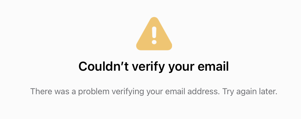

I have one of my "business" domains working perfectly. But, am having a problem with the second one. Years ago, it was used for a short time as an Apple ID. I've gone through the process to get it deleted, and it's gone and I cannot login as an Apple ID at all. However, when I try to add that address (ken@mydomain.com), I get the inbound verification email with a link on it, tap on that link and get this ...
I tried skipping this address verification and I can setup the domain. But, when I try to add this address (ken@mydomain.com) it fails with a similar error.
Anyone have an idea how to resolve this or perhaps report it to Apple for assistance?

I have one of my "business" domains working perfectly. But, am having a problem with the second one. Years ago, it was used for a short time as an Apple ID. I've gone through the process to get it deleted, and it's gone and I cannot login as an Apple ID at all. However, when I try to add that address (ken@mydomain.com), I get the inbound verification email with a link on it, tap on that link and get this ...View attachment 1826203
I rather like the way the other domain is working!!
Ken
I've had the same issues you do since adding my domain the first day it was available. My existing domain email address that was my Apple ID gets the error message from your screenshot when trying to add it. Changing my Apple ID did nothing. I wanted to use this so much I registered the .net version of my domain and it gets the error message of "There was a problem adding this email address. Try again later." The .net version was clearly never associated with my Apple ID so I'm at a loss of what else to try. I don't understand how this worked so easily for most people and others get nothing but various error messages. I did report the issues through Feedback Assistant. It now shows more than 10 similar reports so maybe it will get fixed eventually. I worry that those of us with issues will just be stuck with not being able to use the service.

It looks like I can add my Apple ID (which is on my custom domain) with no issues, but on a few secondary domains that I've used as temporary Apple IDs in the past, I get the "There was a problem with adding this email address. Please try again later." message. I've tried this with a few addresses, and each Apple ID in question has either been closed down (properly, using the procedure on the website), or moved to a different email address.
I'm observing the same behaviour as others; if the address has somehow been linked to an Apple ID in the past, you can't add it. This doesn't seem to cause a problem for your current Apple ID though.

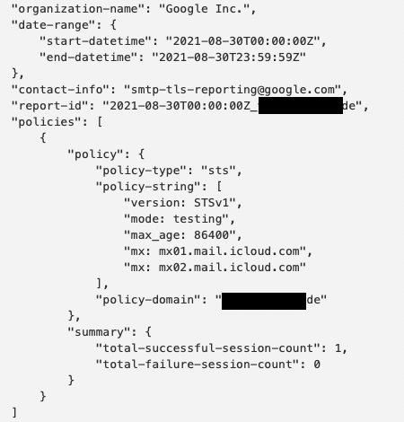

Oh and DMARC, well you don't need it of course. But you can set it up however you like. Why not? Always good to get some reports. I have also set up MTA-STS and SMTP TLS reporting (in testing mode for now). Also works fine.
