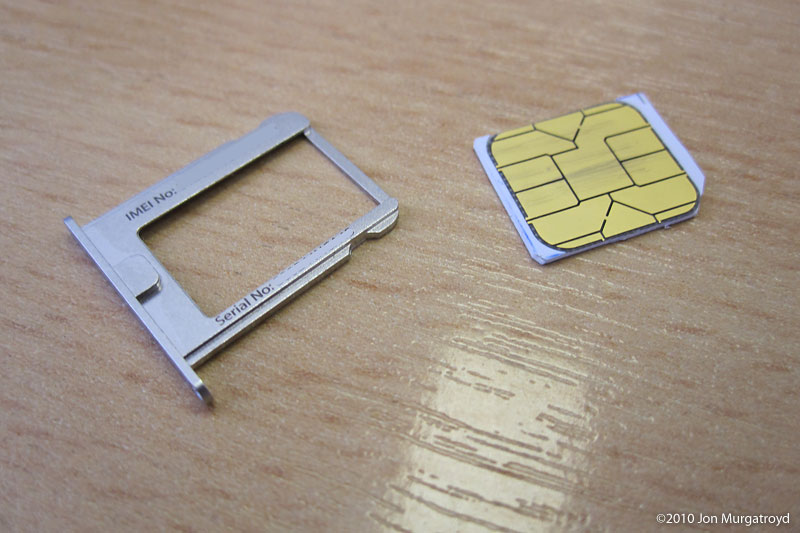

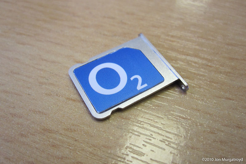

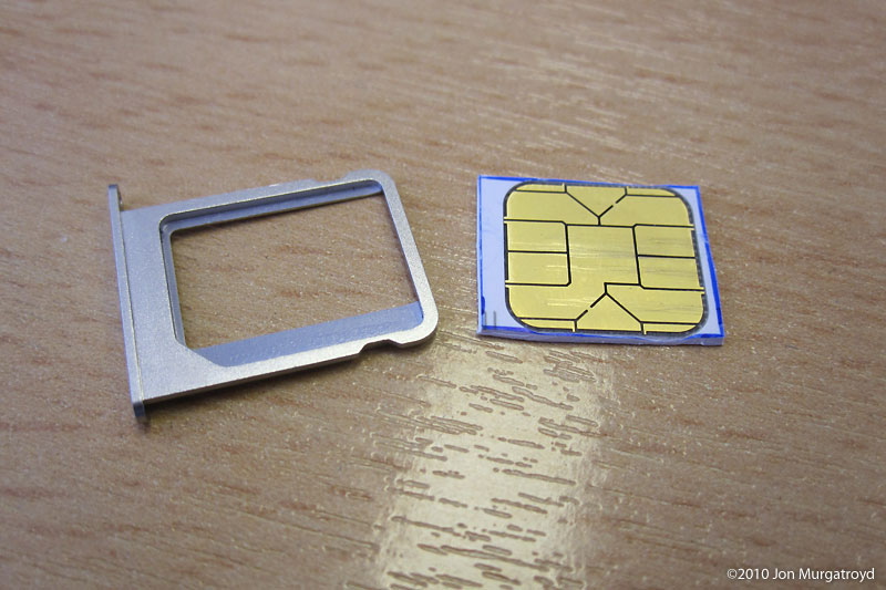

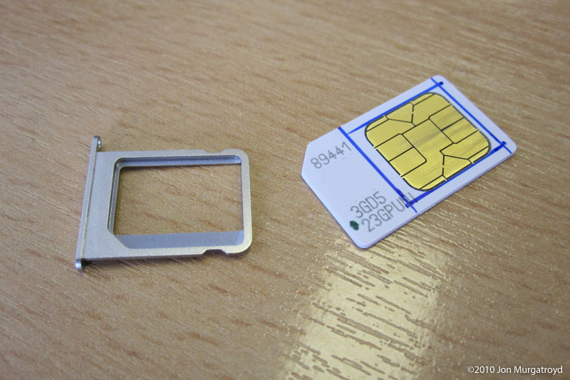

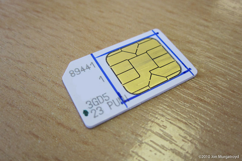

Cut my O2 sim down this morning when the iP4 arrived (8:58am)... easy as you like and here are some pics:
I cut it with sharp scissors and went a bit bigger at first then trimmed it down with a few trial fits to ensure it was spot on. Slotted it in the phone and all working fine 🙂
I accidentally cut mine a hair too small so if I wobble it in the SIM tray the card falls out, but I quickly stuck it in the phone and it is working fine. The contacts in the phone that touch the gold colored connectors on the sim apply pressure to the card and hold it in place.
