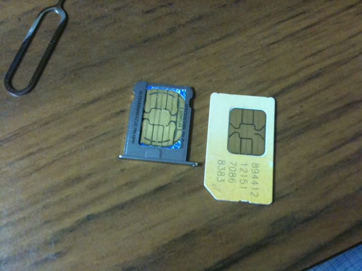

One think i've noticed is that if you ask for a replacement normal sized sim the gold contact area is much smaller, which makes cutting it very easy. My contract t mobile sim was like your o2 one, but when a replacement one came it was much smaller.
So you would think!!
As it is a smaller contact area you cannot use a micro sim as a template as the contacts are in different places. I cut around a micro sim, put it in the iphone 4 sim tray only to find that the contacts were 1/4 covered on the one size. Had to cut more off the one side and jam it in the opposite side. Think i'll get a replacement micro sim when T-mobile get their asses in gear

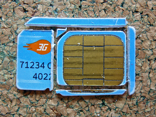

T Mobile are useless so I planned to cut my sim card. Had some T Mobile PAYG ones to try it out on. The issue I had was my contract t mobile simcard was 2 years old and had a large contact area compared to the newer simcards. So it wasn't as straight forward compared to the PAYG ones which have a smaller contact area.
But its been successfully cut and is working fine with my iphone 4 :)

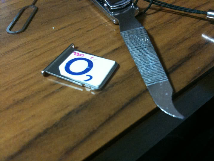

Got my iphone 4 yday after queuing in line at Apple for 6 hrs. (Yes I had a reservation)
A few ciders later and i have hacked my t-mobile sim card down to a micro one. Its not the best cut put it works perfectly.
I'm on an old monthly rolling contract and the Gold contact parts of the sim were bigger but had seen some articles on which parts of the contacts you could trim off without damaging the sim.
Happy days

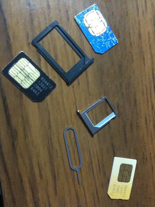

I trimmed my ATT microsim...
When I purchased my iPhone 4 yesterday I wanted to use a discount from another line. They activated it in store with that number. As soon as I got home I called ATT to transfer the number. Thy said no prob but when they found I had the microsim activated on another number they told me I would have to buy a new microsim. That's $24.99! So I just overlaid the old aim to match up the metal contact "plate" and marked around and trimmed with a sharp pair of scissors. It worked perfectly fine! Now I have to go into an ATT store to have the new iphone plan removed from that other line and deactivate the original phone that was on the line to begin with. I'm bopping they don't give me any grief just because I found a work around their $24.99 charge!

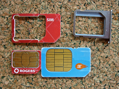

I cut my AT&T sim card down and sadly it doesn't work now. :(
Do you think it was because I cut into the three metal contacts on the bottom of the card? The microSIM that I have from Rogers doesn't seem to have the top or bottom contacts...
Also I'm a bit confused about the adapter.. if you have to cut a regular SIM down to make it small to fit in iphone then whats point of adapter making it longer again?
That's so you can take the micro-SIM and use it in another phone that takes regular mini-SIMs. For instance, if your iPhone isn't working and you need to borrow someone else's non-iPhone.
