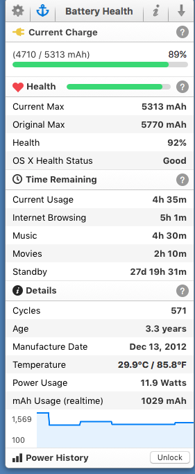

Check the status of the battery in "About this Mac". If it says "Needs service", then the machine is likely running at 1/2 speed, to ensure it does not raw more power, than the adapter can provided directly.

Can you please send a screen shot of what you mean. I don't see what you are talking about in "About this Mac". I haven't used my MBP for a long time so I am really bad at finding my way around to different things.

To do a quick check on the battery condition, press the Option key, then click on the battery icon in the upper right, left of the date/time (if your preference is set to show that). You can check on the cycle count by going through the steps in: https://support.apple.com/en-us/HT201585
(What is done in this link is what is suggested in post #8 except they get there by a slightly different route.)

I just took a screen shot of what I think you might find useful, if not, please tell me and I'll try it again doing something different. As I said before, it has been a very long time since I touched my MBP. I will have to get used to doing certain things again.
Here's a screen shot of what I think you need:
Your battery is fine. You're about 57% through the expected charging cycles of the battery.
Basically, if the condition is "Needs replacement", then the MBP will be running at 1/2 speed to prevent overtaxing the energy drawn from the power cord alone.

Battery Information:
Model Information:
Serial Number: 9G2500WBZD3MB
Manufacturer: DP
Device Name: bq20z451
Pack Lot Code: 0
PCB Lot Code: 0
Firmware Version: 201
Hardware Revision: 2
Cell Revision: 158
Charge Information:
Charge Remaining (mAh): 3259
Fully Charged: No
Charging: No
Full Charge Capacity (mAh): 5315
Health Information:
Cycle Count: 572
Condition: Normal
Battery Installed: Yes
Amperage (mA): -1011
Voltage (mV): 11464
