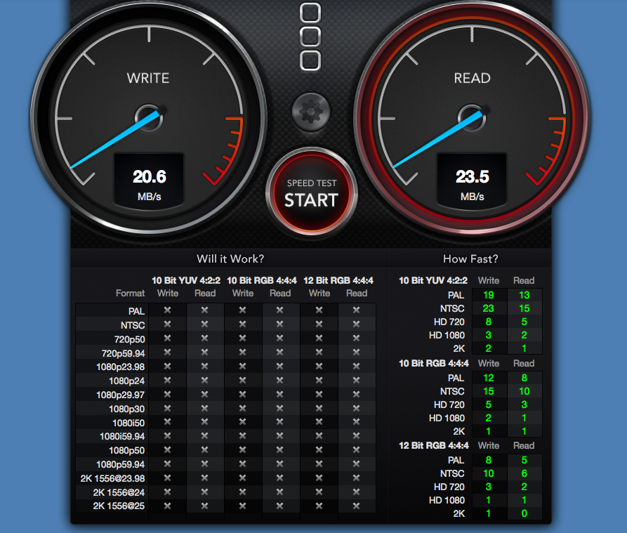

Will this be helpful....
Those results don't look good. My 2011 Mac Mini (5400 rpm drive) was between 30mb/s and 60mb/s back in October before I changed it for an SSD. Yours in a 2012 device are only 20mb/s.

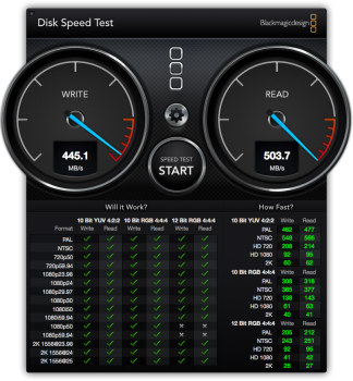

When I put the SSD in, I got between 450mb/s and 500mb/s. Here's a test I just did. SSD really makes a difference... I had planned to replace the computer, but now know I'll get several more years out of it.
As others have mentioned and comparing it to the different drives that have come with my Macs (post #27), your drive is abnormally slow and as mentioned earlier, could be a symptom of a failing drive. A new 7200rpm HDD will be about 4.5-5X faster than what you have, a SSD would be about 5X faster than a normal HDD. Let us know what the memory statistics are. It sounds like you would like to have someone else do any possible work opening up your computer. It would save money if you could do both drive and memory at the same time if you need more memory. Memory is not that expensive and could explain the sluggish response with Safari.

The difference between the two is the technology used to store that data. A hard drive uses magnetic platters and a reading head, in the same way a CD uses a plastic disk and a laser, to store data. That tech is decades old and is pretty much at the peak of how fast we can make it go. We can't make the platters spin any faster or they'll vibrate and wreak havoc, and we can't make the reading head move any faster either. So about (I'm just trying to make the numbers look pretty here) 100 MB/s in read and write speed is pretty much the max you can expect. The 20/20 we're seeing in your test indicate either a hard drive that is way too full, or one that is dying. Keep a good backup handy, it's likely the latter, if you don't and it crashes, you've lost everything, for good.

I can see how Cleanmymac can help but it's kind of like treating the symptoms of your problem. Your HDD, which may or may not be on it's way to hard drive heaven, is really slow. It's possible that the Blackmagic test results will improve if some files have been removed - that's something you can check out.
I'm not sure I did the black magic test right..... I ran the Black Magic Speed test, and I posted the results earlier. The internet seems fine and loads a bit faster than what it did before my MBP stopped working.
Running the Blackmagic test is pretty straightforward and I'm pretty sure that the results you got earlier are valid. I was suggesting to run it again to see if the numbers are higher after running Cleanmymac.
I meant that the black magic test never settled... Does it settle?
