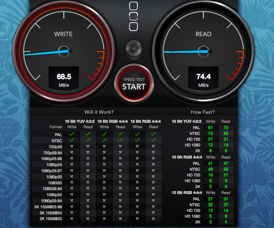

I ran the black magic test again after cleaning out things with CleanMyMac3 and Macbooster3. Things aren't perfect but they seem a little better. I know I am going to get the new drive someday, but when is the answer.... I want to make sure I have someone who knows a things or two about quality of the product. I have seen a few nice SSD's.
That latest Blackmagic results show your disk running at the speed I would expect it to - it's much better than the earlier results you had. The original 1TB HDD in my 2012 Mini (I have both an SSD and HDD) runs at about the same speed. I haven't read much of the huge thread on SSD's but what I find is that once the SSD is up and running, there doesn't seem to be much difference between the name-brand SSD's in terms of longevity. Part of that is the SSD use is still relatively new so the jury's still out. However, Samsung offers the longest warranties. There are big differences in performances between different models but it's not clear how much the user will notice these in everyday use. If you're willing to spend the money for a Samsung 850 Evo, that's the product you should get. If want to save some money, there are trade-offs in cost, performance and warranty. For my 2012 MBP, I got a couple of 250GB 850 Evo's back in December when they were about $15 cheaper than they are now. Recently, I bought a 480GB Crucial/Micron M500 for a Mini I use as a DVR which was about $45 cheaper than an 850 Evo would have been. The M500 isn't a current model and the warranty comes from the seller, not Crucial. As I said - tradeoffs.
