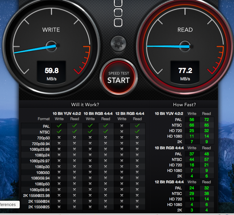

My latest black magic disk speed test, to me, things look a lot better. :)

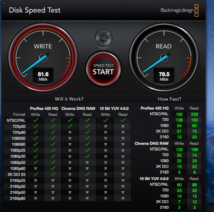

I just ran the black magic screen test again just to see if the numbers got better, as you can see, they are better, but can you all explain what the items marked with an x means? I am extremely pleased things have turned around and that I can save a little extra money to get a really nice MBA when the time comes. (I currently have a mid-2012 MBP and this is the first big problem I have had with it.)
The only thing that I have noticed that my leg did get pretty toasty for a few minutes every now and then (the spot would be located on the upper right hand side of the bottom of my MBP, but overall, things are excellent. I have dealt with tech support two times in the past few months and I have to say they are far more knowledgeable and helpful than other companies I have dealt with.
It means whether or not your disk supports that video format.
If you launch the program and go to the Help menu and select 'Disk Speed Test Help' it will open the manual and will have the information in more detail.
I see you've been spending a lot of time diagnosing your machine! You're getting all of the life of that hard drive!

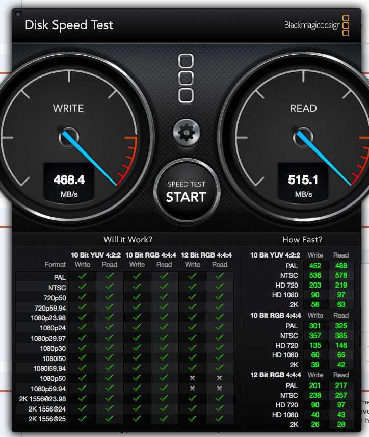

Here's what your machine would look like with an SSD,

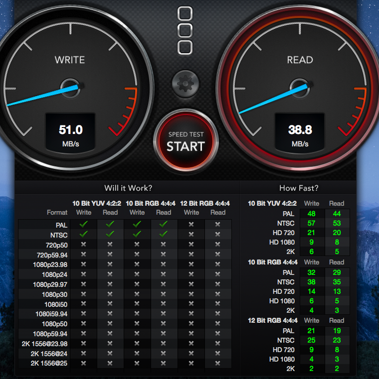

Does this sound like an HDD problem? Will the green checkmarks continue to change into white "x"s? If they all do, will my MBP turn into a metallic paperweight?
Those stats look fine. Don't worry about the checkmarks. That stuff is important for people who work with video
I was talking about the white x's, I assumed the green checkmarks were good.

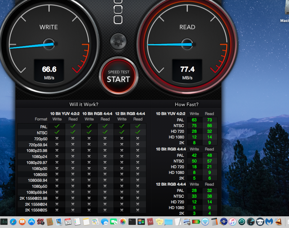

The presence of checkmarks and the numbers are improving. I just ran the black magic speed test again today, but chose not to post the results. I have no idea what this means, I have also noticed a drop in situations where I want to use a certain app on the dock and it's not listed as "not responding". I'm going to assume that iTunes is back to being normal again, too. (I'll check that later.)

I've had this reading for the past few days.... If I understand what this mean right, I am surprised my MBP still runs. Up until a few day ago, I was able to get some sort of color coded strip of what took up space on the HDD.

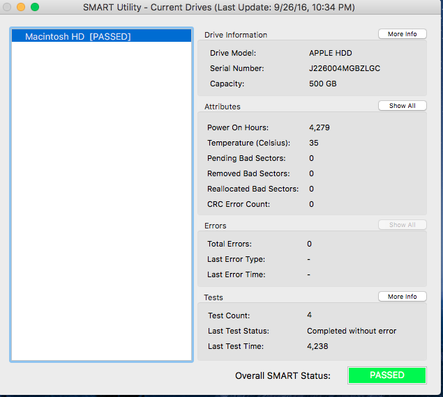

Those checkmarks are not for diagnostic purposes. Blackmagic is a company that produces medium to high end video production equipment for studios, and Blackmagic Disk Speed Test is intended for professionals that want to determine whether their internal disk is fast enough to record a type of video without frame drops or performance issues. So a MacBook Pro with a standard hard drive (non-SSD) will always have grey or red "X"s on most of the boxes, because the drives in those machines simply aren't fast enough even when they are working perfectly.
That said the Hard Drive Cable in the MacBook Pro (13-inch Mid 2012) is notoriously unreliable and can cause all kinds of performance issues. Sometimes it works fine, sometimes it slows down, sometimes the drive won't mount or detect, sometimes the computer won't boot. As a matter of fact Apple has an active quality program for defective drive cables. I replace about 10-20 a week, and for some that would be considered low volume. It's extremely common.
The drive could also be failing. Not unheard of by any means.
Knowing these machines, I typically run SMART Utility over the drives. ( https://www.volitans-software.com/apps/smart-utility/ ) If SMART Utility shows "PASSED" next to the drive name, then there is a good chance the drive is fine, and I replace the hard drive cable. If it shows "FAILING" or "FAILED", then I replace both the drive and the drive cable at once to resolve the issue.
