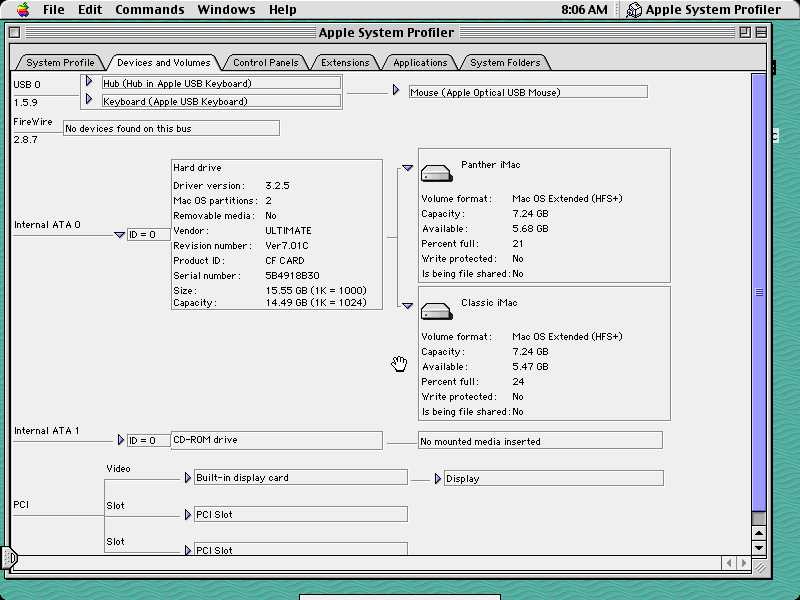

Here's a screenshot of the Bondi's System Profiler/Devices and Volumes:
EDIT:
In case anyone is wondering about the two PCI Slot listings in the System Profiler screenshot,
1) Original "hidden mezzanine" slot which has the iMac VooDoo card (8MB VRAM)
2) Sonnet upgraded logicboard's single Firewire port
Also the Internal ATA 0 listing has Panther iMac formated as Mac OS Extended (HFS+)
But when booted in Panther, the System Profiler lists File System: Journaled HFS+
