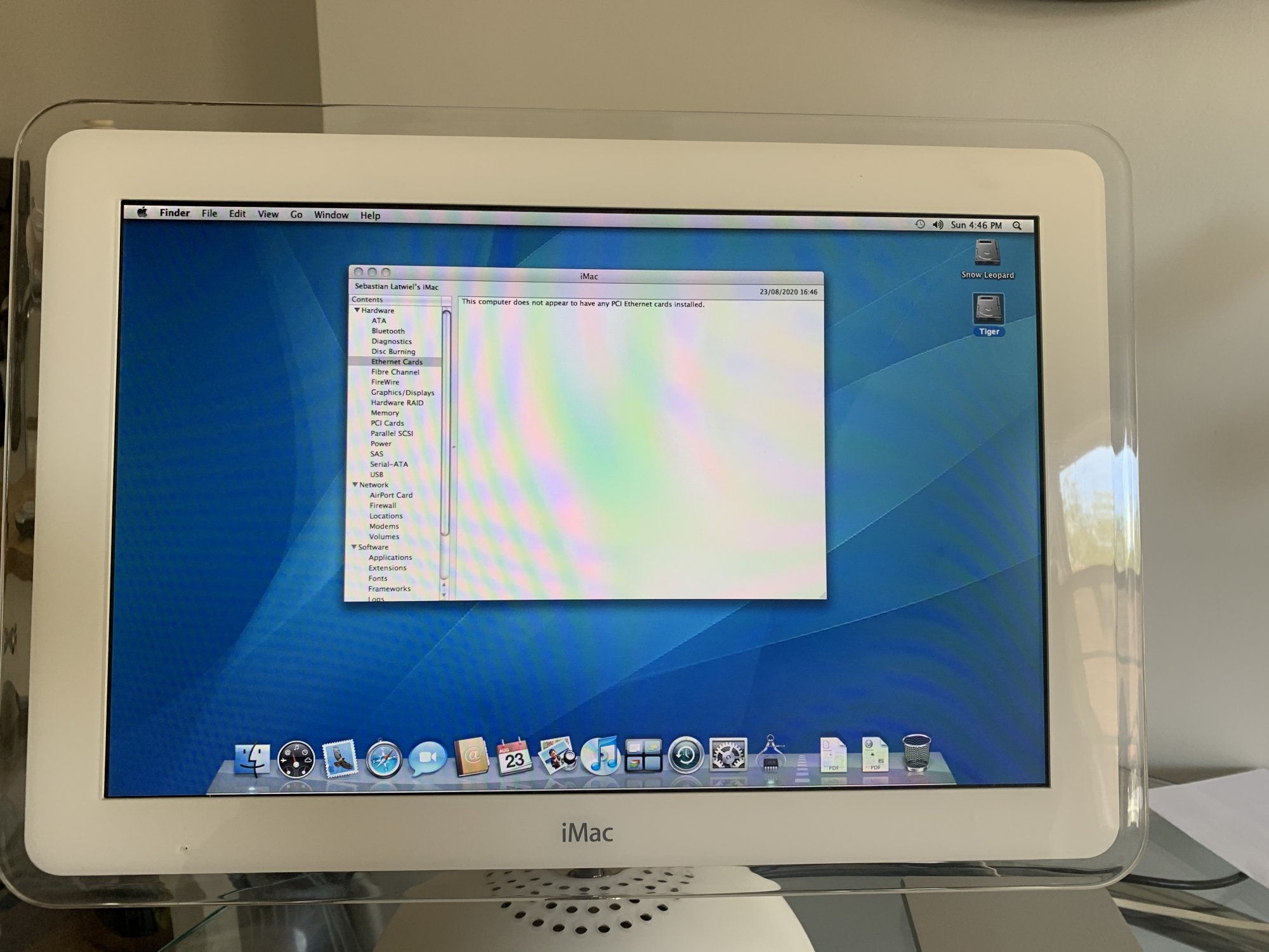

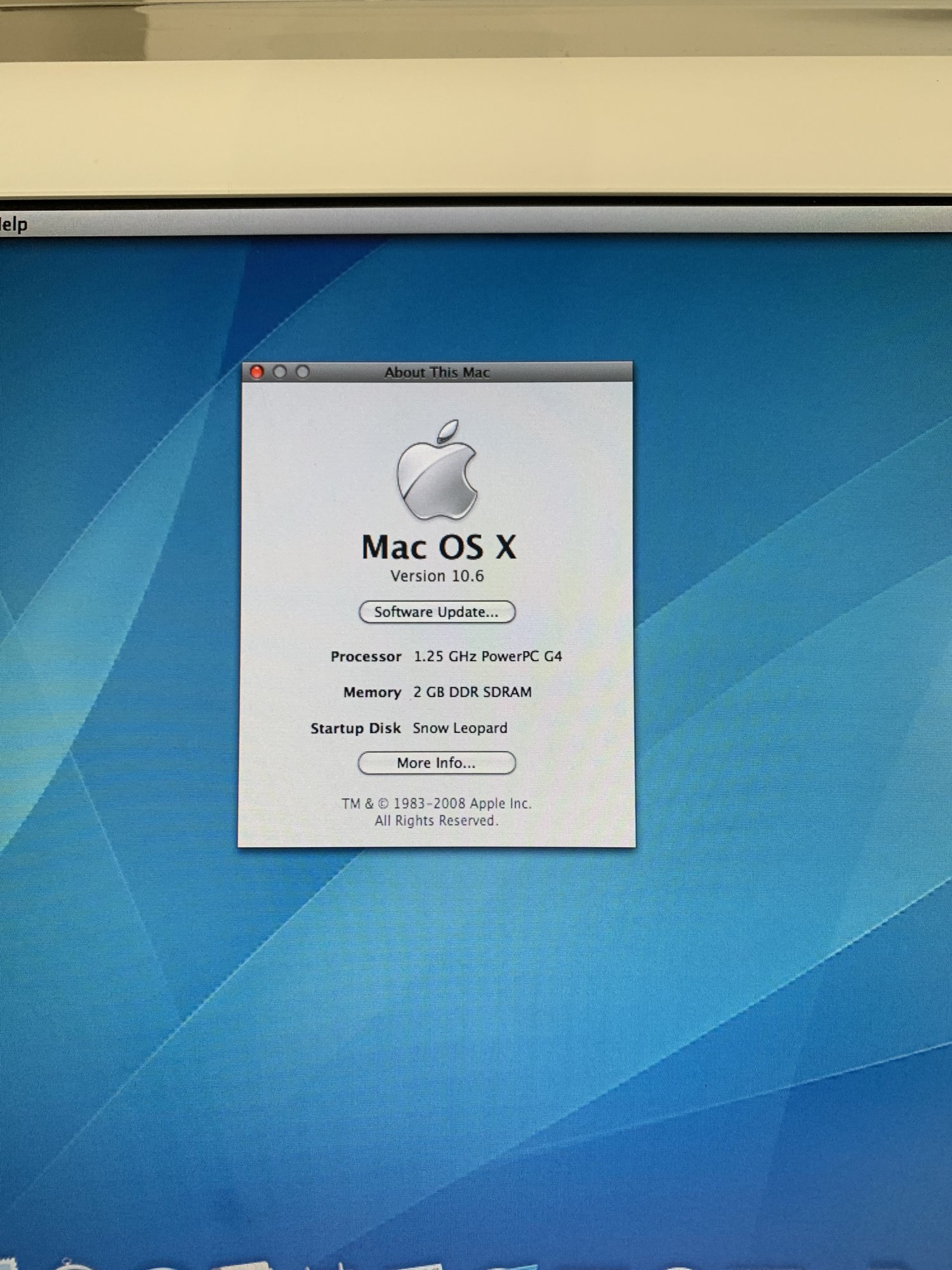

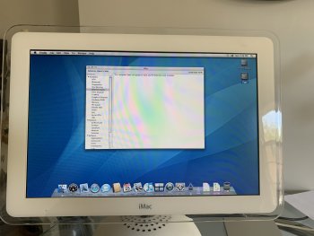

So I’m currently downloading the snow leopard ppc os that leaked earlier this year - I remember installing it on my intel at the time and thinking it was so much faster than leopard - I’m hoping to see the same benefits this afternoon if I manage to get it installed
Oh no, it’s worse than leopard 🙃🤓😭
graphics performance is flakey, many random glitches for me within the first few minutes - also desktop wallpapers are being displayed at a lower blocky resolution (perhaps not clear in the photo)

Have a look at this thread - there might be workarounds for some of the issues. No graphics acceleration is brutal though.

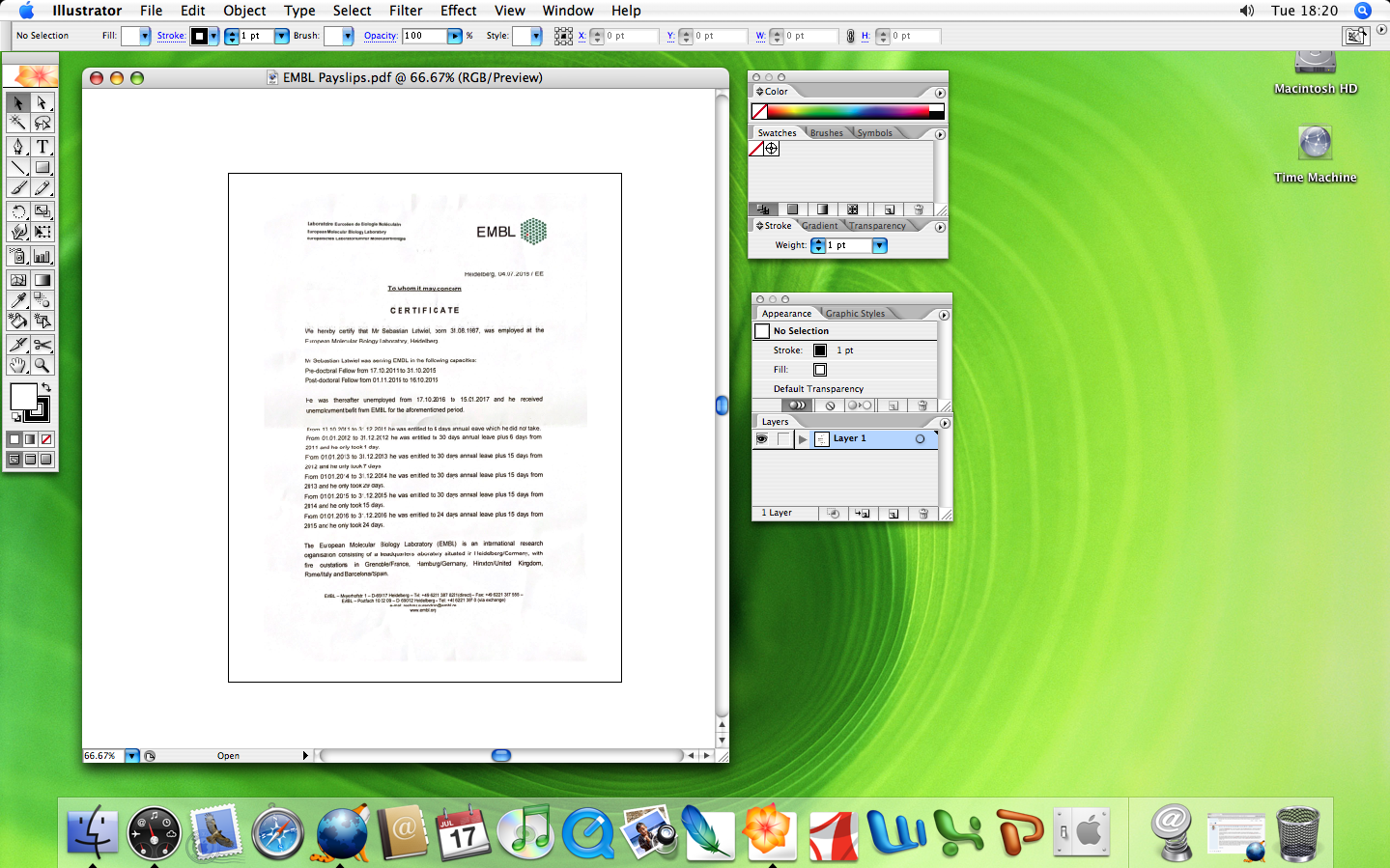

Today I had some long overdue work that needed doing, so I decided to dig out my old Photoshop CS2 CDs (6 IN TOTAL!!!) to use Illustrator - was surprised at how I managed to complete everything I needed to do. And also realised - Mac OS X used to be full of floating toolbars, particularly Adobe software and Microsoft office software - I loved that style of menu. Now it's all gone, I think it's a real shame - although, I am sure, many people prefer the toolbars to be integrated into the main app window as they are today...sigh...the photo pretty much summarises Mac OS X how I used to remember it 🙂 (although the dock I normally have hidden, was simply present for the family photo 🙂 )
I use my PowerBook G4 to get a little bit of work done with both Pages and also Adobe CS4, which is the last version available for PowerPC Macs, and allows me to make an IDML file of my work I can open at work on Windows running CC2019 and my own Mac Pro running CC2020. You can find CS4 on the Macintosh Garden I think - I do NOT know whether or not you HAVE to be running Leopard to install it though, but I find CS4 to be fairly useful. You can also find Microsoft Office 2008 as well as the myriad of updates available, for a fairly modern Office experience. A lot of people enjoy one of the last versions of LibreOffice made available for PowerPC, too, which is again available on "the Garden".
