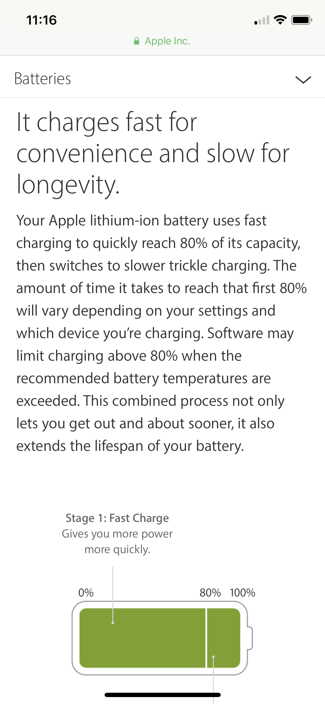

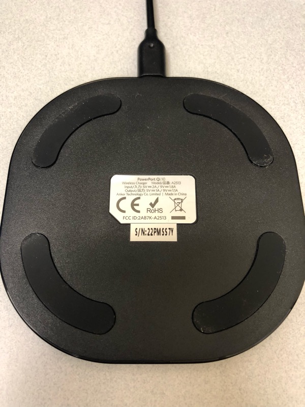

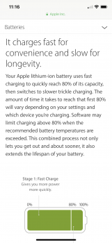

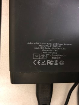

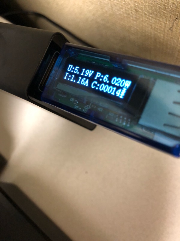

So max I’m seeing with my Anker wireless charger is currently 6w while on 11.2b3. Started the test with battery at 70%. I’m planning to test the RAVPOWER charger tomorrow sometime.
Can you run the test again with the battery at a lower charge level? The charge rate will drop as the device approaches full charge.
If the battery is lower than 50% you may find that the 6W increases to the 7.5W, if the charger supports it.
Gonna be a while but sure, I can do that. I was going off Apple’s description of fast charge being under 80%, which is why I did my test at 70%.

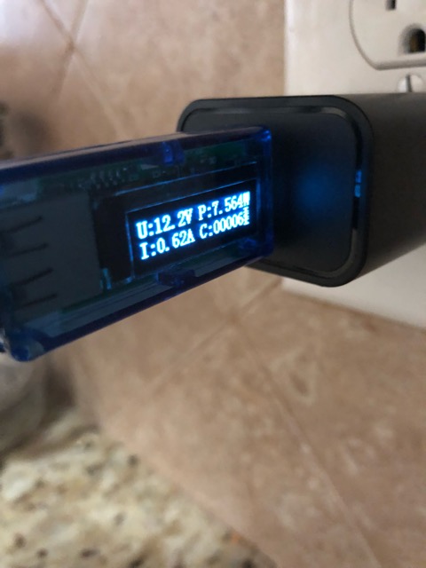

Tested the RAVPOWER and I can confirm that it does fast charge at 7.5w, but only when using the included QC power adapter. The LED on the charger doesn’t flash green to indicate fast charging like the instructions suggest, it only flashes orange. It doesn’t seem to work with my Anker USB hubs or a 12w iPad charger. I caught a deal 2 days ago that made it $34.

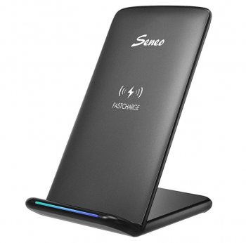

I purchased chargers from Pleson and Seneo that claim to support fast charging. I also briefly had the Mophie which I returned because it was too fickle in terms of placement and working with an Apple case.
I'm curious to determine the various charge outputs for these when using Apple 10W/12W adapters in addition to connecting directly to a MacBook. I'll post my results when I receive the meter.
