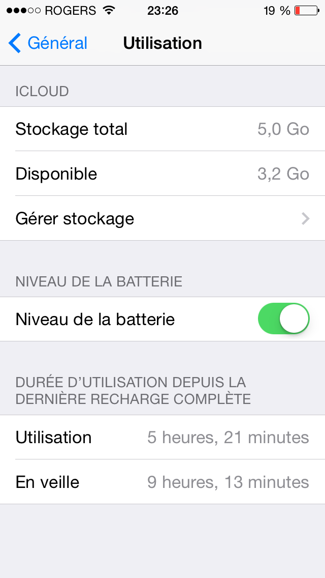

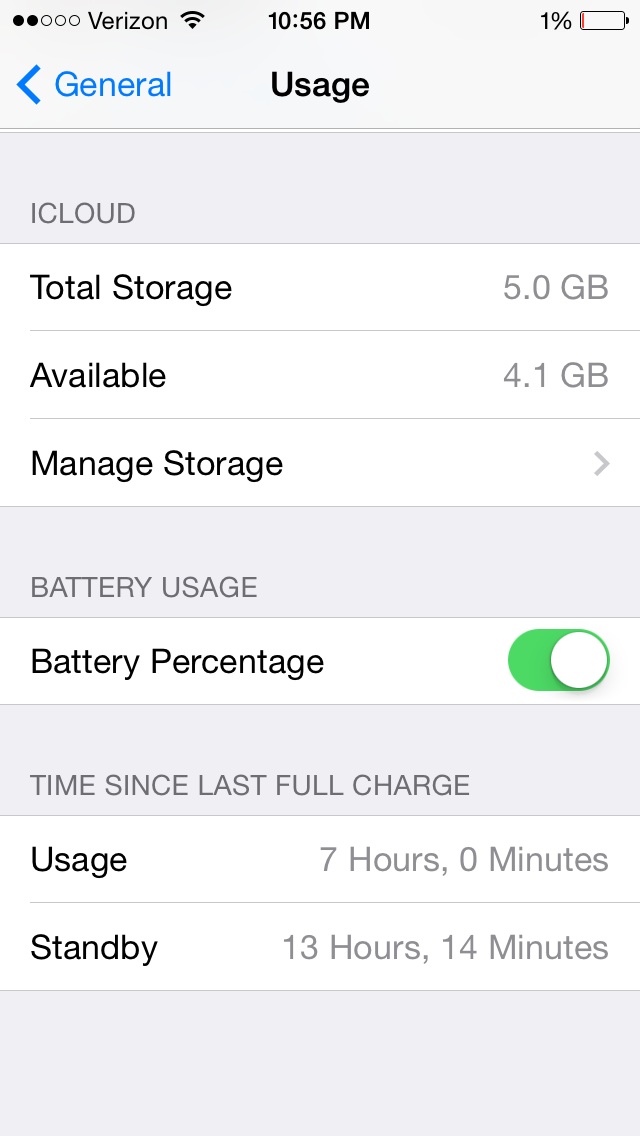

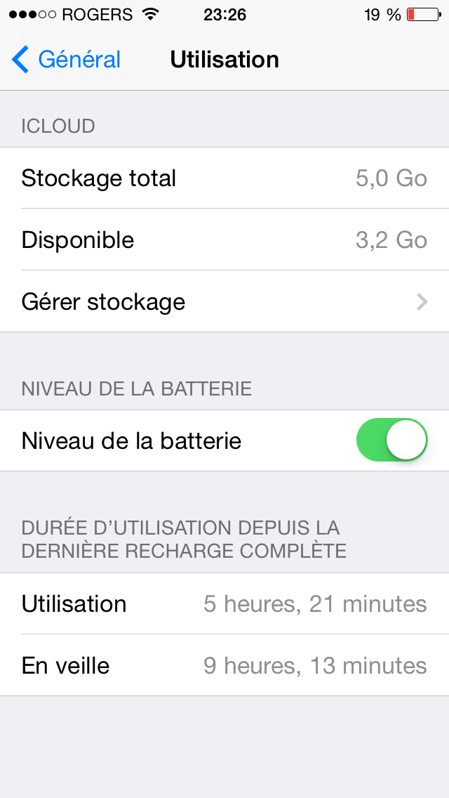

Also, this is what I'm approximately seeing now on an average day with a mix of music/texting/browsing the web on 7.1 on my 5s, seems to be slightly below what I got on 7.0.x:

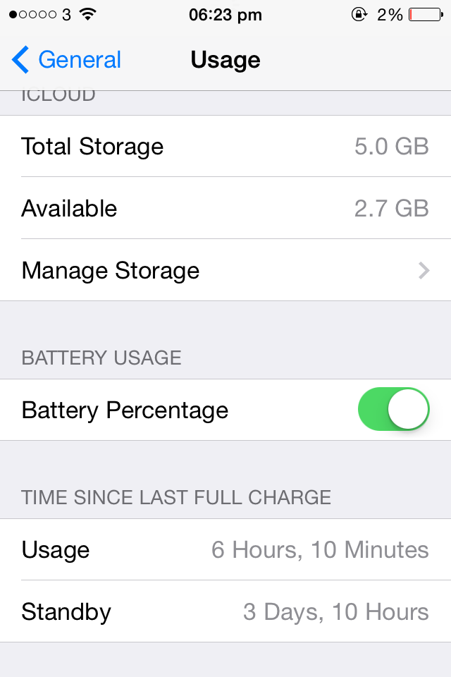

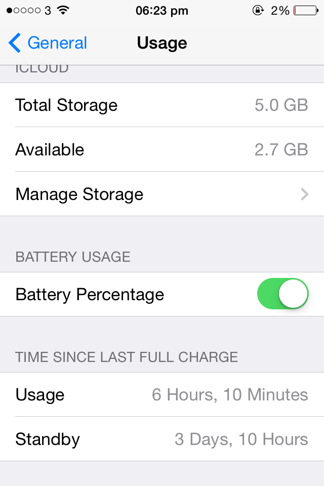

Had 3G data toggled off... sure gives amazing battery life 😛 Been sat on my desk most of the time as I've been doing assignments... but used it for at least 5 hours or so...
