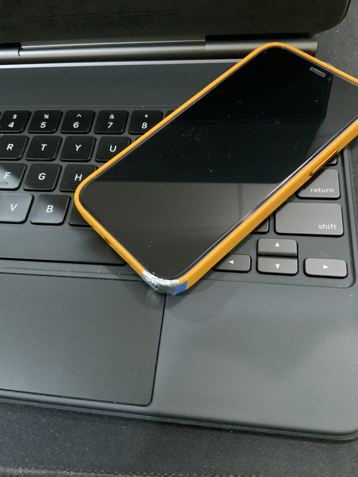

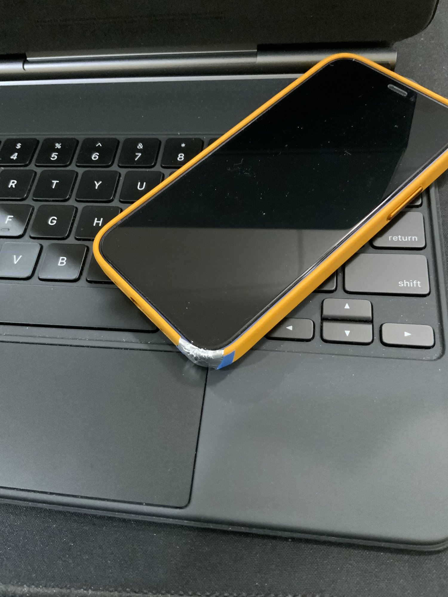

Placing a small piece of tin foil on the bottom side of the case where one of your fingers usually rest works every time, versus the assistive touch gesture toggle, which doesn’t work every time and affects typing. Use a small enough strip of foil where your pinky is, and you won’t even see the foil while holding the case.

I took off the ESR full screen and tried the Spigen notch. Didn’t make a difference in Apple case of Spigen Ultra Hybrid. I then applied iCarez full screen privacy and put the Apple Poppy back on with the aluminum on the bottom right corner of the case, and swiping etc., works again as it should.
